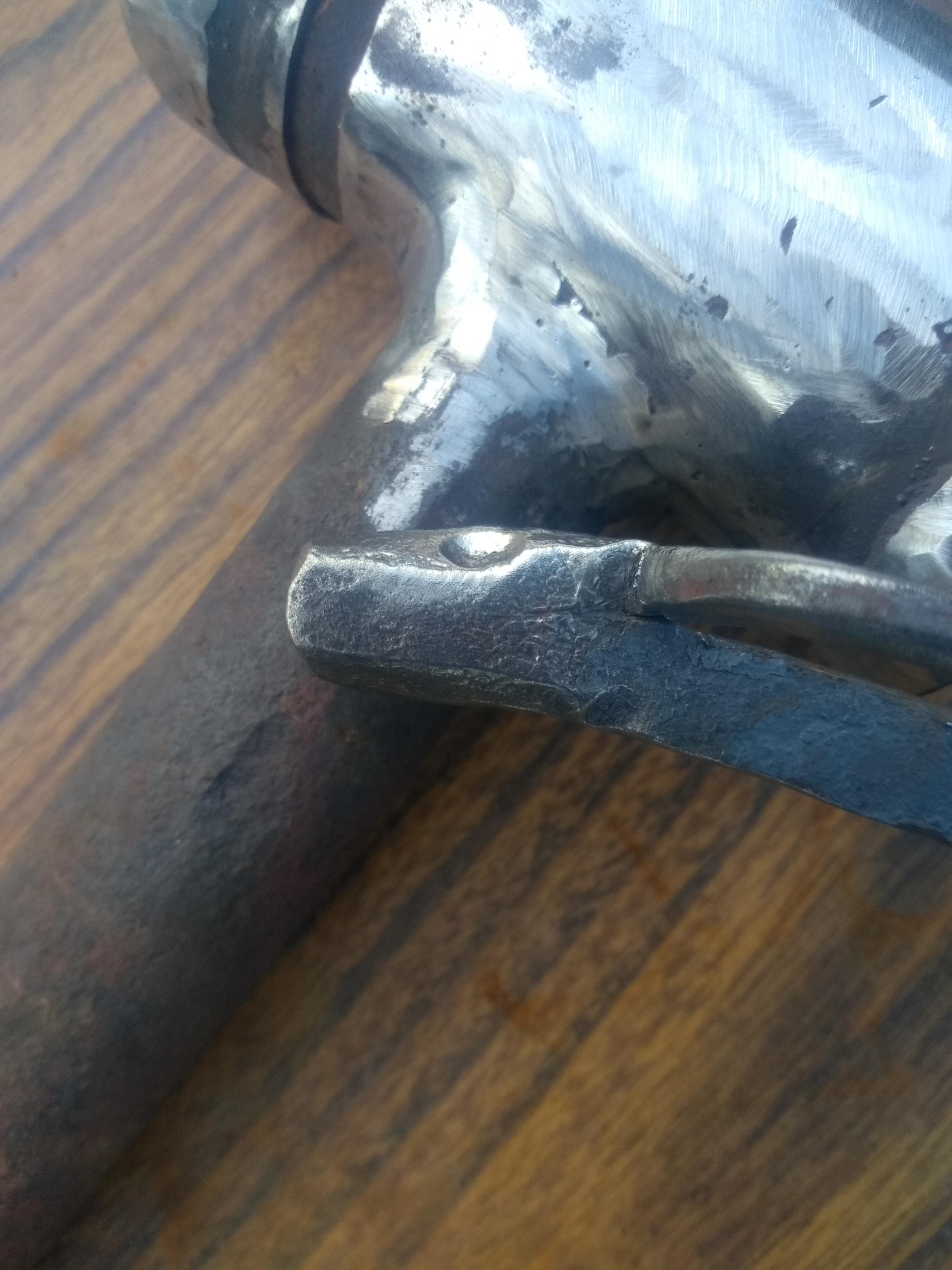

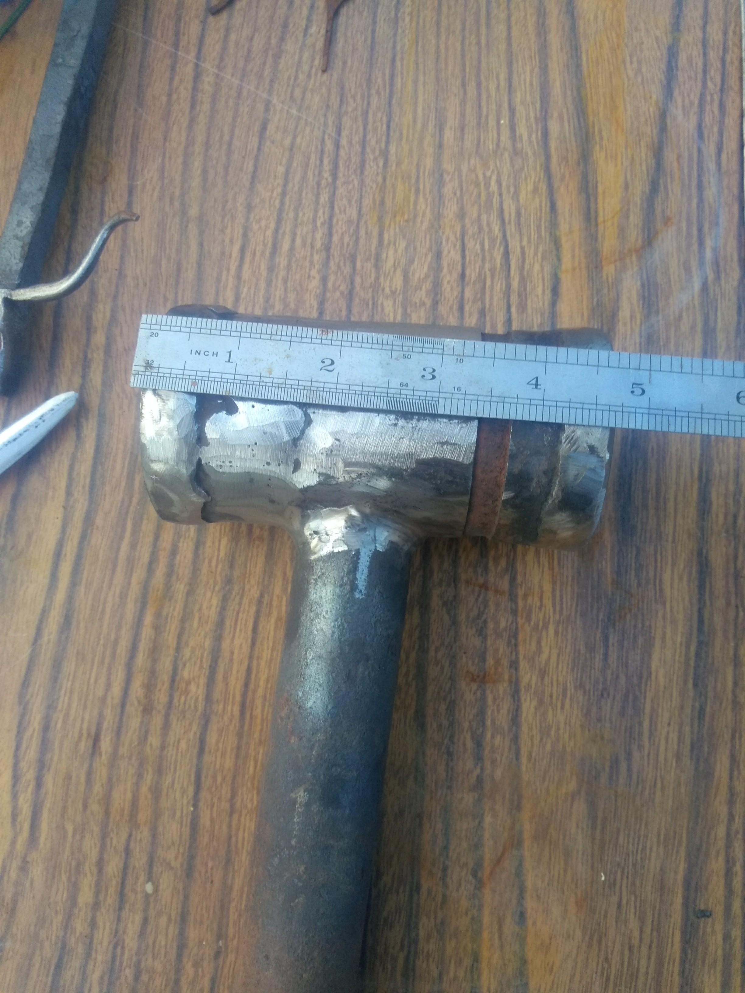

Had a buddy weld a couple of pieces of normalized? (heated to red to straighten then air cooled) 3/8 inch leaf spring onto an old ~2.5 inch od pipe, filled 3/4 full with the finest quartz sand I could find in the hydraulic mining "Diggins" behind my house. I got to try welding on the handle, its not pretty but he said it should hold. He's just a backyard welder, so I'm not sure if his opinion is worth much on this subject. I'm in the process of grinding it down to check for cracks and to make it a little prettier. It's about as heavy as my 3lb hammer, maybe a little more.276820676_IMG_20200122_1616004132.thumb.jpg.f22ea5c61547b1294afced1cd557f50e.jpg
I did try it on a longhorn I was trying out and I "felt" the weld on the first hit. I hit it again for good measure and it felt solid, so I figured I'd go with it. It was probably a lucky hit more than the hammer, as I've only ever felt the weld once before. More experiments to come.IMG_20200122_161629126.thumb.jpg.9d66fabac2cb8e665cbc27a1895b8446.jpg
