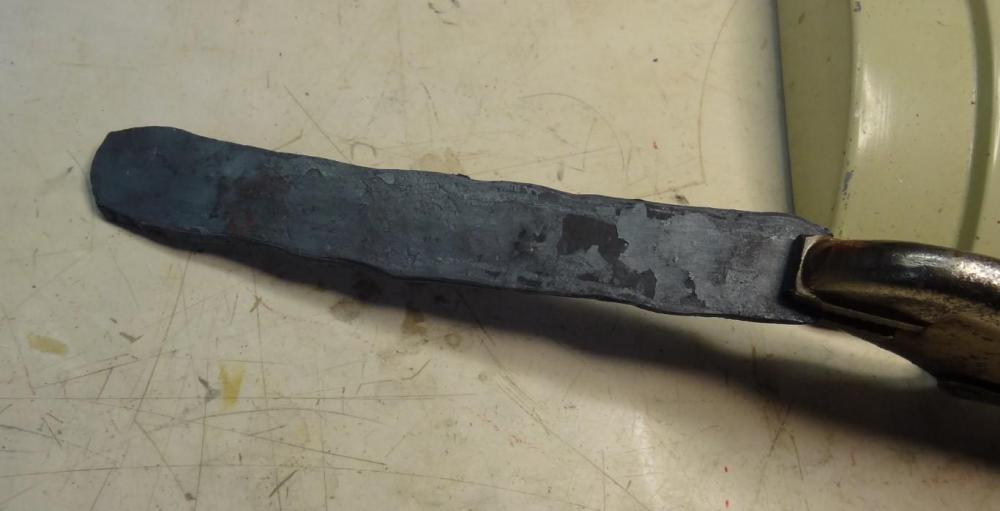

Wow, nothing like following an artist like Templehound with a beginner project like this. Some of you may need to avert your eyes, lol. Anyway, this utility sort-of-tanto-shaped blade was not only my first try at pattern welding, to make it even more fun it was dry welded and hand hammered. 8-3/4" OA, 4-1/4" blade. 18 layers of thin gauge 1095 and 15N20, sandwiched around a 1/16" layer of 1095, for a 1" tall, 1/2" wide, 4" long stack. It was dry welded and not folded during welding. The handle is simple polished Koa from a small supply I brought with me when I moved here from Hawaii, and is pinned to a hidden tang with stainless pins. Several valuable lessons were learned in the process, such as don't heat directly in the flame path if possible - I think doing that created some scale/stains especially on the left side I could simply not get totally polished out (especially visible in the post-tempering photos).  Tempering was 450F for an hour, and hardness seems fine, which leads me to believe the blue after-tempering color was probably caused by residual quench oil (another of many lessons learned). The biggest lesson, though, taught to me in no uncertain terms by my right wrist, is to start saving up for a small power hammer. :wacko:
8 photos below, I resized them but hope I smashed them down enough.

And you're right, Frosty, if I was doing it again I'd make it into more of a Wharncliffe and put the edge on the other side. My wife and chief QA inspector already gave me one of those "why did you make an upside down knife?" looks about the handle when she picked it up. But, as I lamely explained, it was less intended as a real working knife as it was a dry-welding attempt. I tried welding a billet with borax and not only had delaminating problems, the danged flux ate a crater into my kiln shelf forge floor, which really torqued me off. So I'm going to try to stick with dry welds from now on. This one seemed easier to hammer out, I had no delams to speak of, and it left the forge floor in pristine condition. Heck, now that the idea has been planted, maybe I'll re-grind the profile and call it a semi-Wharncliffe.

Could you explain how you prepared the individual pieces of the Damascus stack to allow a dry weld.  From what I have been told about dry welding is the layers of metal must be clean and flat..

The billet was nothing special, I just was pretty careful in prepping it. The stack was made up of all new metal, alternating 1/2" x 4" wide strips of 0.035" 1095 shim stock and 0.049" 15N20, with a 1/16" strip of 1095 as the core. The first photo in the sequence above shows the billet (19 layers) after each strip was cleaned with acetone, stacked, tacked with a MIG welder, a stub added for the tongs, and after it was cleaned up on the belt grinder. I was really careful to keep the metal clean as I assembled the stack, and I ground the billet down to fresh metal on all sides after it was tacked together. After all that careful prep, the actual dry weld itself was kind of anti-climatic and was surprisingly easy to do. I had fooled around with borax on a couple of experimental billets and did not like using flux, mainly because it was messy as heck and cratered my forge's kiln shelf floor pretty badly. So I decided to go dry. I plan to try some more dry billets but have several knives for friends and family to finish up before I get back to experimenting. Also getting ready to add a VFD & 3-phase motor setup to my home built 2 x 72 grinder to replace the 1.5 hp single speed motor,which will give me some much needed speed control. Right now it's pedal to the metal at 3450 RPM or nothing. Thanks again for the hammer control advice, I'll work on it.

Thank you very much for the dry welding information. I will use your information to make my next welded knife blade. On the tang end of my billet, I welded a 2' long  piece of 1/2" hot role steel to be used as a handle for the Viking Seax Broken Back blade I made.. the cutting edge is facing up in this picture.
1. Metal stack was clamped, MIG welded across each end, and also once across each long side. All welds were then ground down to flat clean steel before welding on the tong stub, which was a short piece of 1/2" square HR.
2. Don't remember on the soak time. I turned it over just once, I think. I probably slapped it down on the anvil shortly after it was yellow-white and I was sure there were no shadows.
3. I would not recommend trying this with mystery or pitted/dirty steel involved. This stuff was all new and shiny, and I cleaned every layer very carefully.
4. Do not make the mistake of assuming I knew what I was doing. This was my first time, and it just happened to come out well. :D
5. You made a nice looking knife there!
