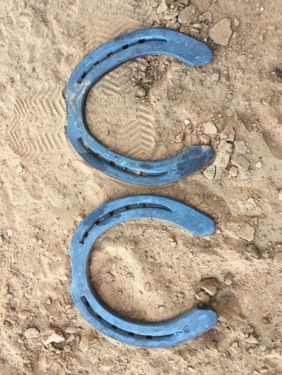

Thanks for the info, but that's for the regular shoes.  I was curious about the small ones you make at demos.  I guess I could figure it out, but I kinda wanted it straight from the horse's mouth.....
Wait....I gotta go get my tape measure.
.......OK, I'm back.
I got the following lengths on some shoes I had handy:
#000  12 1/4"
#1  14 1/4"
#2  14 3/4"
I was under the impression that your small shoes were maybe a couple of inches or so in size.  So the 10" length gets you a shoe somewhat smaller than the #000.  Good size for a kid to carry around.  Not nitpicking you here, just fishing for the bar size.  Thanks again for the info!!
(BTW, I was a math major in college, but I changed my major to geology......DUH)

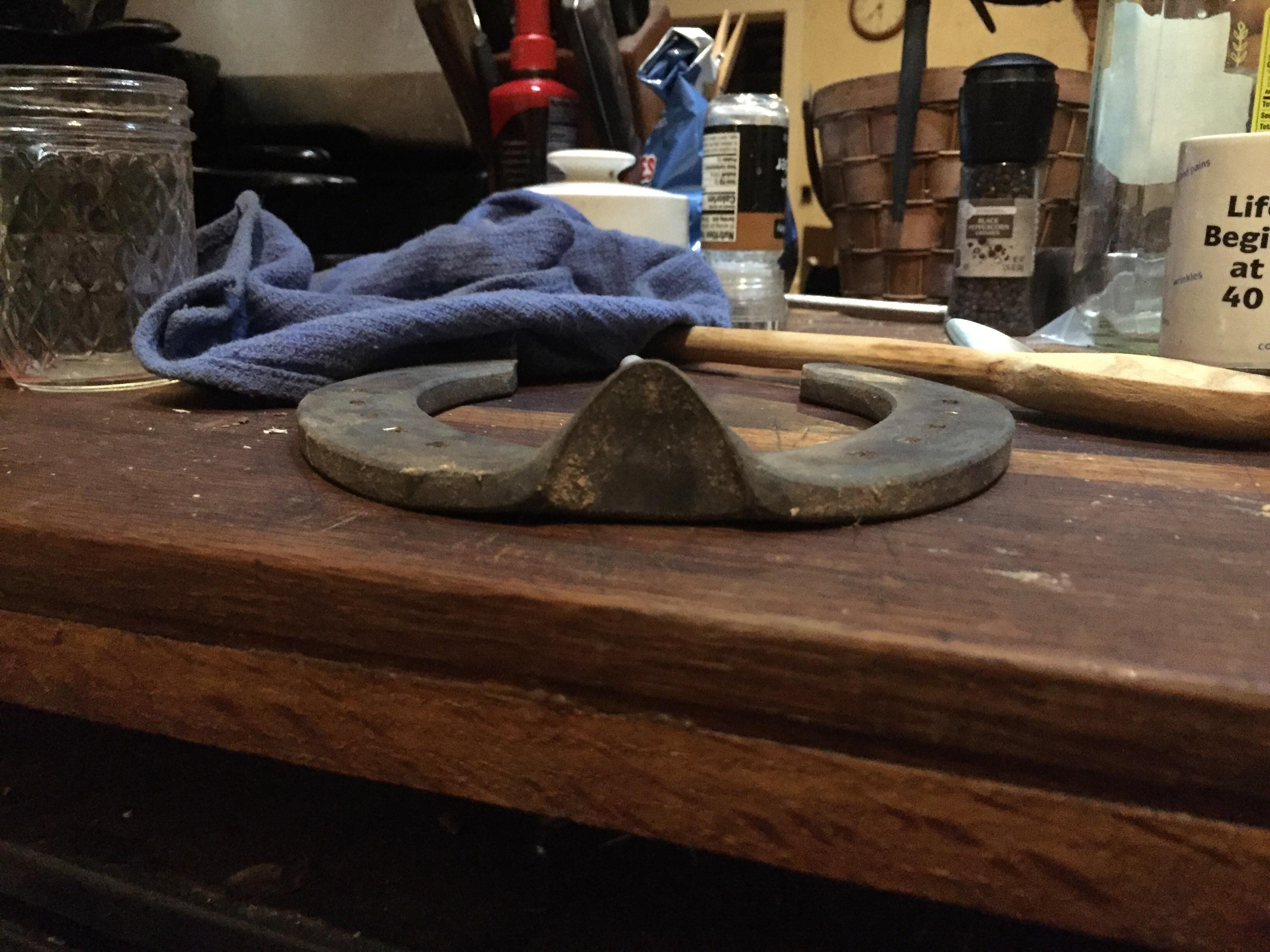

Point of normanclature, those are heal calks not clips. With out the calks a bare will grow (outside circumpherance) 2x the width. So a 10” bar makes a shoe 11 1/2” measured from heal to heal around the outside.
Best to just turn up the calks, true them up and then set the heal edgewise on the anvil and giver a smack or two to change the direction from across the heel to perpendicular. Heal calks arnt much use with out toe calks so you might skip weld a set on wile your at it.
That’s a toe clip. If you turn the heals as I describe you acualy draw your length back out (hand mades not modified keg shoes).
So let’s consider your tiny demo  shoe, if you start with 1/4” round and flatten one face that gives you 3/8” x 3/16” or so, cut off 5” and round the heals, now bend it the hard way 90 to form the toe. Square that up. If your going to fuller now is the time. Bend each branch and punch your holes (toe even with the back edge of the toe web in the middle of the bar, third nail at the widest point of the shoe and the second nail between the others) now nerrow the shoe so the inside edge of the heals is as wide as the toe holes.  Front shoes are full like packman wile the hide have strait sides and are shaped like a deviled egg.
There you go 2” or so wide shoe of the right praportions. Kick the heals into trailers for a cool look if you must.
