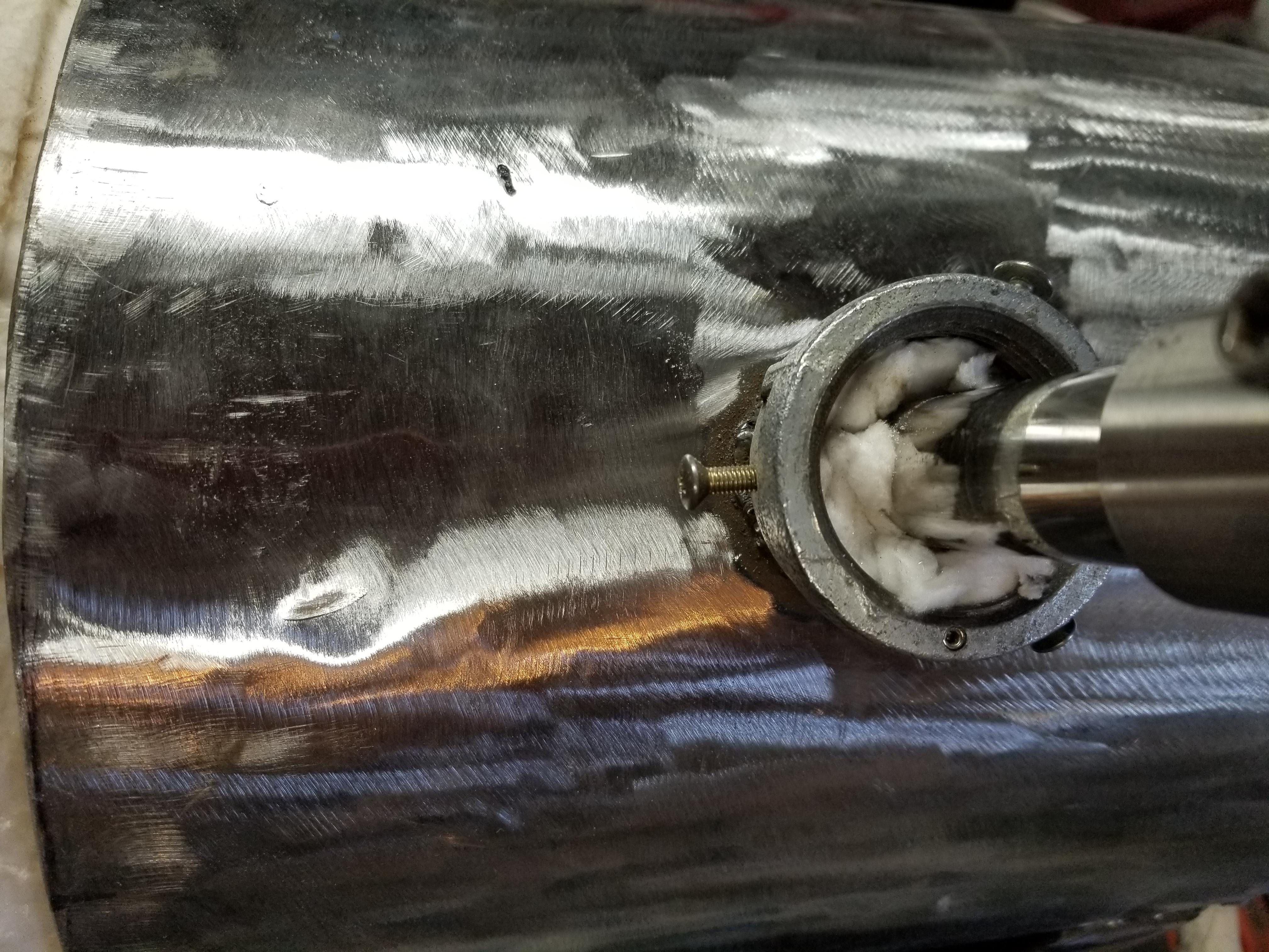

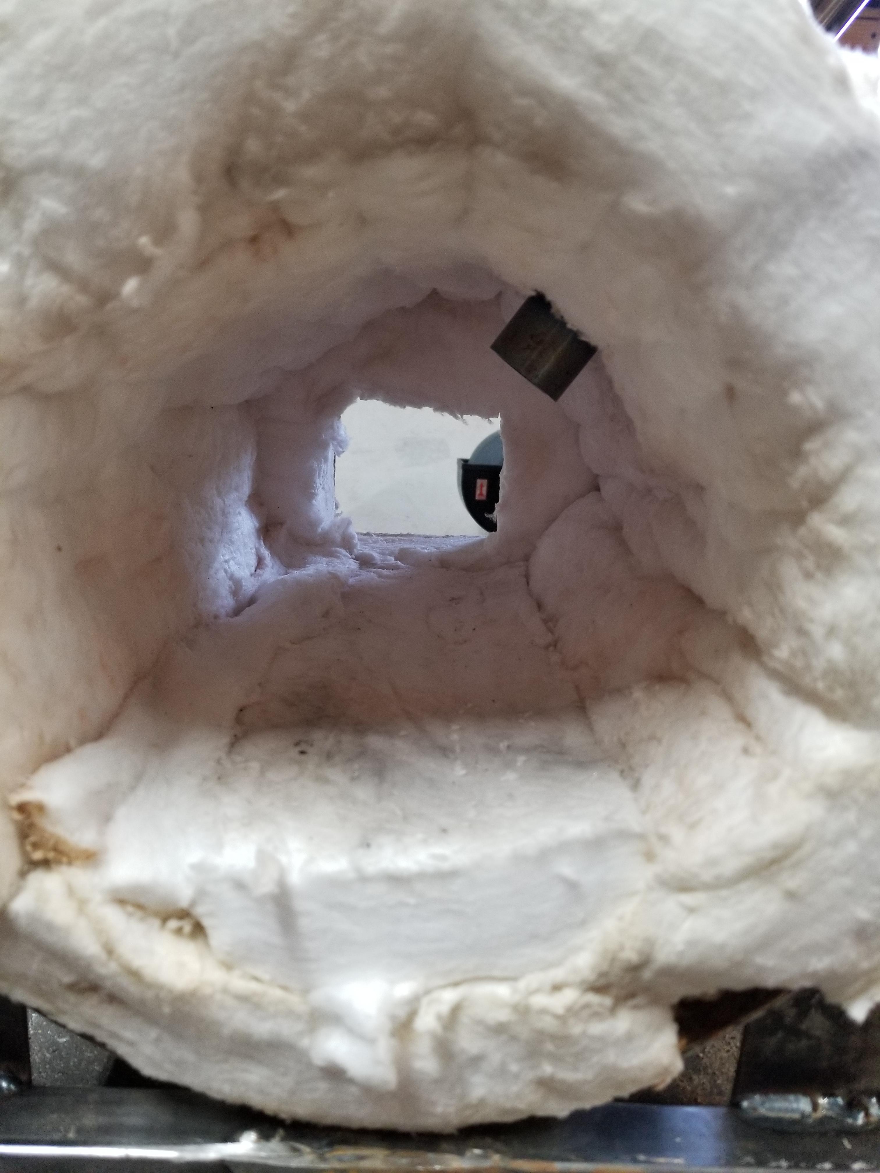

Njaak Posted July 28, 2022 Share Posted July 28, 2022 (edited) Hi all. New to blacksmithing, made a couple of basic knives in a course, and I'm now trying my hand at forge building. The pictures are the current state (version 3). It's not progressing well. Version 1 had vertical burners with a touch of space (hairline) around them, and the burner tips were recessed about 1 inch from the hot face interior of the forge. In version 1, the burner tips got red hot faster than I could get my steel to forging temp (1600 F). Version 2 was much the same but I sealed off the hairline space around the burners with kaowool and refractory cement, and added a thermocouple. No perceptible change. Maybe bought an extra 3 minutes. Version 3 - I tilted the forge on its side and pulled the burners back pretty far, and sealed the kaowool in the burner ports. Hit 1300 F and a touch of orange started to show on the burner to the right (the black one) at the exterior shell. The other two burners (plumbing ones) were glowing at their tips inside the forge but not outside. I can touch the outside shell of the forge with bare hands in most places during operation, but close to the burners no way. I put some refractory bricks against one of the openings in Version 1 to see if it would have any effect... and it heated up much faster, but I noted the burners got orange faster too. Questions: 1 - ideas on how to fix this? Is it worth trying to fix? Cheapest "good" fix options? 2 - What is the appropriate warning sign that I need to shut it down? I assume that I likely went too far letting the orange start to show at the exterior... But how do I know? 3 - I made the openings smaller than the inside body as kind partially closed doors like a pizza oven... And I made a flat floor which is now a wall... Are these now causing me problems? Thanks x a million folks. Edited July 29, 2022 by Mod30 Resize photos Quote Link to comment Share on other sites More sharing options...

Frosty Posted July 29, 2022 Share Posted July 29, 2022 Njaak: If you put your general location in the header a member living within visiting distance may be able to give you some hands on help. Are those 3/4" burners in your forge? How many cubic inch volume is it? Please do NOT list the outside dimensions I stopped doing arithmetic for folks years ago, what we need to know is the volume of the chamber in cubic inches. If those are 3/4" burners it's entirely possible you have one too many and back pressure is causing the flame to stay in the burner nozzle rather than the refractory liner. I use a thread protector" as a step "flare" on my burners. I started using them as a sacrificial nozzle to make mounting the burner easy and just tuned for my preferred flame. Later I discovered they were acting as a step flare enhancing performance. Cool. Anyway, the thread protectors turn orange hot after an hour or so and they will burn up after a few dozen sessions. They're sacrificial, they burn up so the more expensive parts don't. I sometimes dip them in a refractory slurry I made up and they last longer. The nozzle on your burner will get HOT, it has a hopefully 3,000f flame shooting out of it. There are some tricks. First barely extend the tip through the forge shell into the refractory. Secondly, make the burner port through the refractory larger than the end of the burner nozzle, if the OD of the nozzle is 1 1/2", make the port 2". Rigidize and apply your hard refractory to the inside of the burner port. If you leave bare refractory blanket you'll first be blowing vitrified refractory into your breathable atmosphere which is a B A D health hazard. Performance wise the blanket will slow the flame and trap part of it in the fibers trapping heat in contact with the nozzle. Those are general rules of thumb if you provide details I can be more specific. Frosty The Lucky. Quote Link to comment Share on other sites More sharing options...
Njaak Posted July 29, 2022 Share Posted July 29, 2022 (edited) Many thanks I'm in Ottawa Ontario Canada. Yes, 3/4" ID pipe as burner tubes. Two with bell reducers, One with a 1 1/8 ID tube instead of any flare. I would be very interested in thread protectors and will look into getting some. Also thought I could remove the flares entirely and instead cast them into the chamber with Satanite or something like that. Main chamber is approximately 5" ID, 13" long (1021 cubic inches). Front and back ports are approximately 3.5" ID and 3" deep (231 cubic inces between the two). Total roughly 1250 cubic inches plus a little more for the burner port holes. I was worried I had one burner too many, but went with the advice of a local guy down the road from me that does a lot of metalworking... But he's not a blacksmith. If I need to go down to 2, I'll likely just rework the entire thing. Might a ribbon burner sort out my problems? I chose propane burners because my area is windy and I only work outdoors (hence forge on a cart). Thanks again good sir! Edited July 29, 2022 by Mod30 Remove @name tag Quote Link to comment Share on other sites More sharing options...
