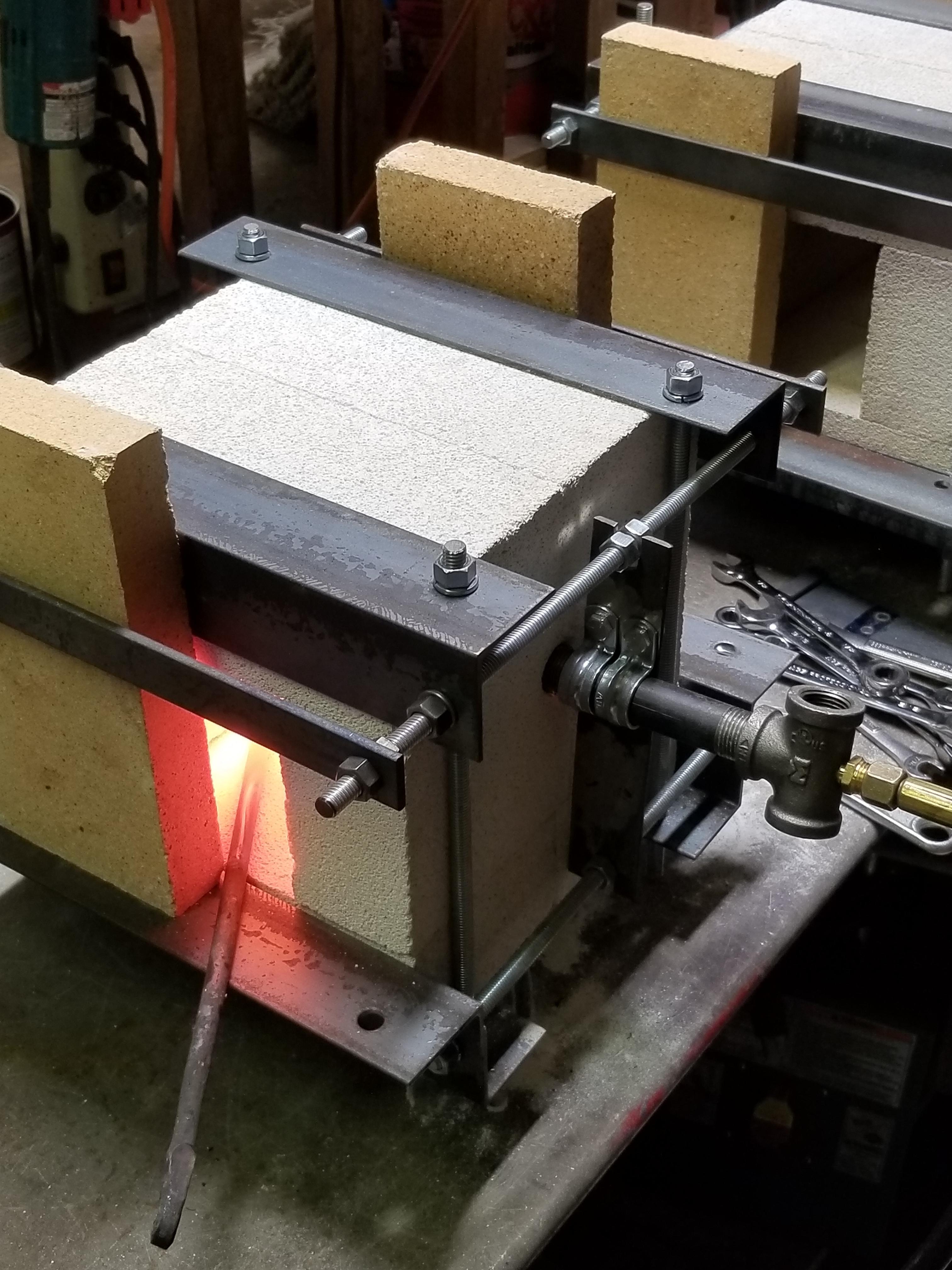

Njaak Posted August 3, 2022 Share Posted August 3, 2022 Frosty, I think now I'm going to build up a pile of bricks like the one in the picture you sent, then sort out if and how to convert the current mess into something for heat treating. To that end, are the bricks forges your club builds using 23 or 26 series bricks? I've read some varying suggestions (insulation value vs strength). My plan is to coat the inside of the chamber with 1/4" of Satanite. I was thinking all 2300 series except the brick opposite the burner which is do with 2600. Thanks. Quote Link to comment Share on other sites More sharing options...
Frosty Posted August 3, 2022 Share Posted August 3, 2022 They're K-26 with Plistex brushed on like thick latex paint as the kiln wash. Satanite might work, it seems to be doing pretty well from what I hear. You can make a brick pile forge as large as you wish. The temperature in the club builds is pretty even and easily exceeds 2,300f and probably 2,600f. Kiln washed K-26 are holding up so far. Frosty The Lucky. Quote Link to comment Share on other sites More sharing options...

Njaak Posted August 23, 2022 Share Posted August 23, 2022 I finished the pile of bricks! Flame is stable, thermocouple installed! Ramped up heating slowly over a couple of days. Tonight I'll test it out for real if all goes well Quote Link to comment Share on other sites More sharing options...

Njaak Posted August 24, 2022 Share Posted August 24, 2022 Mikey, I have digital calipers they're essential to custom bicycle work... the only builder hobby I actually got really good at (so far). The pile of bricks forge works like a charm. Here it is with some A33 in the process of becoming a drift. Burner doesn't overheat, and kept the temp super stable. I'm happy Thanks so much Frosty for the picture of that build. It was worth a thousand YouTube videos. Quote Link to comment Share on other sites More sharing options...
Frosty Posted August 24, 2022 Share Posted August 24, 2022 You're welcome Njaak, it's my pleasure. It puts a real smile on my face to see success, she looks HOT. If heat radiating through the bottom of the forge causes warping in the metal it's on a sheet of cement backer board on small stand offs takes care of it nicely. Frosty The Lucky. Quote Link to comment Share on other sites More sharing options...
Njaak Posted August 24, 2022 Share Posted August 24, 2022 It's actually currently on standoffs the threaded rod has acorn nuts on the bottoms, and raises the base of the forge about 2 inches off of the sheet metal. So far so good Quote Link to comment Share on other sites More sharing options...
Njaak Posted August 24, 2022 Share Posted August 24, 2022 Oh, and yes, was keeping it at 1925 or so. HOT indeed Quote Link to comment Share on other sites More sharing options...
