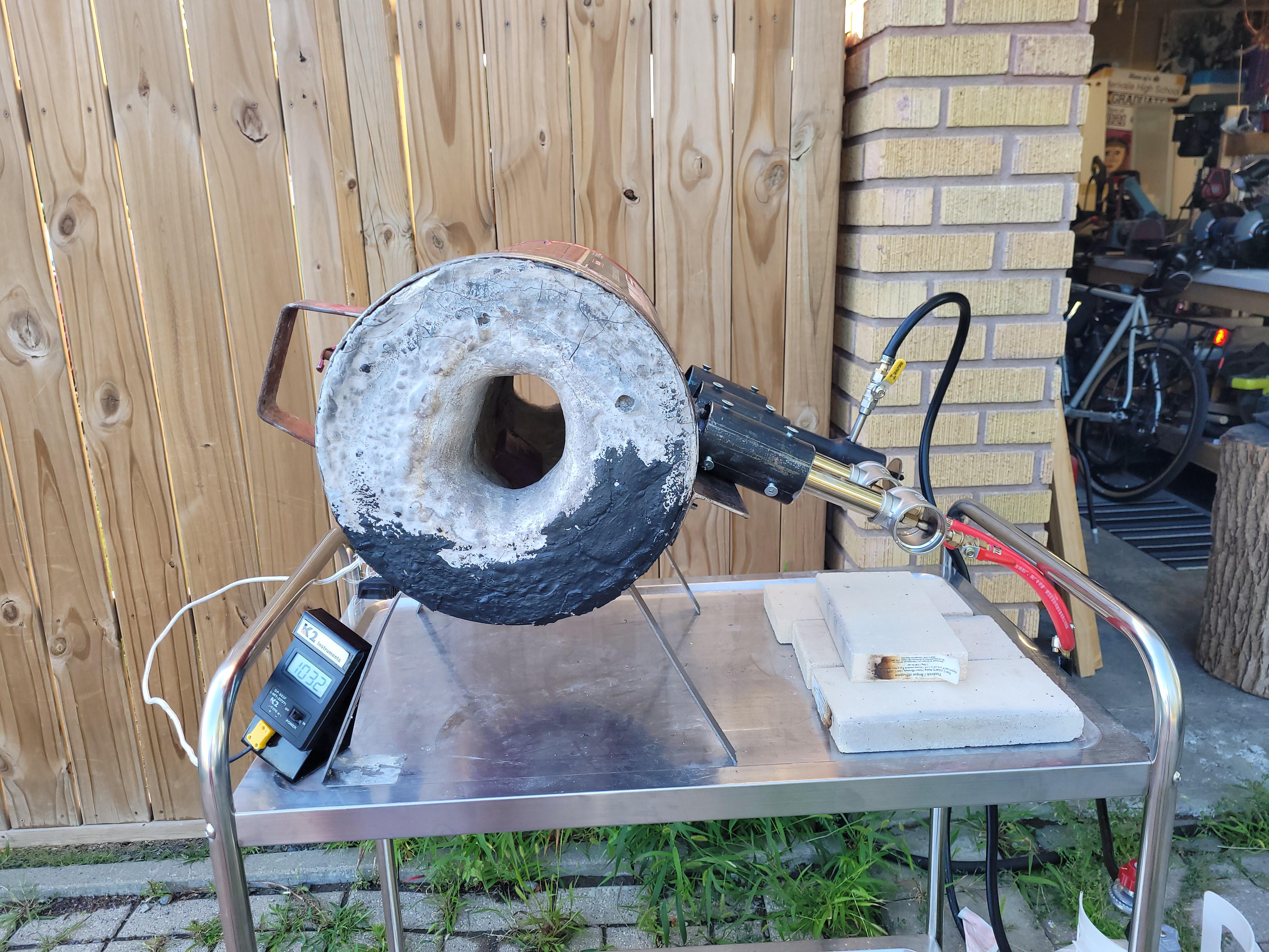

  3. Njaak
    burner depth
    Mikey, I have digital calipers they're essential to custom bicycle work... the only builder hobby I actually got really good at (so far). The pile of bricks forge works like a charm. Here it is with some A33 in the process of becoming a drift. Burner doesn't overheat, and kept the temp super stable. I'm happy Thanks so much Frosty for the picture of that build. It was worth a thousand YouTube videos.

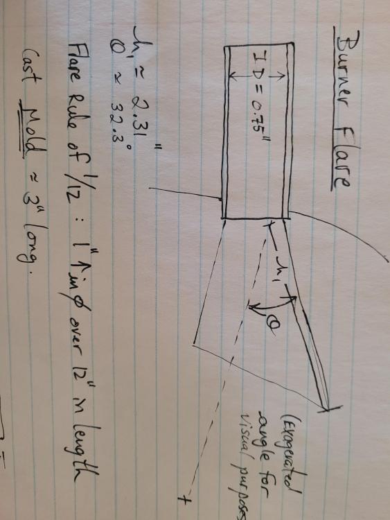

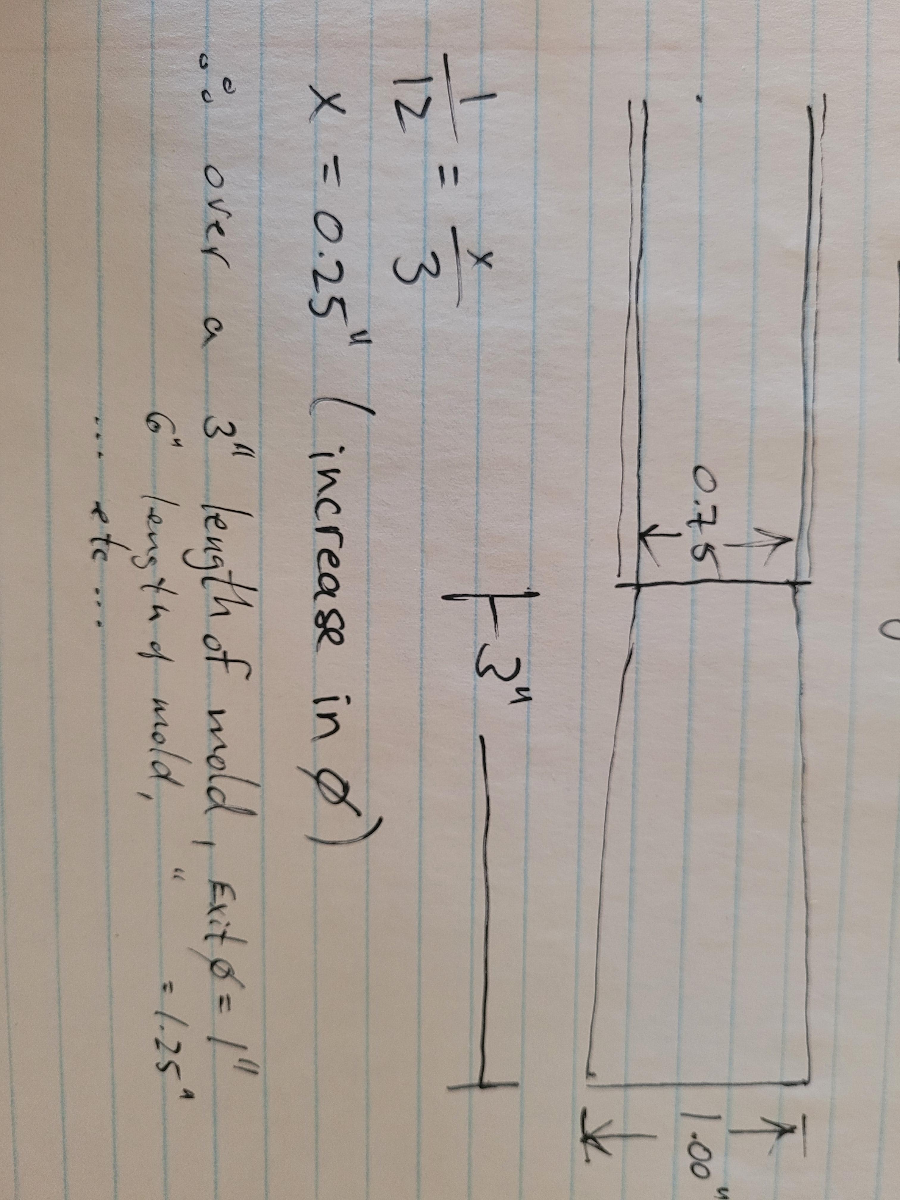

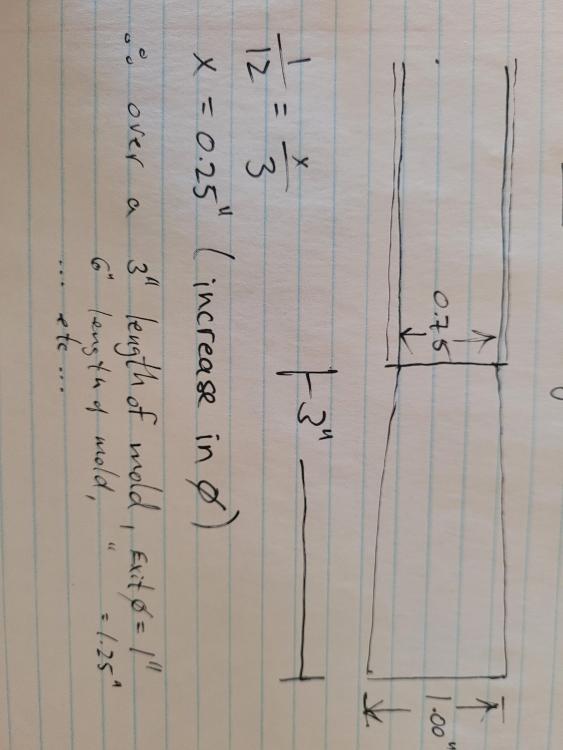

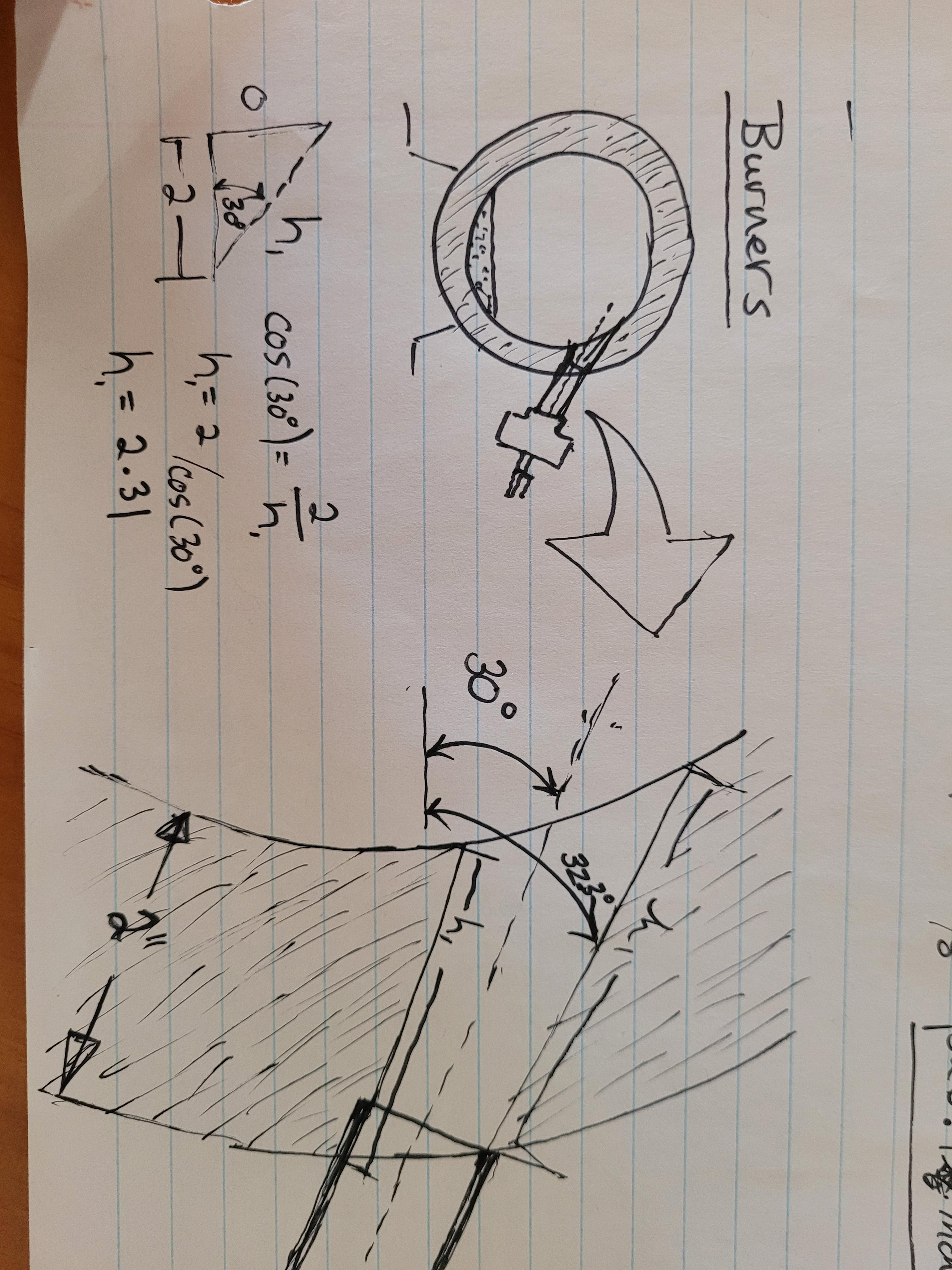

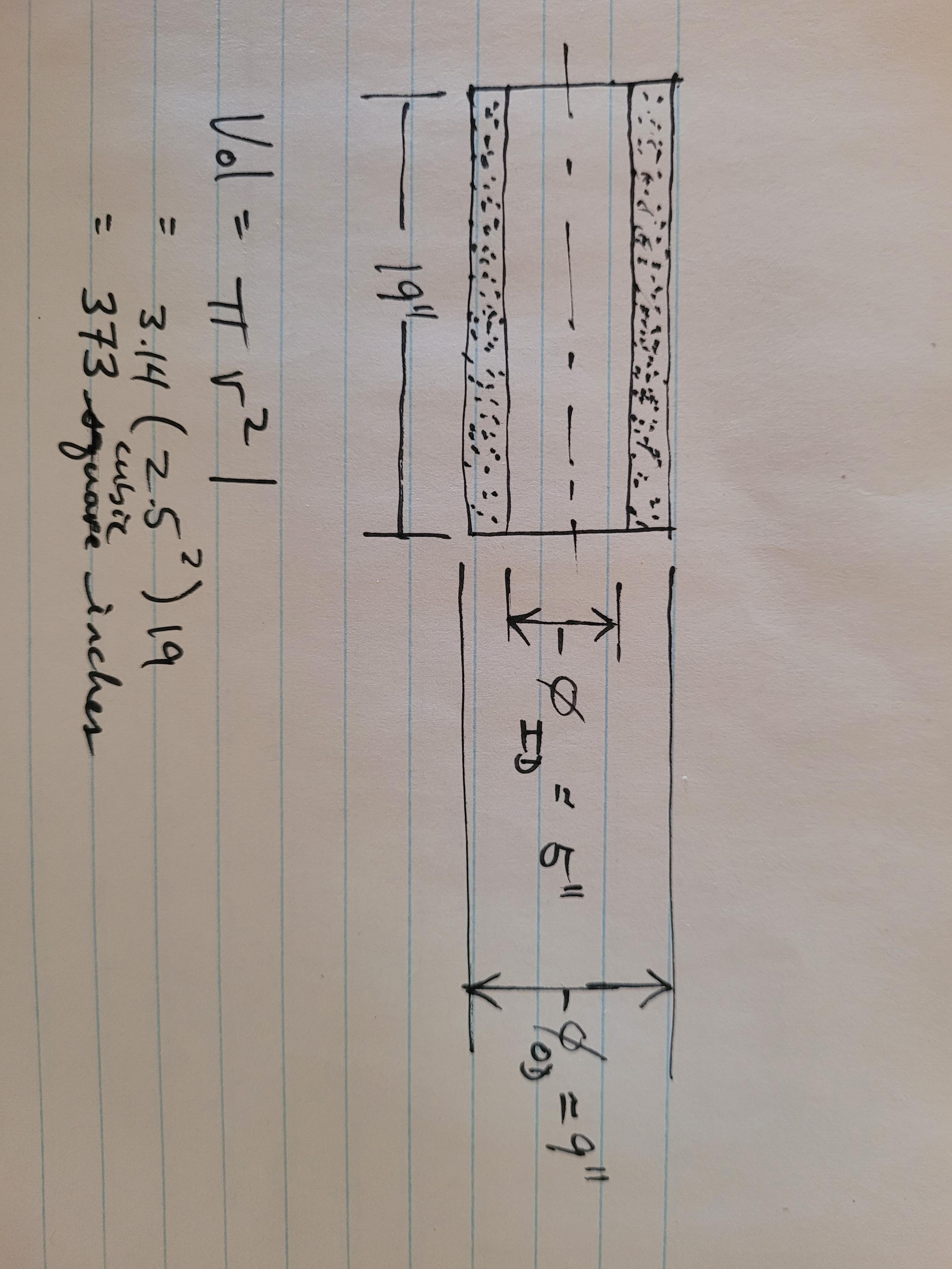

    Ok, did some 101 reading and rethinking. My basic cylinder is 5" ID and 19" long. 373 cubic inches. Frosty, I'd used diameter instead of radius in my previous calculation... urgh. Hence the factor of 4 error. Most embarrassing, as some 15 years ago I earned a mechanical engineering degree (that was used for nearly 3 years, before turning my brain to other useful things). I'm flattening the bottom out a bit which will reduce the volume no more than about 1/10 to 1/8. Roughly resulting in say 340 cubic inches. My understanding is the rule of thumb is one 3/4" burner per 250-300 cubic inches. Given I doubt I'm in the highest efficiency build category, I believe 2 burners should work well. They may even be a bit much. My previous design with even less volume (door constrictions) and 3 burners was unfortunately.. really really bad. The pipe reducers on my burners appear to be the worst flares ever. I will remove them and cast my reducers into the build. The 1/12 rule suggests that for my 0.75" ID burners, the entrance diameter at the forge hot face is only marginally bigger. A 1" increase in diameter per 12" length, means that with 2" wool thickness and a 30 degree angle of incidence, I'll build my mold about 6" long with one end at 0.75" diameter and the other at 1.25" diameter and cast around it. I'm also reconsidering my use of a threaded burner support bar. I did so because I don't yet weld, but do plenty of threading. However, the extra steel adds weight and fuss. I may either pay someone to weld it up, or knuckle down, take a step back, and learn to weld. Some pics of my rough sketches and math for critique. Thanks all!

    Thanks SO much Frosty. I'll put some sketches together in the coming days for a rebuild and post for critique.
  13. Njaak
    burner depth
    Hey Frosty I did that re: location. Not sure why it doesn't show... I'll put up a sketch, but I'm already disassembling it. Volume calculation is just pi*(r*r)*L. Don't and back "openings / doors" have depth to them so I included that in the total. The objective is to be able to forge pieces up to 12" long in a hot zone. The rebuild will allow up to 4" wide. I'd like to be able to do knives, drifts, axe heads, and basic tools. I'll go to the 101 page again. My build was based on one I going in instructables. I did add the constricted openings and third burner, clearly mistakes I think. Thanks again.

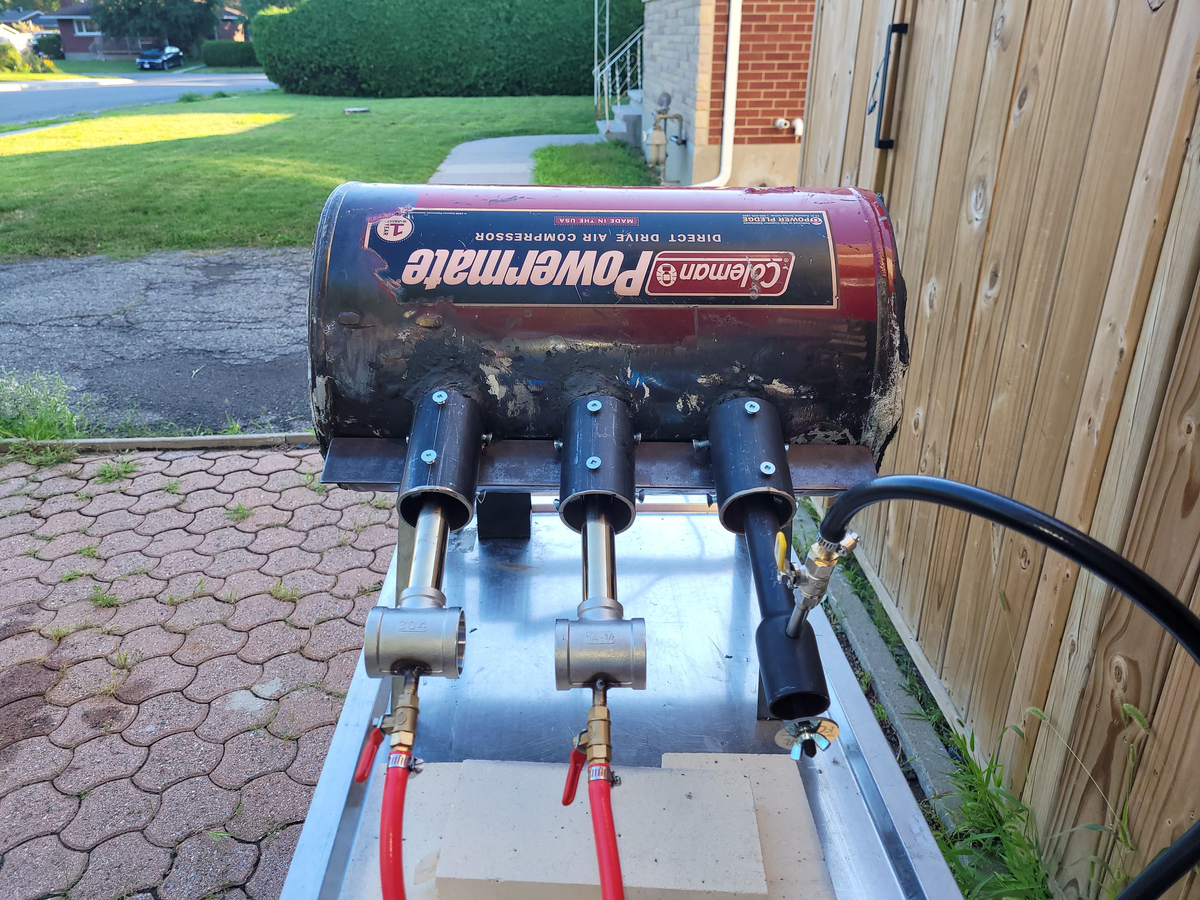

  14. Njaak
    burner depth

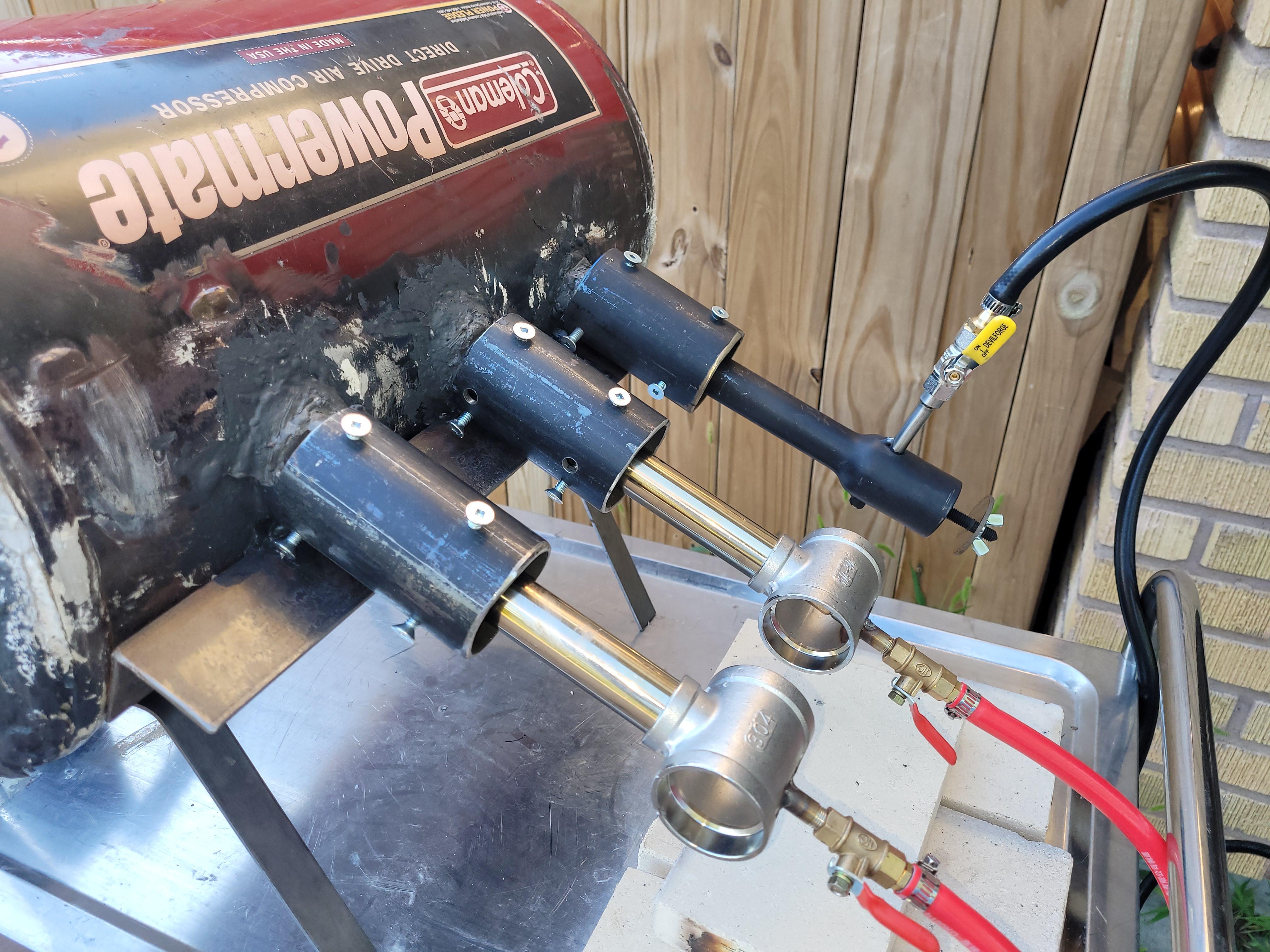

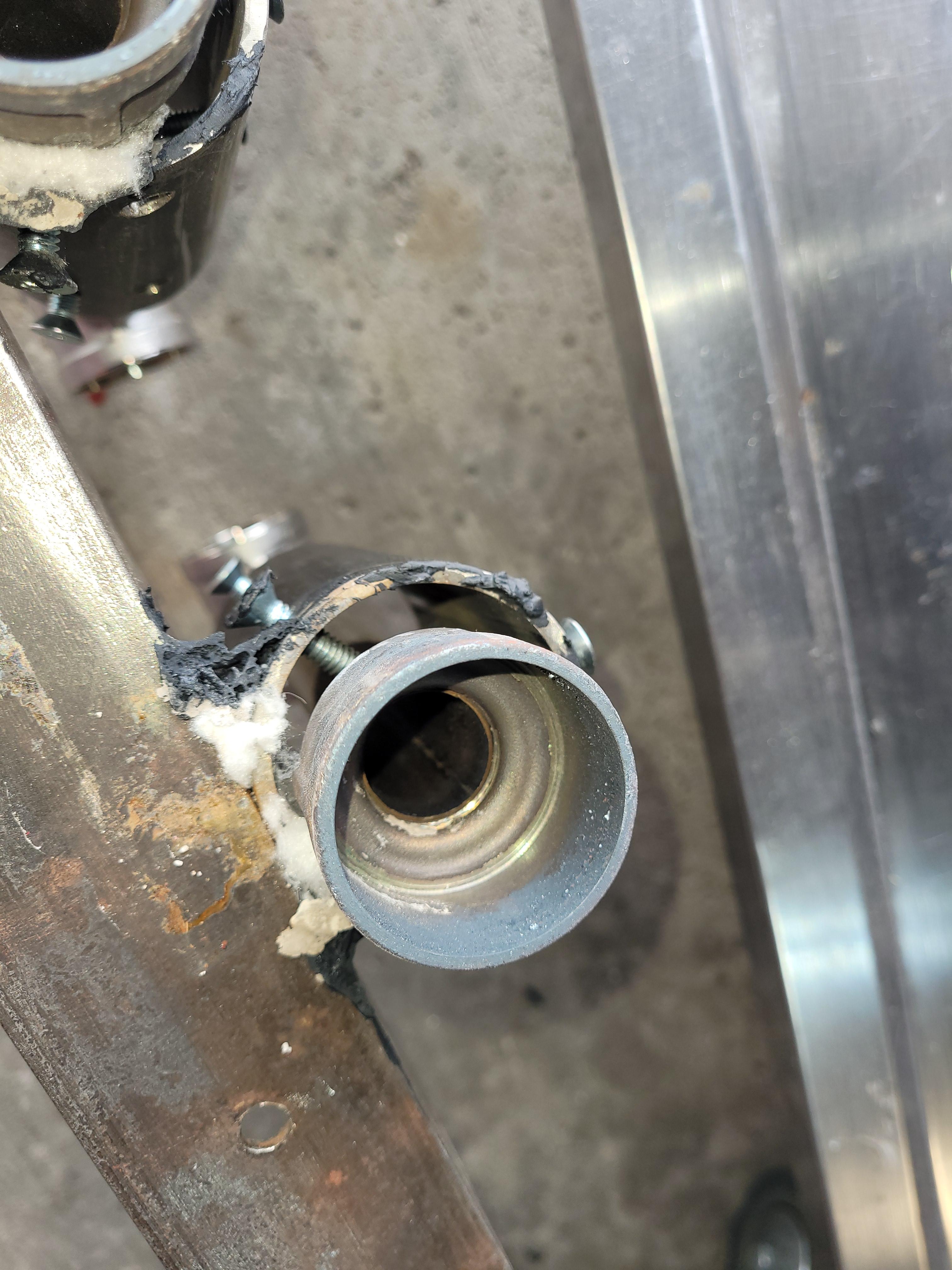

    Many thanks I'm in Ottawa Ontario Canada. Yes, 3/4" ID pipe as burner tubes. Two with bell reducers, One with a 1 1/8 ID tube instead of any flare. I would be very interested in thread protectors and will look into getting some. Also thought I could remove the flares entirely and instead cast them into the chamber with Satanite or something like that. Main chamber is approximately 5" ID, 13" long (1021 cubic inches). Front and back ports are approximately 3.5" ID and 3" deep (231 cubic inces between the two). Total roughly 1250 cubic inches plus a little more for the burner port holes. I was worried I had one burner too many, but went with the advice of a local guy down the road from me that does a lot of metalworking... But he's not a blacksmith. If I need to go down to 2, I'll likely just rework the entire thing. Might a ribbon burner sort out my problems? I chose propane burners because my area is windy and I only work outdoors (hence forge on a cart). Thanks again good sir!

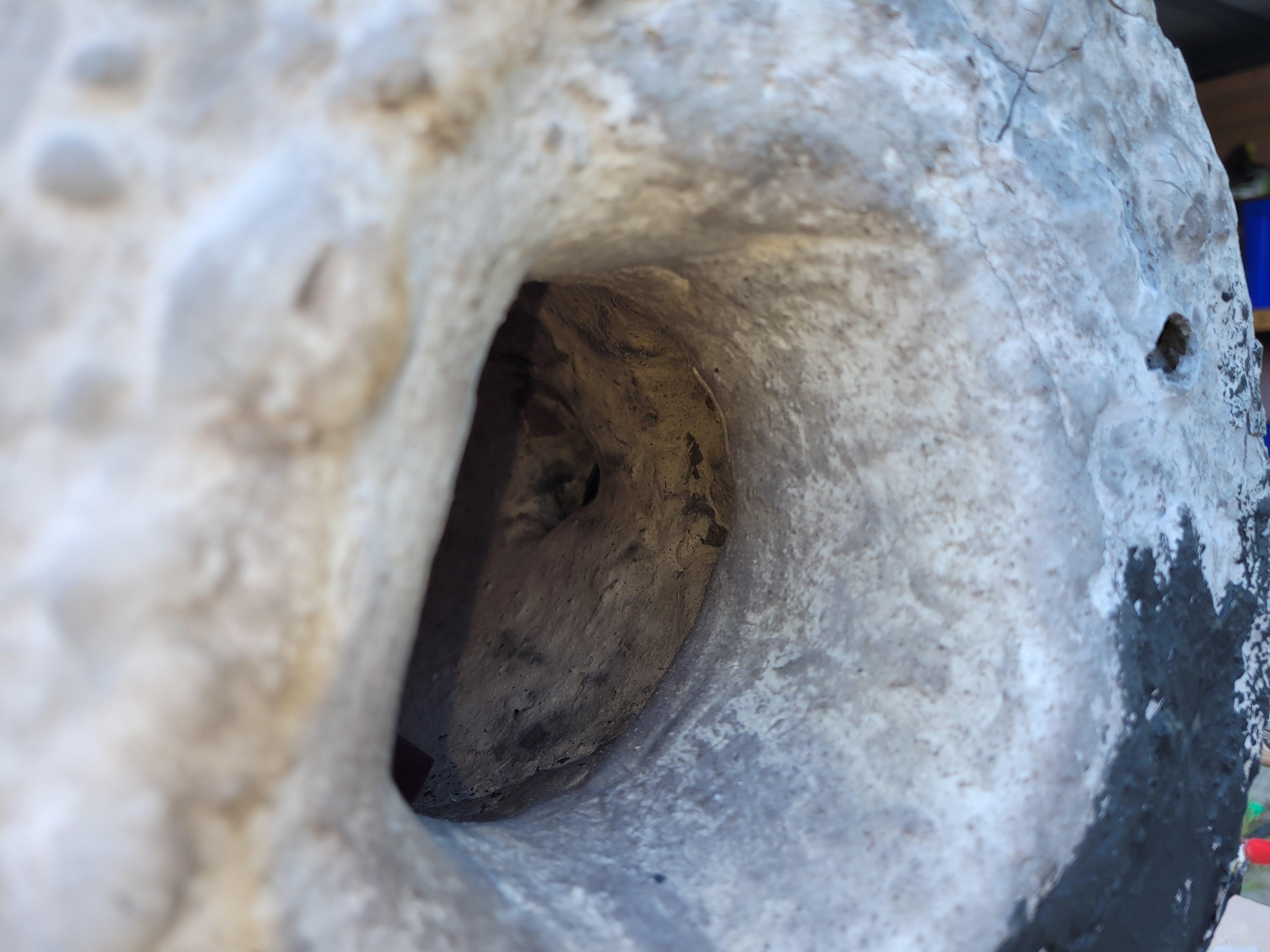

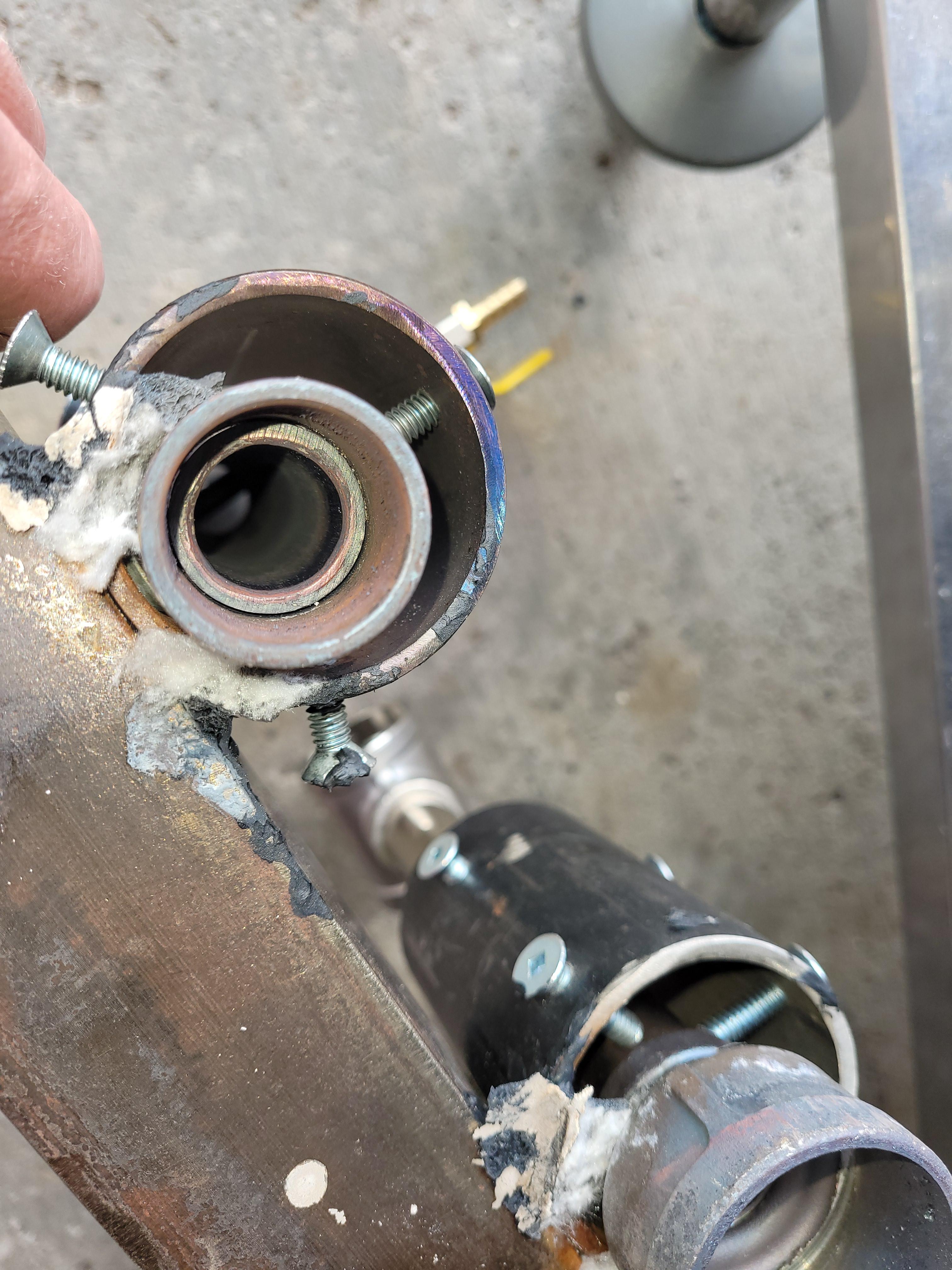

  15. Njaak
    burner depth
    Hi all. New to blacksmithing, made a couple of basic knives in a course, and I'm now trying my hand at forge building. The pictures are the current state (version 3). It's not progressing well. Version 1 had vertical burners with a touch of space (hairline) around them, and the burner tips were recessed about 1 inch from the hot face interior of the forge. In version 1, the burner tips got red hot faster than I could get my steel to forging temp (1600 F). Version 2 was much the same but I sealed off the hairline space around the burners with kaowool and refractory cement, and added a thermocouple. No perceptible change. Maybe bought an extra 3 minutes. Version 3 - I tilted the forge on its side and pulled the burners back pretty far, and sealed the kaowool in the burner ports. Hit 1300 F and a touch of orange started to show on the burner to the right (the black one) at the exterior shell. The other two burners (plumbing ones) were glowing at their tips inside the forge but not outside. I can touch the outside shell of the forge with bare hands in most places during operation, but close to the burners no way. I put some refractory bricks against one of the openings in Version 1 to see if it would have any effect... and it heated up much faster, but I noted the burners got orange faster too. Questions: 1 - ideas on how to fix this? Is it worth trying to fix? Cheapest "good" fix options? 2 - What is the appropriate warning sign that I need to shut it down? I assume that I likely went too far letting the orange start to show at the exterior... But how do I know? 3 - I made the openings smaller than the inside body as kind partially closed doors like a pizza oven... And I made a flat floor which is now a wall... Are these now causing me problems? Thanks x a million folks.
