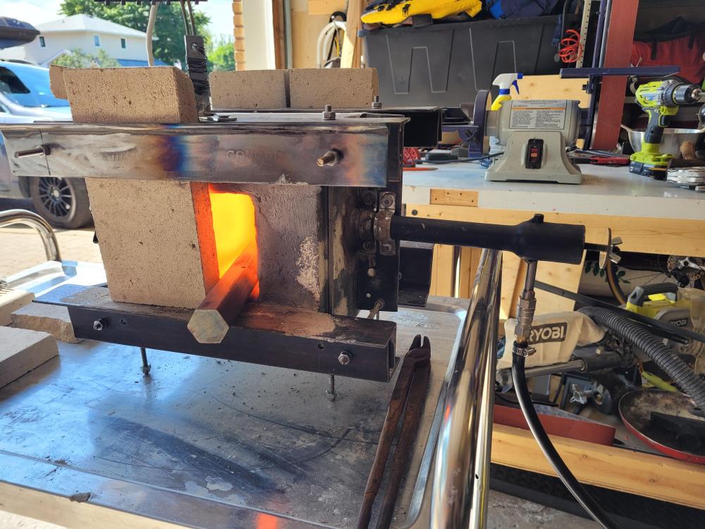

Mikey, I have digital calipers they're essential to custom bicycle work... the only builder hobby I actually got really good at (so far). The pile of bricks forge works like a charm. Here it is with some A33 in the process of becoming a drift. Burner doesn't overheat, and kept the temp super stable. I'm happy Thanks so much Frosty for the picture of that build. It was worth a thousand YouTube videos.
burner depth

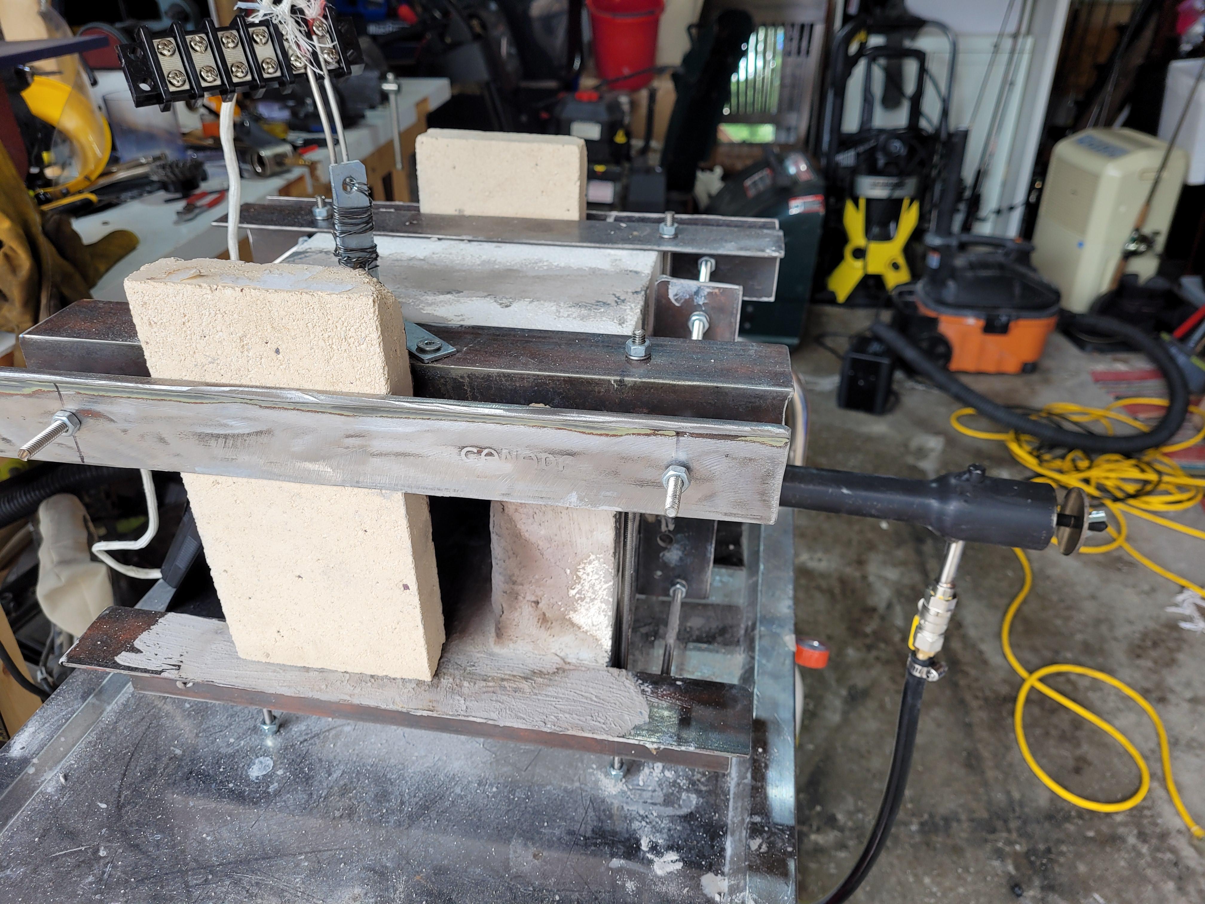

I finished the pile of bricks! Flame is stable, thermocouple installed! Ramped up heating slowly over a couple of days. Tonight I'll test it out for real if all goes well
