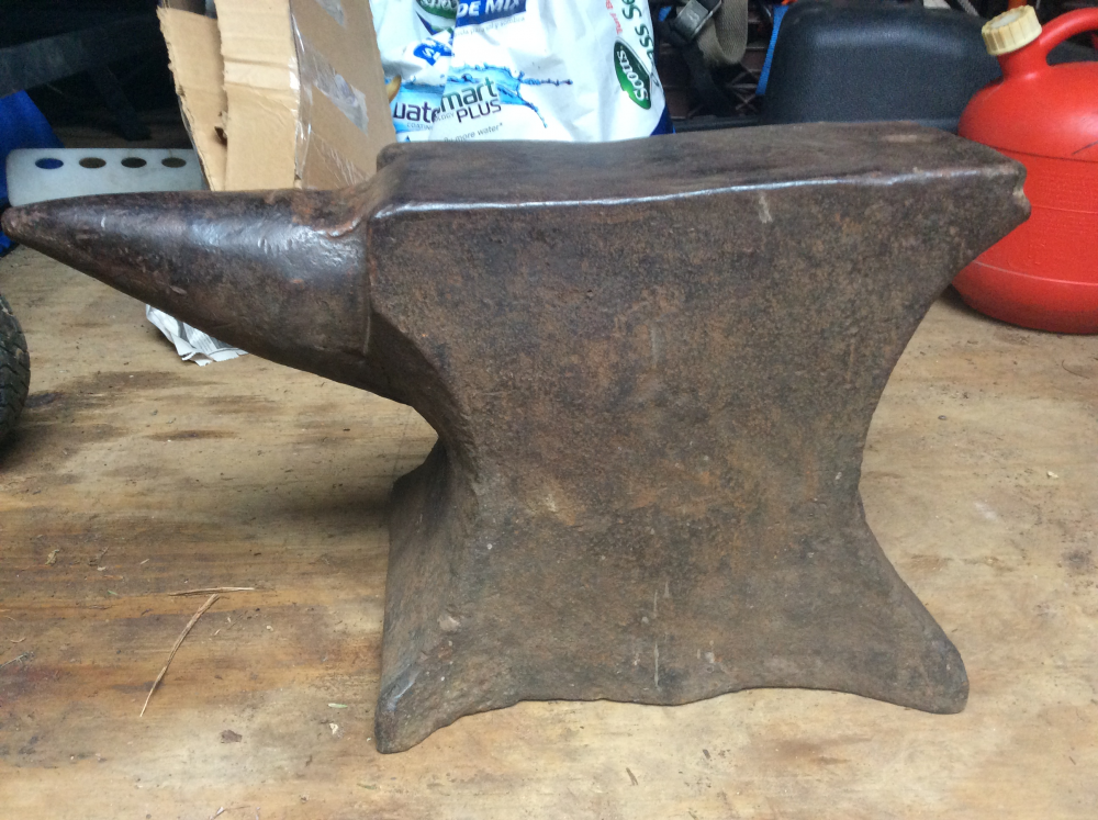

cdubb79w Posted December 2, 2018 Share Posted December 2, 2018 Hey all, I found this anvil for sale and I want to hear thoughts from more experienced smiths before I make any moves on it. It's 105 pounds and has no markings on it to identity it and the face has been milled and polished (kind of taboo it seems on something this old, right?). The seller advertises it as a late 1700s colonial style anvil and is asking $350. Is this description accurate and price good? I've never owned an actual anvil before, I've been using RR track. That said, how will the flat horn impact or limit what I can work/make, if at all? I pretty new but I do more blacksmithing then bladesmithing if that matters much. Also is there anything else I should look at if I decide to go after this one? Besides the standard damage survey, check rebound, sound and face sway of course. Thanks and reagrds! (If the owner is on here and sees this, please take no offense to this post, none is intended. I mean zero disrecpect or doubt in what you have listed. I wish to become better educated on the subject so I can better make choices.) Quote Link to comment Share on other sites More sharing options...

Marc1 Posted December 2, 2018 Share Posted December 2, 2018 Anvil hoarder ... we have one in Western Australia. Where is home for you? I don't like that anvil. You can do the same on a similar size cube or prism block of steel. Check you local steel merchant. Unless it is truly 1700 and you place value on that, minus the milling. Quote Link to comment Share on other sites More sharing options...
basher Posted December 2, 2018 Share Posted December 2, 2018 I would not be at all surprised if the steel face has been completely milled from the anvil, the flat top of the bic makes me think a lot has been removed. Quote Link to comment Share on other sites More sharing options...
marcusb Posted December 2, 2018 Share Posted December 2, 2018 I agree with basher. I imagine you are looking at a wrought iron base and nothing more. You would be money ahead with mild steel. If you would like the features of a anvil and not just a heavier work surface there are several modern options that would suite you well. Locally there is Holland Anvils in Michigan. They are a member here. They make a nice product out of H13 steel for a good price. There all also several companies that have been making good anvils out of ductile iron and various steels for years that are affordable. Some names to look up would be TFS and Emerson. With prices for used up anvils what they are today I would not hesitate to buy a new one if I planned on using it. If you are set on colonial Jymm Hoffman sells a 100 pounder similar to above for about $8 a pound. Quote Link to comment Share on other sites More sharing options...

JHCC Posted December 2, 2018 Share Posted December 2, 2018 Agree with Basher and marcusb: there’s no way an anvil that old would have a face that clean without milling. As for making the trip, if you have the hour to spare, why not? At very least, you get the experience of seeing and being better able to identify an unacceptable anvil. Quote Link to comment Share on other sites More sharing options...
Chelonian Posted December 2, 2018 Share Posted December 2, 2018 Just know that it probably doesn't have any of it's hardened steel face left on it. Here's a photo of approximately what it would look like if it hadn't been milled: *Not my image, I just found it on google* Looking at this photo, and then the one being sold, I think a lot of material has been milled away. Still might be fun to go look at it if you want, maybe the guy selling it will have something else you are interested in. Quote Link to comment Share on other sites More sharing options...
Frosty Posted December 2, 2018 Share Posted December 2, 2018 If it's been milled it's a pass at any price higher than scrap. It's now just another example of someone ruining a tool by "restoring or repairing" something they know nothing about. It doesn't even have much value as a collector item and zero as an antique. I'd maybe offer $20 if I was feeling generous, after giving the fool who ruined it a solid chewing out. Make an anvil, there are lots of how tos on Iforge and keep looking if you really want a London pattern. Frosty The Lucky. Quote Link to comment Share on other sites More sharing options...
