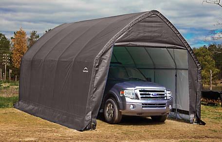

After not getting a bonus this year, I am having to make considerable changes to my smithy plans. Going from a dedicated framed and sided structure to considering something temporary like this. How is the material holding up? I'm concerned about both material degradation over time as well as it being flammable. Considering getting something like this this week since its on sale: 10 foot x 8 foot x 8 foot
Or this since it has a higher roof: 13 ft x 20 ft x 12 ft H
If I do head in the enclosed direction, I would want to make sure the ventilation was good with a fan blowing air out the opening and already have 2 CO monitors (in case one fails). Thoughts from any of you more seasoned folks?
It's rubbish. After less than one summer in the sun it is noticeably faded and feels ... 'tatty?' It blew over once and tore a hole where the mid-span stabilizing loop attaches to the sheet. I got a little bit of snow on it recently (not much. I'm in the DC area not the midwest.) and wow! I'm going to have to keep a very close eye on it. I can see the whole roof shredding with a couple of inch snowfall.
Having said all that, it was _cheap_. I don't expect much for the price I paid. I was seriously hoping to be under more permanent cover by now, but... life.
That peak style shelter has one thing I wish I had with all the rain lately. Sides. I'm not convinced it is worth the price difference but those sides would keep things quite a bit dryer in there. It would be horrifying in the summer, though. such hot.
The garage in a box thing looks nice. That would be like working in a gymnasium! :) If the sides roll up and you can find a way to rout a chimney, that thing could be a contender. One consideration, though. I did some napkin math recently about what it would cost to build a 10x10x8 timber frame out of big-box material using a thin-skin sheathing as infill. Depending on how you roof it, I was in the ballpark of twice the cost of the garage in a box. If you can get any part of that for free/cheap, you might be able to make something much nicer for a reasonable cost. As long as you don't burry the posts in concrete (bolted to steel plates buried in concrete for example) you can even take it with you when you move.

17 hours ago, robie1373 said:
It's rubbish.
This is my primary concern with investing into the above solution.
