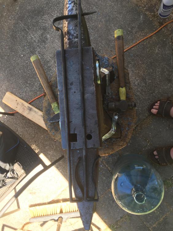

  11. Did a little scrolling practice and a lot of drawing out and rounding practice. 1/2"sq bar to ~3/8" round. The one on the left was my exemplar. I didn't have time to smooth out the scroll today. Also made my first spoon. It has two ends. Why? because the first end wasn't quite what I was looking for Lastly I finished reading The New Edge of the Anvil. That was a pretty good read. I think I learned some stuff, and the metallurgy chapter was enlightening.
