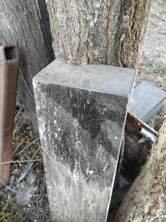

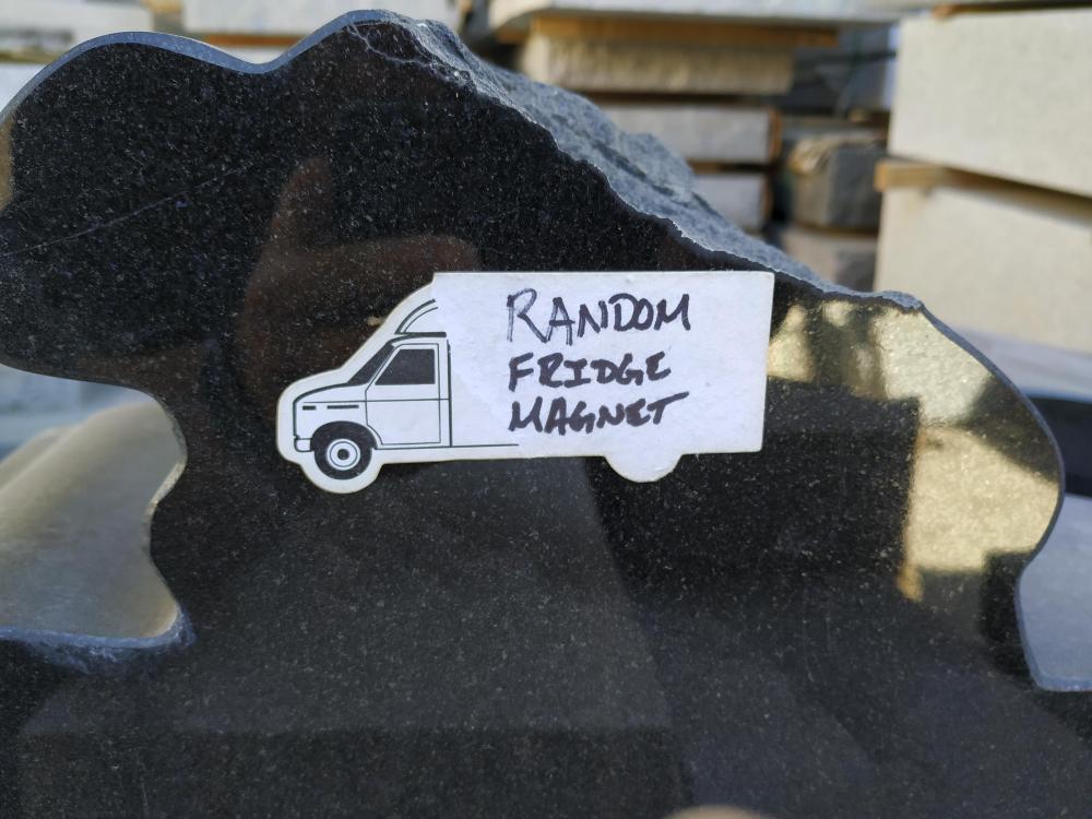

FlatLiner Posted September 26, 2018 Share Posted September 26, 2018 If your willing to try and forge on granite go to your local headstones/monument shop and ask if they have any old broken monument bases preferably in black granite (last year we threw away over 12 tons of old broken stones). The solid black is usually basalt. It has a lot of iron and magnesium in it. In fact it rings when you hit it with a hammer. You can also stick a thin fridge magnet to the polished side. Just like a hardened anvil you don't want to strike the edge with your hammer as it will flake but if you keep hot steel between the edge and your hammer you'll be fine. Here are some pics of one I might take home as a post anvil. Advertising removed Quote Link to comment Share on other sites More sharing options...

FlatLiner Posted September 27, 2018 Share Posted September 27, 2018 We give granite scraps away for free lol. That is cheeper then paying to throw them away. By the way you would be amazed by the rebound you get off granite. Quote Link to comment Share on other sites More sharing options...

FlatLiner Posted September 27, 2018 Share Posted September 27, 2018 Yes, if you have to use granite put a good pencil radius grind on the edges and it will keep the chipping and spalling down. Quote Link to comment Share on other sites More sharing options...

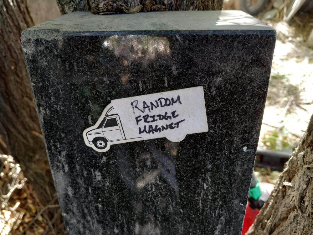

FlatLiner Posted September 27, 2018 Share Posted September 27, 2018 For those who missed the my pics that got taken down because of "advertising". Here are some that prove that there are stones that have so much iron content that a random fridge magnet will stick to them. They are hard enough to mushroom and damage hardend sledge hammer heads that are used to break these "soft" stones to pieces. Mushroom tool steel drill bits once the carbide wears out on them. These stones are plenty hard to forge on. If you have no other option they will do just fine untill you get anouther better option. Quote Link to comment Share on other sites More sharing options...
Daswulf Posted September 27, 2018 Share Posted September 27, 2018 One thing I noticed when forging on a chunk of granite was to keep the workpiece up to temp. The chunk I used was rough broken on the edges, one with cleaner and radiused edges would work better. But unless its just light planishing or correcting it's "better" to keep the steel hot. Flatliner, I have to chuckle and say I like "Random fridge magnet" lol. Thanks for sharing about the iron content in some granite, very interesting. Quote Link to comment Share on other sites More sharing options...
