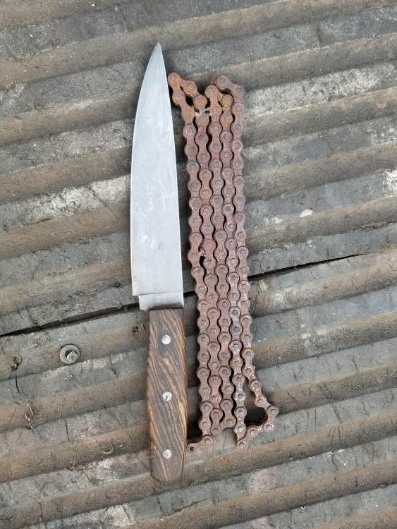

As an example here is a knife made from a bicycle chain and there was no loss (cutoffs or wasted materials) I used every inch of chain..  it is also just 1 fold as I wanted to keep the pattern as clear as possible..   The reason I am using this as an example is you can see there is little loss..
Basically all I did was remove the air spaces in the chain..

Can you please weight the knife and the chain? This will give us an idea of the upper limit of metal "efficiency" in this type of knife and proccess.
It started out at 14oz.. when done it was about4,oz..  I weighed them today but all I have is one of the vintage beam scales (not the right name for it)

Lyuv..   It's funny but when I start with a knife I always have a design in mind (everything I forge)..  I then pick the metal based on this idea..
I never account for the losses starting out as every blade is forged to as near a shape as it can be with only a little filing to get it ready for heat treat.. I completely remove all scale and divets/hammer marks before hardening as I don't use a belt grinder and once hardened it just ruins files..
The reason why I am pointing this out is i was shocked at how much lighter the blade was.. The chain has grit and rust and such but to go from basically 1lb to 4oz is a reduction of 4/1..
I never have measured for the losses.. I just account for them automatically based on experience..

I was VERY unhappy with my metal loss ratio. But seeing that even a well seasoned "old crow" has to deal with loss, is a significant confidence boost.
