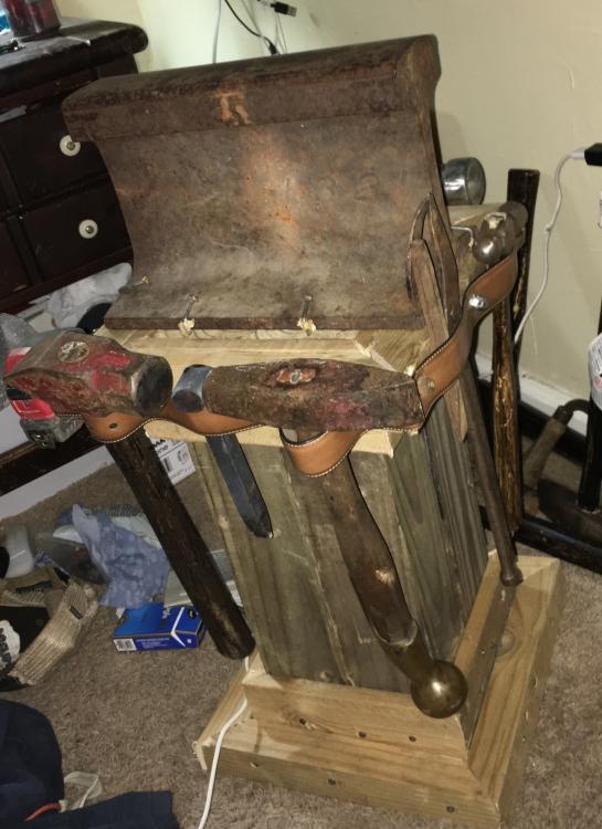

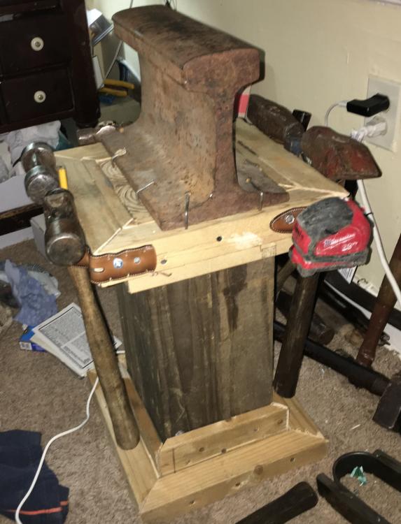

Matthew Hargis Posted May 7, 2018 Share Posted May 7, 2018 I took a couple of hours this afternoon to built a stand for my railroad track anvil. It is my first one I’ve ever built so it’s not top notch but it hasn’t fallen apart yet and it works pretty well. What do u guys think? Quote Link to comment Share on other sites More sharing options...
Charles R. Stevens Posted May 7, 2018 Share Posted May 7, 2018 I would suggest re orientating your anvil, the head up the rail is only 1 1/2” x 3” but in that orientation you have a 1 1/2” x 3” column under your hammer intend of the 7/8” web. You might look at this for inspiration. Second, are you using the hot set with the hames cap as a top tool or a hammer? As a hammer I would dress the “pein” to at least 1/2 radius as a top tool I would sharpen it Quote Link to comment Share on other sites More sharing options...
Matthew Hargis Posted May 7, 2018 Author Share Posted May 7, 2018 That one had a broken handle so I carved and sanded it down to fit in the hames handle correctly and I do plan on sharpening it and getting the rest of the rust off also. Everyone I know that sees it tried to steal it for some reason? Quote Link to comment Share on other sites More sharing options...
Charles R. Stevens Posted May 7, 2018 Share Posted May 7, 2018 Some one gets any bright ideas with my hames are going to get a rounding hammer shaped divit in their bone box... Quote Link to comment Share on other sites More sharing options...
Matthew Hargis Posted May 7, 2018 Author Share Posted May 7, 2018 The hames handle makes the hammers easier to keep a good grip Quote Link to comment Share on other sites More sharing options...

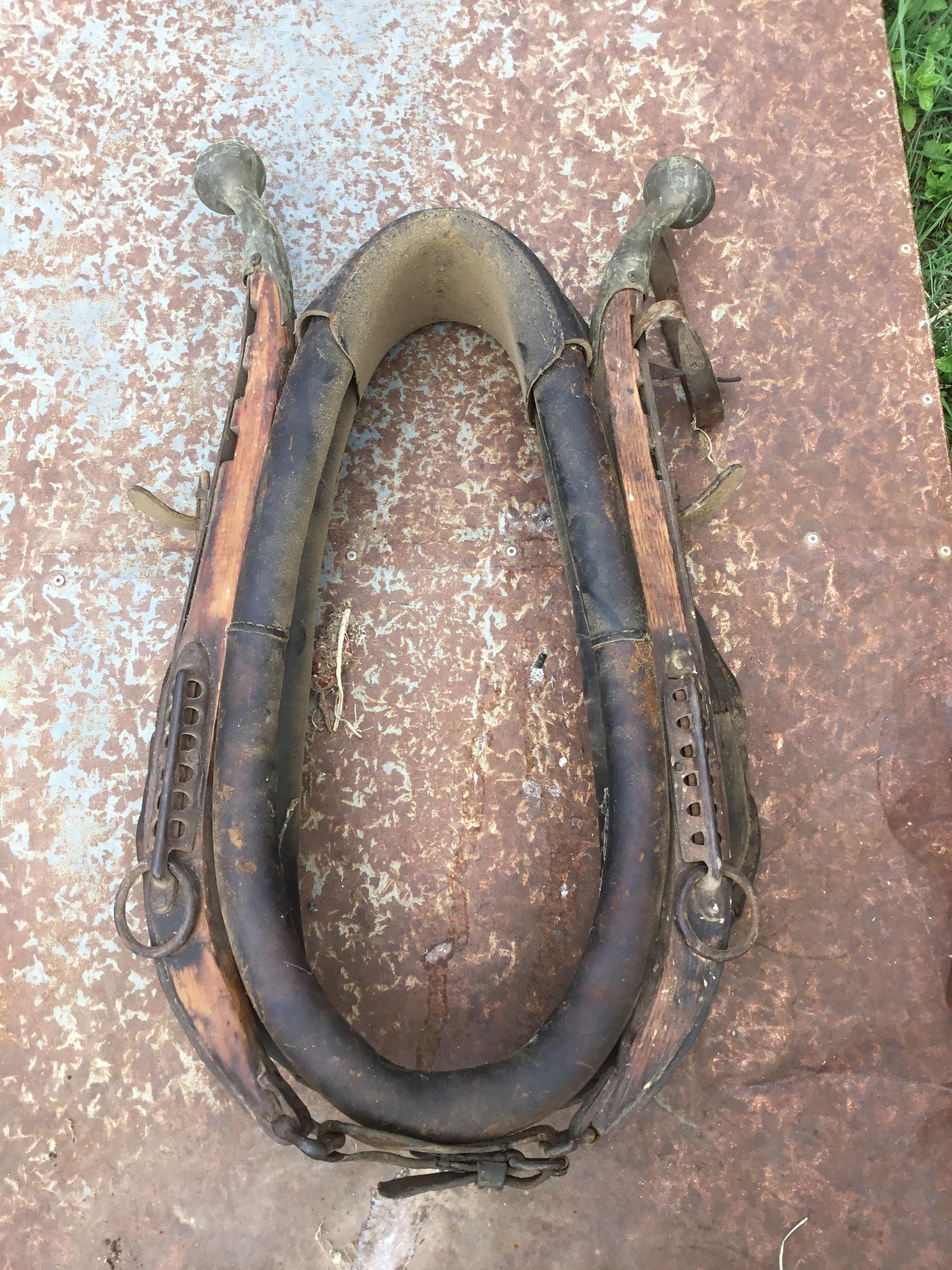

Glenn Posted May 8, 2018 Share Posted May 8, 2018 You got to remember Charles is a farrier and horse type person. He thinks in horse first, blacksmith is a second language.. I will post a reference link as Farm Hames or Pulling Hames. (It is in the Horse Stuff section of the site). Quick answer hame: Two curved pieces of iron or wood forming or attached to the collar of a draft horse, to which the traces are attached. And while we are catching up on our reading, try Snow shoes for a horse. Quote Link to comment Share on other sites More sharing options...
Charles R. Stevens Posted May 8, 2018 Share Posted May 8, 2018 Goes around a horses or mules neck and rests on his/her shoulders. When Glenn puts up his refrence I will explane how the traces atach and how the entire harness works. Quote Link to comment Share on other sites More sharing options...
ThomasPowers Posted May 8, 2018 Share Posted May 8, 2018 Part of a major change in how equines were used. Early style harnesses would choke the horse under a heavy load, the horse collar moved the load stress from the throat and you could now use them to pull a heavy plow or wagons. And let's not forget Hamish....as in "How was the poison administered Sherlock?"; "It was alimentary Watson!" Quote Link to comment Share on other sites More sharing options...
Charles R. Stevens Posted May 8, 2018 Share Posted May 8, 2018 Yes, ox style yokes are a poor match for horses, tho interesting enough you can flip a a coller and hames and use them on cattle. The Swiss coller and asiatic coller are variations. Then we get into breast coolers and saddle yokes.... As blacksmithing is a foundation technology we could end up with many more subsections descusing forging and using tools and hardware for a thousand different things. Just the steel for this set of hames (it is held on with long washer backed rivets). Quote Link to comment Share on other sites More sharing options...
