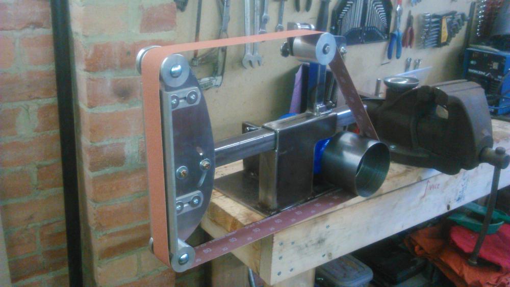

My name is Gavin and this is the first forum I've ever joined so if I'm writing the wrong thing in the wrong place it's because it's all new to me.
This is my attempt at building a 2x72 belt sander and I'm really pleased with how it's coming, however it doesn't track properly and I think it's because my tracking wheel is not crowned.
Any thoughts anyone? :rolleyes:
I'm calling BINGO! :)
Well, I THINK that's the most obvious probable tracking issue. It's the one that jumps out at me right away, could be wrong. I'm well practiced at being wrong you know. ;)
Pretty nice looking grinder you put together. What HP motor are you running in it?

With no crown, there is no way/reason that the belt will stay centered, no matter how aligned and square everything is. If your driving a straight road, and hold your steering wheel fixed straight, the car WILL eventualy stray.
You can makeshift a crown by wraping tape on the middle of the driving or tracking wheels (or both!). 1-2mm will do.

I had a tracking problem with the 2x72 I just finished building. It ran fine when not under load, but as soon as I put pressure on the belt, the belt would move off to the side. A stronger spring in the tensioning tower fixed that.

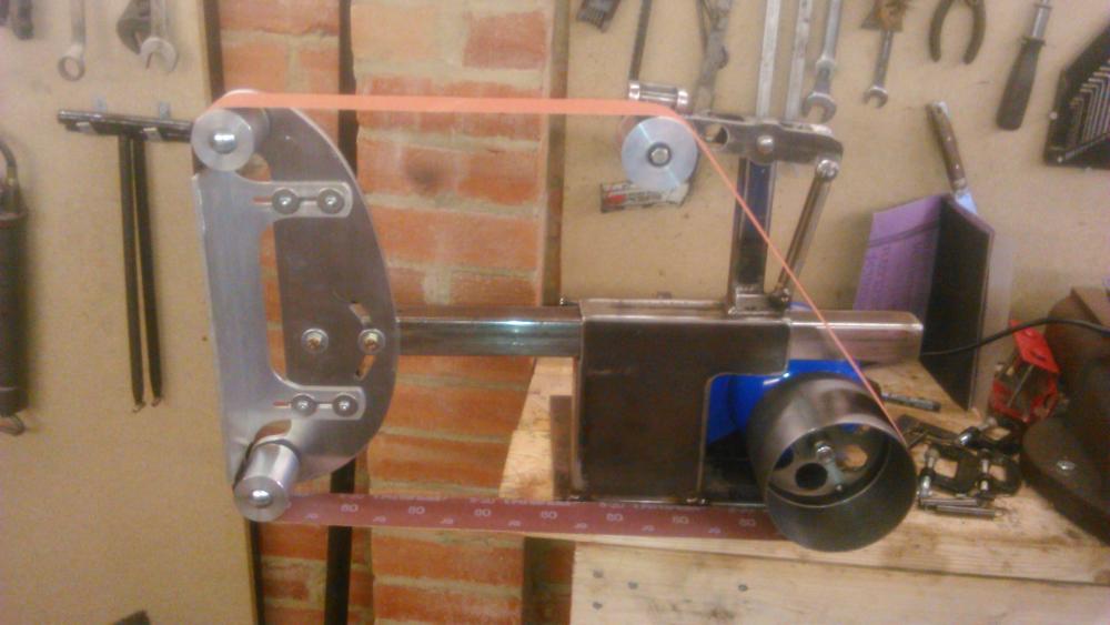

So I've just spent nearly 3 hours in the garage trying to rectify my belt tracking problems with absolutely no success at all. I tried the old making a crown with tape technique, starting with it being half a mil high, then a mil, then 1 and a half mil and finally 2 millimetres high. It never seemed to help at all.
I then tried realignment of my motor with again no improvement.

I'm starting to run out of ideas now so after work tomorrow I'm going to strip it all down to its component parts and then do a rebuild. Maybe this mite show me an obvious problem.
It's really baffling me as it's not out a little bit, it's more like 'no-where near, never eva-eva' out, if you know what I mean?

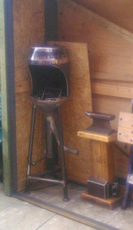

On a lighter note though here's a picture of my homemade forge and anvil
(my forge needs it's chimney attaching)
No, it's not the belts and starting over won't help. Take the tracking idler off and replace it with a crowned one. Unless you have a lathe to cut a proper crown on it?
I understand budgets but ask yourself. Is one roller worth the money and time I've invested in this already or should I just toss it ALL as a waste of time?  I don't know about you but it'd have to be a darned expensive roller for me to trash can that much of MY time.
There's a point when saving a buck costs more than just spending it. Ever hear the old saw, "Penny wise, dollar foolish." Hmmmm?

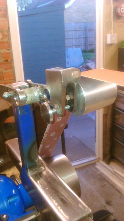

Just had a quick look at the construction, the obvious place to me, given that I can see little fine detail in the pics, if there is anyother issue to be found would be how the head arm is locked in place. Is it one screw on the top at the back? If so that proides a potential for it to become out of alignment after each adjustment. I would have opted for two screws, front and back on the side the belt is mounted firmly locating the tube againts the back wall each time in the plane that matters, it only takes the slightest degree of slogger to run a belt off.
The wheel will still need crowning either way.

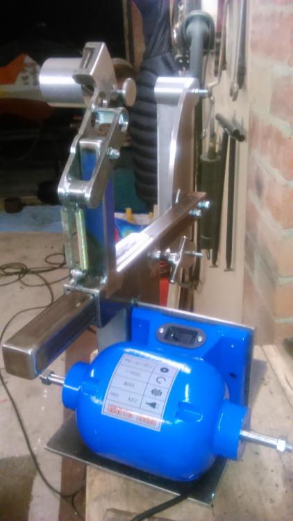

Thanks for your help and advice with my tracking troubles.
I've made my own hinge and adjustment screw to track my belts and it may be completely in-effective, i just don't know. My only reference has been what I've seen on u-tube and in pictures.
Hopefully you'll be able to see my design better in these pics.

Is It's taken me quite a bit of head scratching but I've finally identified the cause of my tracking troubles. From the way the belt was being thrown off I new it had to be more than the lack of crowns. The problem was at some point I must of banged the tracking arm what the tracking wheel bolts onto, and it was slightly twisted. Using an adjustable to get a bit of leverage, I gave it a tweek and what do you know?,  the belt stays on. It's not perfect and has a bit of a wobble however, I'm sure that with a crown or two in the right place everything will be hunky-dory.
