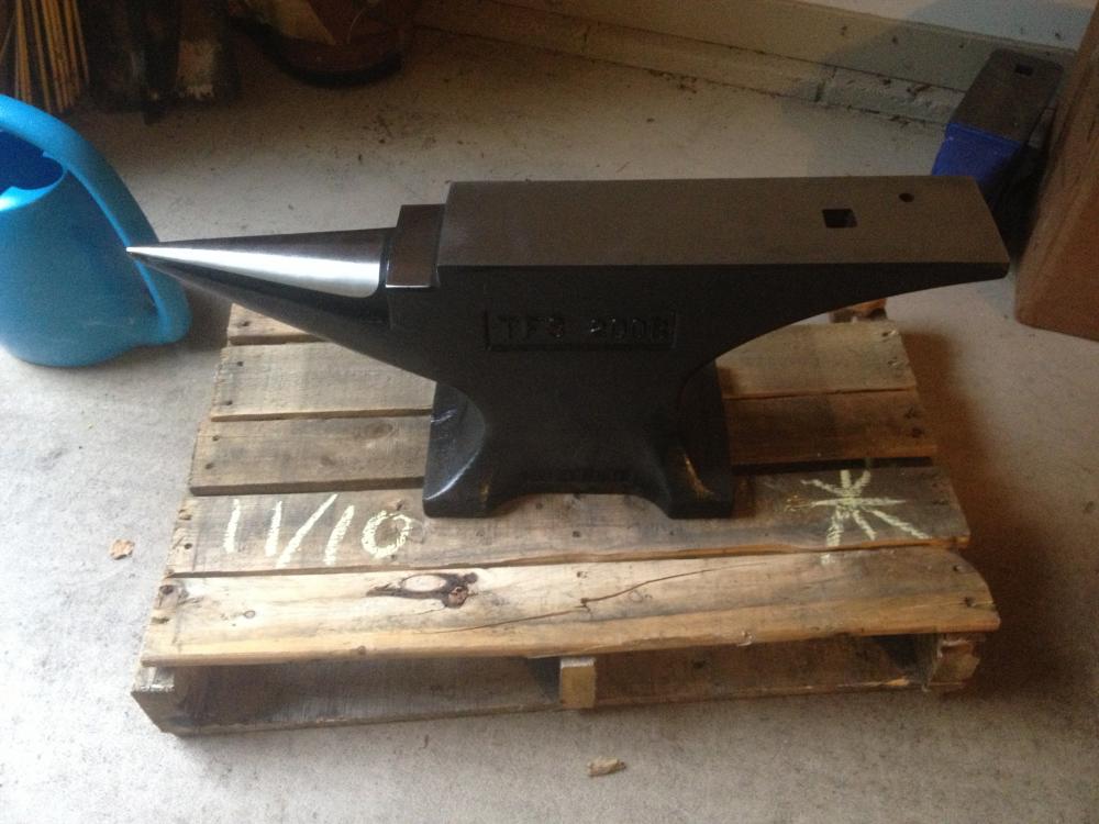

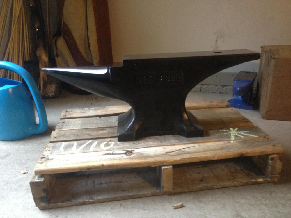

I forge on a 200# TFS blacksmiths anvil.  Works well for what I need her for.  Honestly, wish she was a bit bigger.  If you do buy one brand new it will need a light clean up and the edges will need to be radiused.
  • 11 months later...
I have a 200# TFS double horned anvil and I love it. I've been using it now for about 6 months, and it has meet all my needs and expectations. The ductile iron is plenty hard and has held up nicely. The little side table is very handy too. It's dead flat in both axis. The only thing I did was to radius the edges and remove the paint on the horn (which is useless). I also bolted it down with some silicon underneath and it is very quiet now. A very nice anvil overall and a lot cheaper than competing models.
