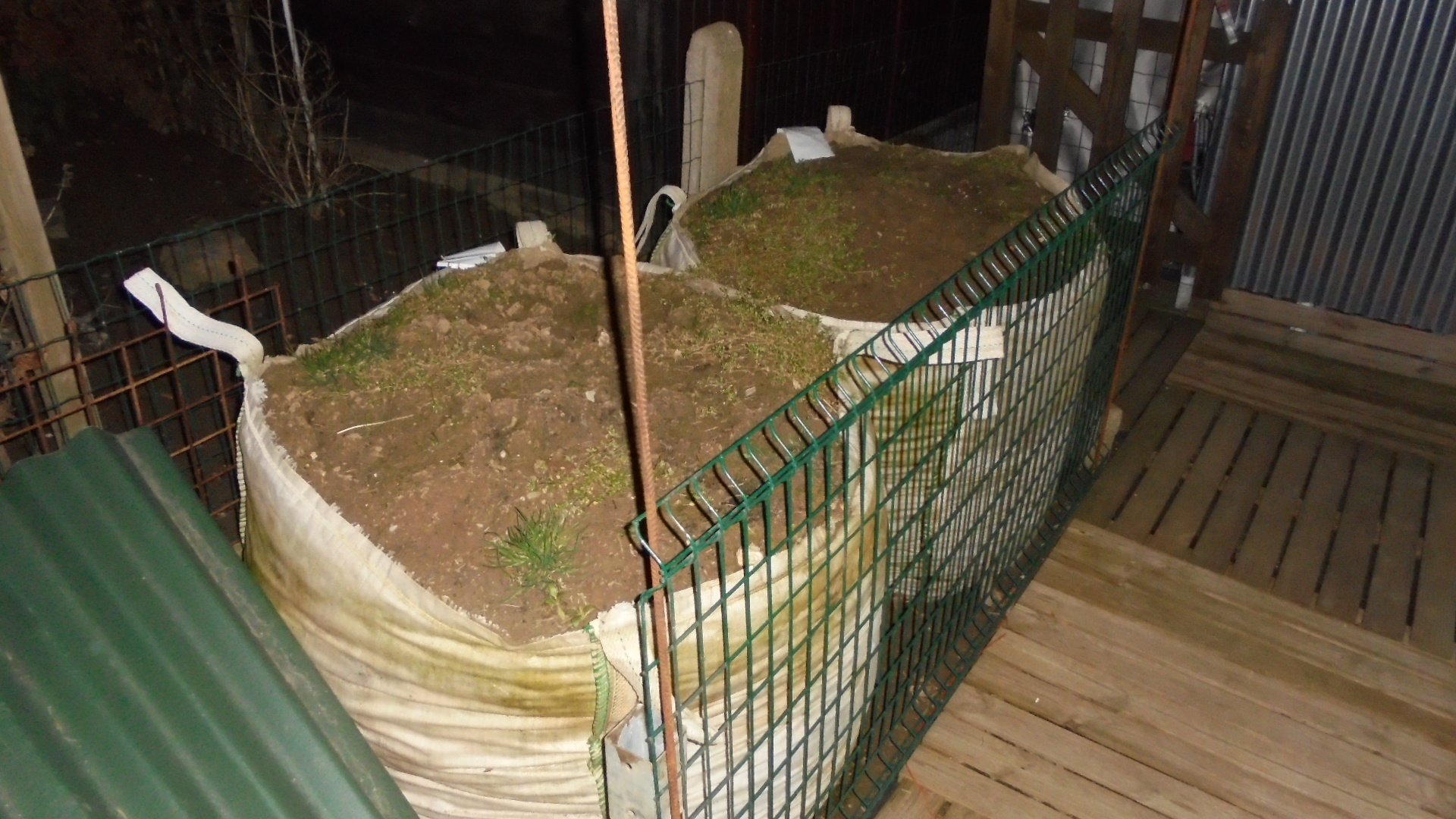

Hans Richter Posted March 20, 2018 Share Posted March 20, 2018 Free pick up 3 cubic meters (106s/ft) of solid Limburg clay , already have a third spread over Dianas vegetable garden. This is a fraction on the ground that I had to squat to make room for the foundations of the new workshop and the other levels on the ground floor under the canopy of the protected foundry and open-air smithy. Sometimes you have to dig and move the necessary soil for a good work floor level. Dig on, en forge beautiful things, Der Hans Quote Link to comment Share on other sites More sharing options...
