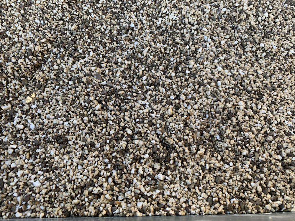

Frosty, the cat litter claimed 100% clay. It’s the Special Kitty brand. Perlite was used more for weight reduction. The forge is currently portable. I modified the legs and installed equipment leveling casters with ratcheting levelers. When I had sand in it, the forge was very heavy. This is much lighter and I am fairly confident it won’t transfer heat nearly as much as sand turning to glass. I have have some projects that have high clayey soils which require removal and export prior to building. Some are moderate to highly expansive, some aren’t. Do you think this type of clayey soil would be a good hearth lining material? Perhaps as a binder with the silica free sand you mentioned? Is the silica free sand a fine sand or a bit more coarse? I’m relatively pleased with how this thing is curing. I’ve kept a radiant heater under the forge to keep the hearth bottom warm. Very minimal shrinking and I’m going to put the final high temp mortar coating on the fire pot after more cure time - no perlite in it though. Probably another week of curing before doing this.

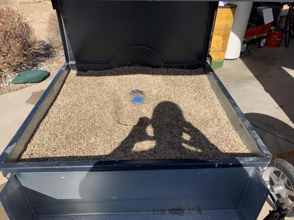

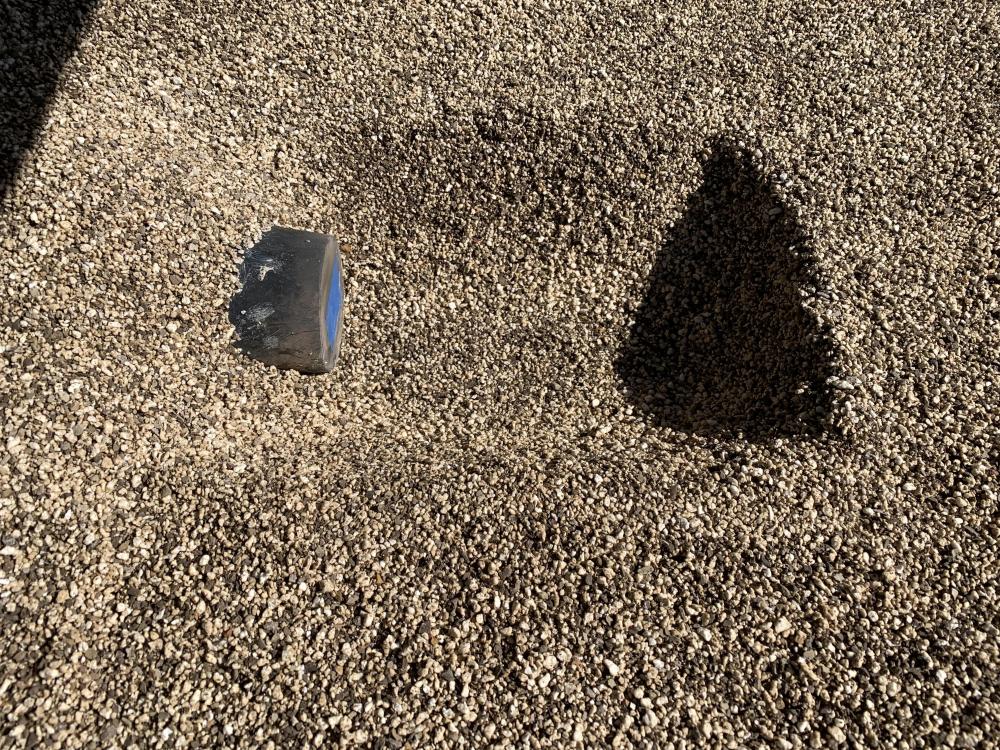

I tried sand before and it turned to glass. The bottom of the forge got very, very hot with with sand, hence the start of this thread. I did what was advised and it dried as pictured, loose. I could not get the cat litter clay to bind. I soaked the litter in a wheelbarrow with water in it. There’s no mud.

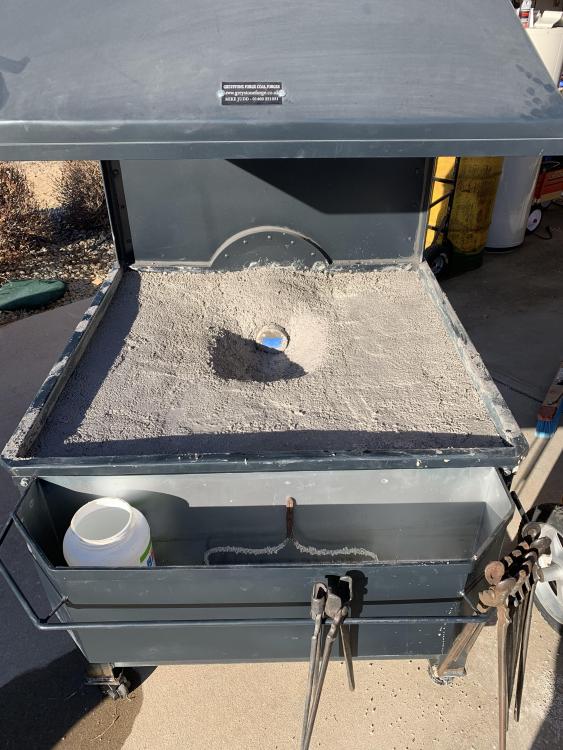

Cat litter was 100% clay. I pulled it all out and mixed the perlite/cat litter mix with some high temp cement as a binder. What you see on the top is the high temp with perlite in it.

Here is where we wound up when we ran out of cat litter. I don’t see how the cat litter provides much binding, even when wet. I’m half tempted to finish all of this off (cap this) with the high temp cement mixed with perlite. Or, I’ll pull out half of what we just did, mix in cement, form, then mix cement into what I pulled out and put it back in, then final form. I guarantee that will bind.

I’m not following you... I was going to do the clay/perlite slurry mix and form the hearth, but in the fire pot, leave it 2” lower than desired and place high temp concrete 2” thick for the bottom of the firepot.

Finally received all of the perlite, got the all clay cat litter, got cast in place 3,000°F concrete and emptied the forge. Tackling the perlite clay fill today.

Finally got a return phone call from the nursery. Perlite should be here tomorrow or Monday. It’s 1/4 the cost buying in bulk. Worth the wait! JHCC, I’ve moved it as full as pictured.

Found the perlite, but it is horticulture grade. Everything I’ve read, the horticulture grade is much more available and folks use it in their refractories and furnaces anyway. I’m going to go grab around 8-10 cubic feet of this stuff, along with some fire brick and clay cat litter and get this thing tuned up finally.

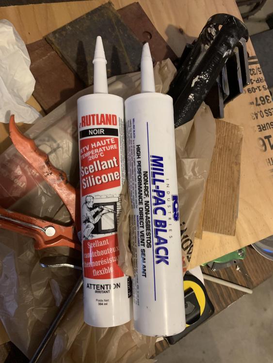

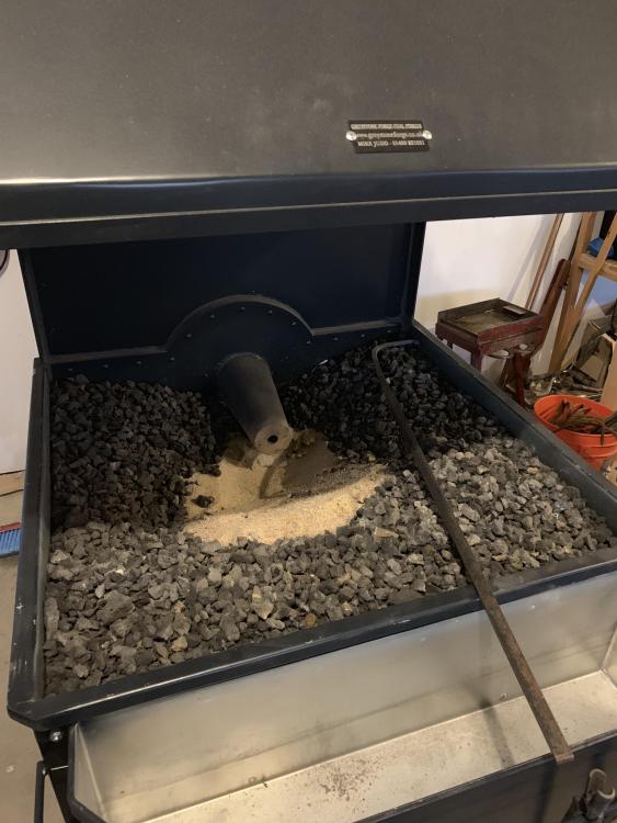

3.5” from bottom of tuyere to the steel pan. 4.75” from the bottom of the hole in the tuyere to the steel pan. The hole is 1” in diameter. Not to sound like a complete donkey here, but there is a 0.00% chance of relocating the tuyere. There’s 1.5” between the underside of the pan and the blower motor housing. Here’s a pic of the sand moved away. (Please ignore the fail of a coal rake that burned up a bit.) It’s “tube sand” not “building sand.” By building sand, do you mean fill dirt? I posted a pic of some caulking I used on this thing. I pulled out the junk white silicone that wasn’t doing anything and used that Mill-PAC Black instead. I’ve yet to refinish the outside part with the Rutland stuff. The white silicone that was painted black isn’t really doing anything there either. I figured properly applied high temp black silicone would be better. I’d like to make this lighter if at all possible. I have around 150# of sand and 150# of coke in there. If fire brick is the way to go, I’m game. Do I set it in a bed of sand as well as sand over the brick? Ditch the tube sand and go grab some fill dirt on one of my construction sites? Is the plate of glass normal? Do we just leave it in there and roll with it?

Forgot to mention. The picture with just sand in it, we actually took out around 100# of that sand and replaced it with a bunch of ash. It was quite a bit lower than what's pictured. We did that because of what Greystone Forge displays on their website. Basically it looks like he has only a couple of inches of sand in the box, then fills it with coke. EverythingMac mentioned something turning into glass, then ash? Is that refractory sand or cement he spread around there? Does anyone run Inswool then coat it with a refractory cement or the like?

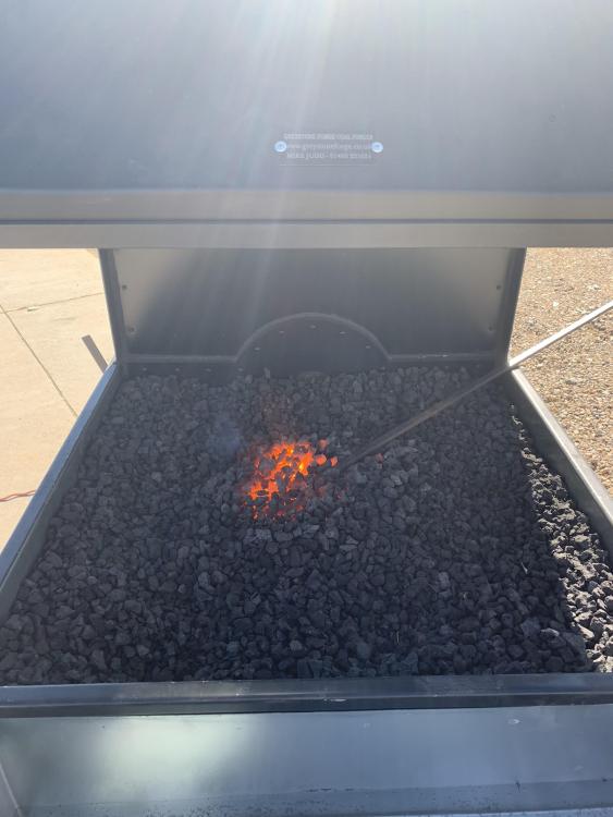

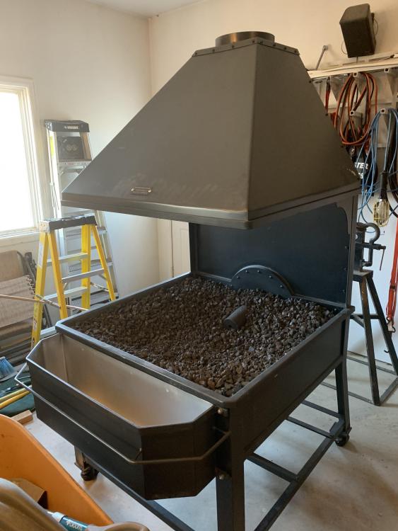

It's getting hot enough to start sagging. There's only one small angle iron under the pan, centered. That angle looked like it was sagging when hot. I don't mind doing some structural reinforcing, but would like to reflect the heat upward if possible. I have a small fortune invested into this piece of equipment... Perhaps I'm overreacting because of it.
1m X 1m Side Blast
Yeah, the whole turning sand into glass thing really got me thinking this could actually melt through the pan unless I come up with something a bit more than just sand and ash. Perhaps Inswool coated with Bubble Alumina? Yes, bosh in lieu of tank.

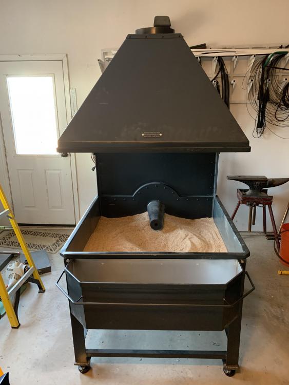

I finally got my wife a forge. It’s a 1m square Greystone Forge sideblast. We are running coke in it. I really had no clue what to expect. We are much more familiar with a gas forge, but my wife has wanted one of these coke forges as long as I’ve known her. These solid fuel forges heat steel FAST. Getting this thing and then modifying it to make it work with our setup was quite a task. First I tried to get the next size smaller, but the shipper absolutely destroyed it. Then the importer decided to stop importing these things, so he gave me a great deal on the 1m square one, the only one left. It arrived unscathed. I needed to have this thing mobile. I know that sounds crazy, but I am currently wheeling it in and out of our garage. It’s 6’-8” tall. I had to shave the legs down from the bottom 2” and re-weld the feet back. I installed stud mount ratcheting equipment moving leveling casters on the feet. It raised the forge 1” from where it originally was, so 6’-9” tall now! The equipment casters are awesome. It moves like butter. For lining the pan, I put a couple of inches of sand and ash in as an insulator. The bottom definitely got hot when running it today. I think the blower is so powerful, it creates a divot in the sand when blasting the coke. We pulled out a clinker the size of a small dinner plate that was as brittle as glass and a glob of a clinker over it. The water in the tank gets a lot hotter than I thought it would as well. It boiled slightly. What do you recommend lining the bottom of this forge with? Refractory cement or a combination of that and brick? How close to the conical tuyere should I get with the cement/bricks? Should I line the entire 1m square pan or just an area in front of the tuyere where the forging predominantly takes place? I have a bunch of questions, but I’ll search a bit more prior to asking.
