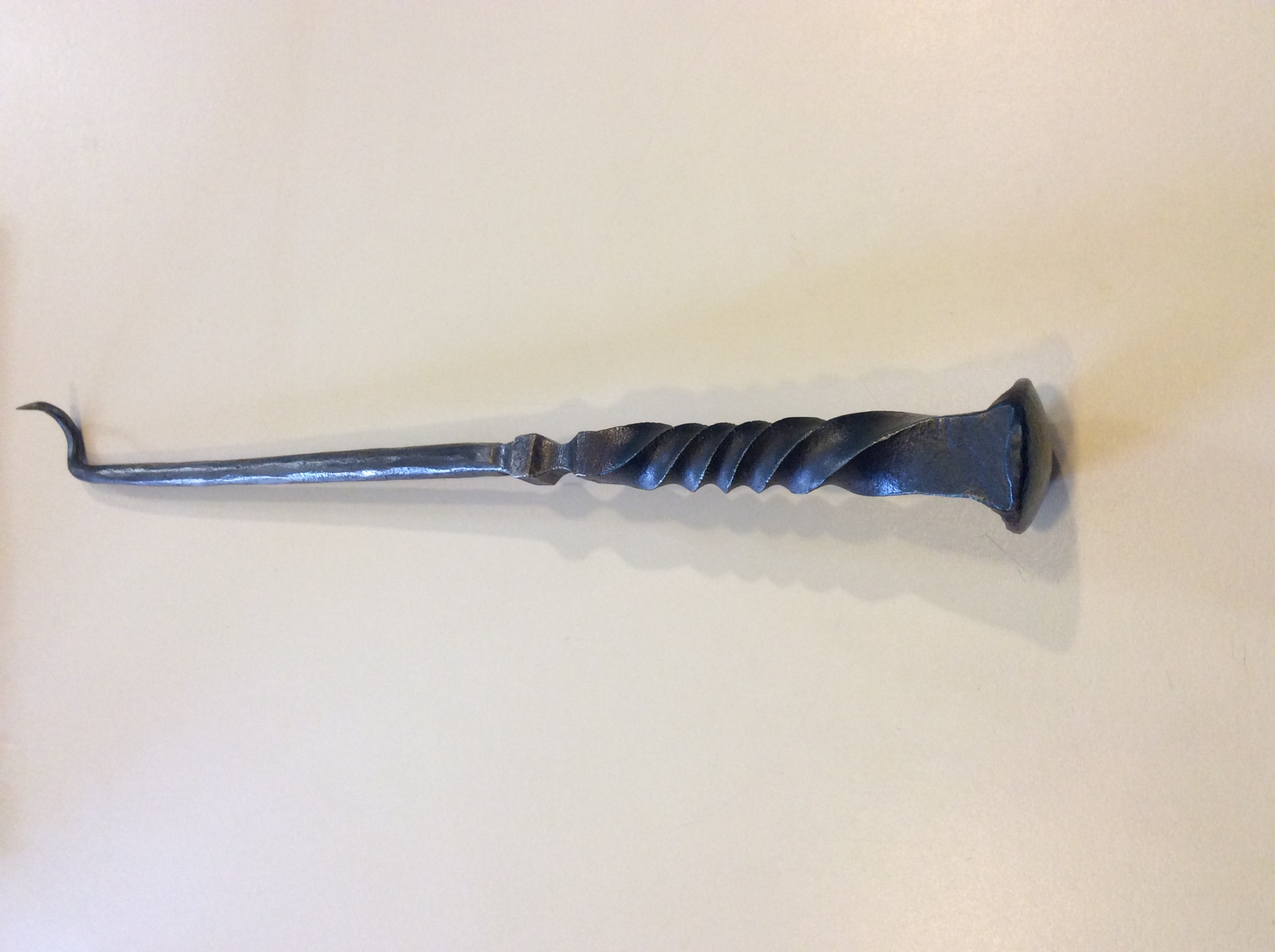

MotoMike Posted March 12, 2018 Share Posted March 12, 2018 Rail spike steak turner. More work than I thought it would be. Quote Link to comment Share on other sites More sharing options...
Irondragon Forge ClayWorks Posted March 12, 2018 Share Posted March 12, 2018 Without a power hammer it takes a while to draw a spike out that far, still worth it though especially the good job you did. Quote Link to comment Share on other sites More sharing options...
MotoMike Posted March 12, 2018 Author Share Posted March 12, 2018 Thanks Irondragon. I think I have an hour and a half in that thing. started with a 4 pounder and once broken down a bit switched to my 2.25 rounding hammer. I suppose it is worth it for the experience, but wondering if people would pay what I need to make it worth the effort. It was fun though. Do you know if linseed oil can be used on items that will be in contact with food? Or should I use something like canola? Quote Link to comment Share on other sites More sharing options...

Frozenforge Posted March 13, 2018 Share Posted March 13, 2018 It does take alot of effort to draw that far out and maintain a consistant taper! Quote Link to comment Share on other sites More sharing options...
MotoMike Posted March 13, 2018 Author Share Posted March 13, 2018 Frozenforge - I think I got it pretty good. but as you say, a lot of work. funny thing about the rail spike. It must connect with people as I've posted several things on the blacksmithing for beginners site before and got 6-10 replys. this steak turner is at 155 and counting. surprised me. Quote Link to comment Share on other sites More sharing options...

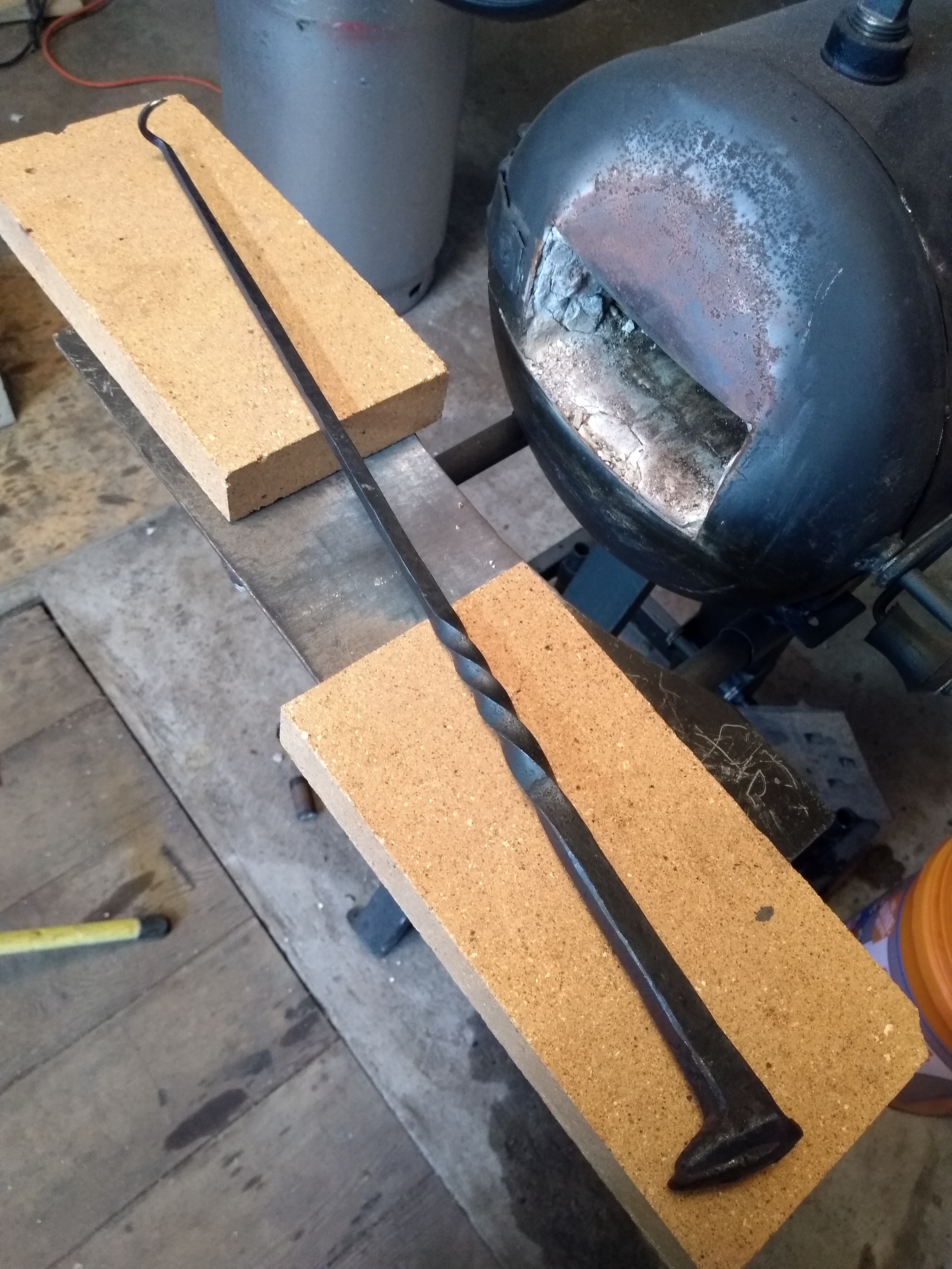

Frozenforge Posted March 13, 2018 Share Posted March 13, 2018 Stuff made from rail spikes do seem to connect with alot of people. I’ve done both round and square drawn steak flippers. The round take a little more finese. This is a shorter one for the camper. Quote Link to comment Share on other sites More sharing options...
Anachronist58 Posted March 13, 2018 Share Posted March 13, 2018 11 hours ago, MotoMike said: More work than I thought it would be. It is Gorgeous, and a few other "ous's", like Sumptuous. You are not likely to fetch what it is worth, because few, save those above, who know what went into it, can appreciate it. Bravo. Robert Taylor. Quote Link to comment Share on other sites More sharing options...
