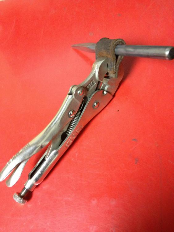

Jim Coke Posted March 9, 2018 Share Posted March 9, 2018 Greetings Windancer, The simple answer is use a leather chunk with the pictured vise grip to hold and turn your chisel. I have used this tool for treadle hammer work for years and it works great... I also have a fixture that I use in my fly press which accepts 401 air chisel bits . Works super there too,, Give it a try. Forge on and make beautiful things Jim Quote Link to comment Share on other sites More sharing options...

jeffery71 Posted March 9, 2018 Share Posted March 9, 2018 I've done the Vise grip trick as shown above.. Also made a handle out of a shaft collar welded to a round rod.. I think the Vise grip is better and actually easier to adjust. If you find you like the air chisel.. You might want to get a rivet gun. They have a "feather trigger" and you can control how hard/fast you hit with them. Jeff Tice Quote Link to comment Share on other sites More sharing options...

Jim Coke Posted March 9, 2018 Share Posted March 9, 2018 Greetings JHCC, It will work the best with a 7LW Vise Grip.The jaws are off set at the right angle and it will pinch the leather better. Forge on and make beautiful things Jim Quote Link to comment Share on other sites More sharing options...

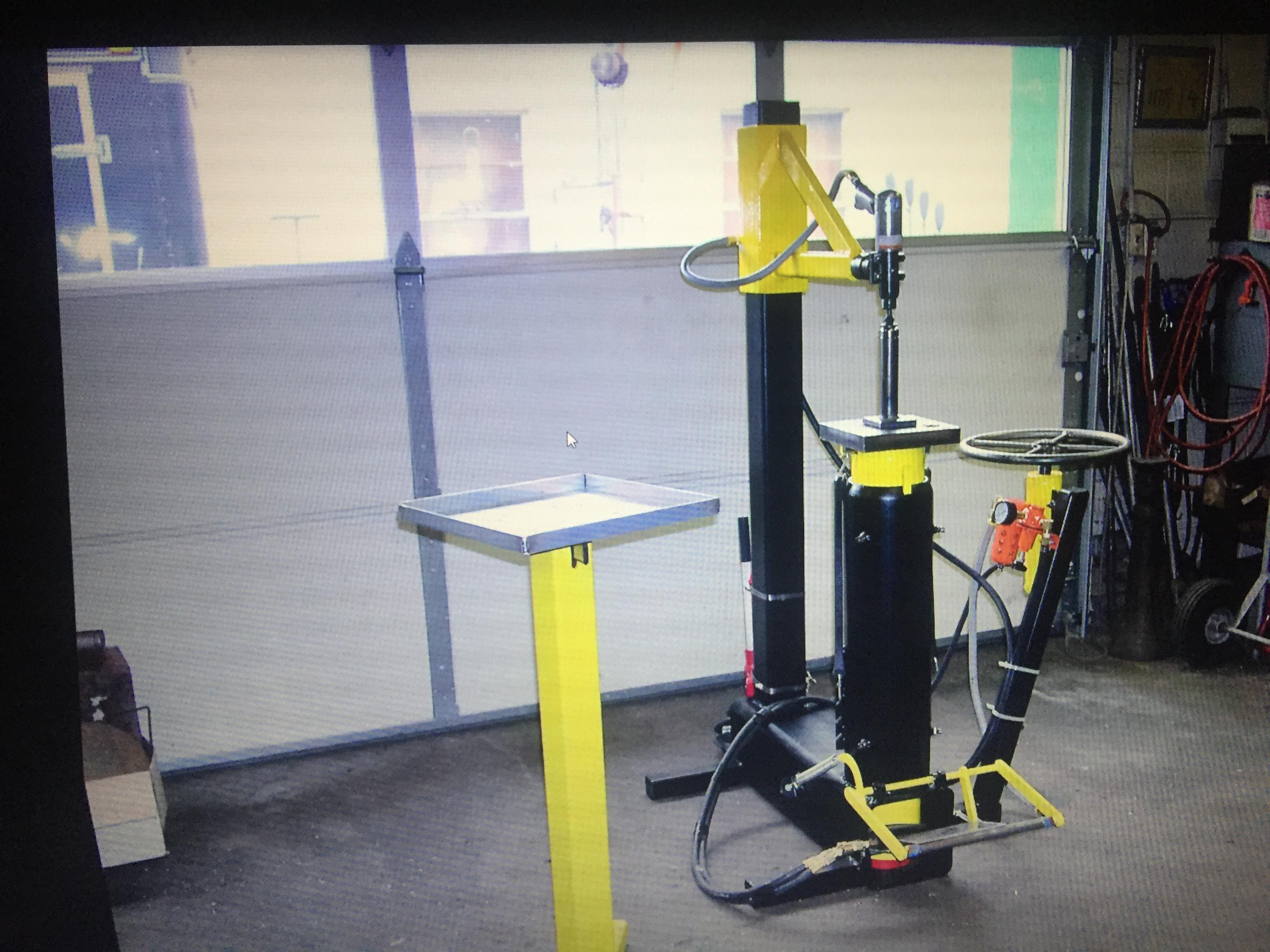

Jim Coke Posted June 26, 2018 Share Posted June 26, 2018 Greetings Dave, Yep me again... I did a lot of chase and repousse work .. I designed a special machine that works great. The air hammer is rigid mounted but the work table is hydraulic and movable by the foot pedal. I can control the chisel depth and air hammer speed at the same time.. The big wheel adjust the table up and down 6 inches and the foot pedal dual control 1/2 inch. I have also a old air hammer part set up to use chisels in my fly press that accepts air chisels. Lots of tools for different applications. The nice part is adjustable depth for different base media. Forge on and make beautiful things Jim Quote Link to comment Share on other sites More sharing options...

Jim Coke Posted June 27, 2018 Share Posted June 27, 2018 Greetings Dave, My set ups are different. If you are going to use the HF planishing hammer I would first suggest an in line foot control air switch. To stop the chisels from turning I would make a steady hold for vise grip and use the leather to hold the chisel from turning. You can grind the chisel square under the leather contact point and for sure it won’t rotate. I hope this helps . Forge on and make beautiful things Jim Quote Link to comment Share on other sites More sharing options...
