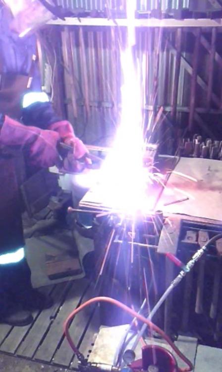

Hans Richter Posted February 20, 2018 Share Posted February 20, 2018 Welcome Jill, please see the Example Kiln both the ingot moulds on top of the melting furnace before casting (bronze). However, during pouring there was still a drop of water in between the welding joints. Glad to wear the complete ‘Mounty’ of PPE’s while the hydrogen explosion. My brother in law made by casualty a video from a safe distance where the screenshots from below. This can happen with all liquid metals, so if you start melting and casting take care of proper and complete PPE and know what you are doing. Quote Link to comment Share on other sites More sharing options...
