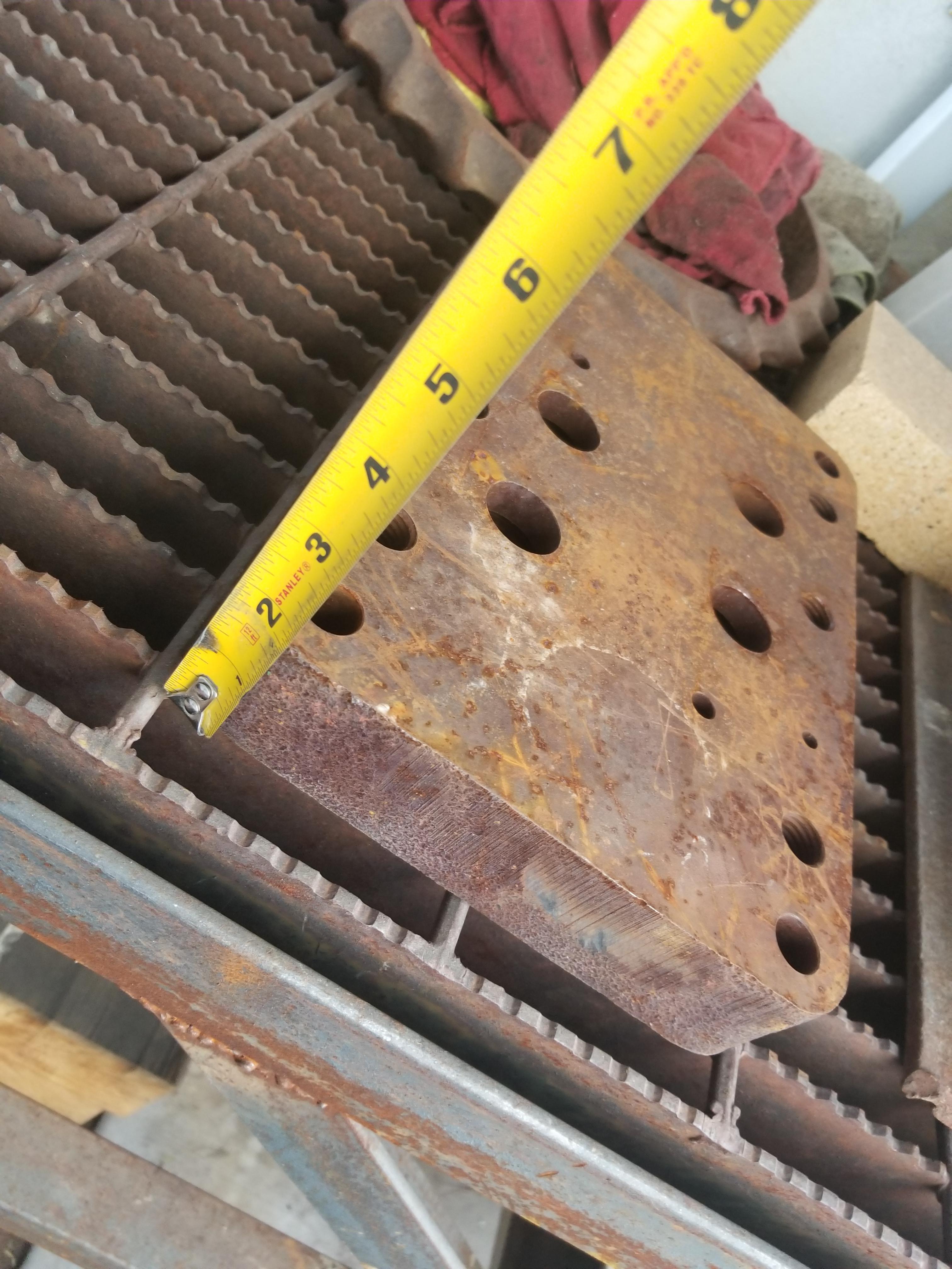

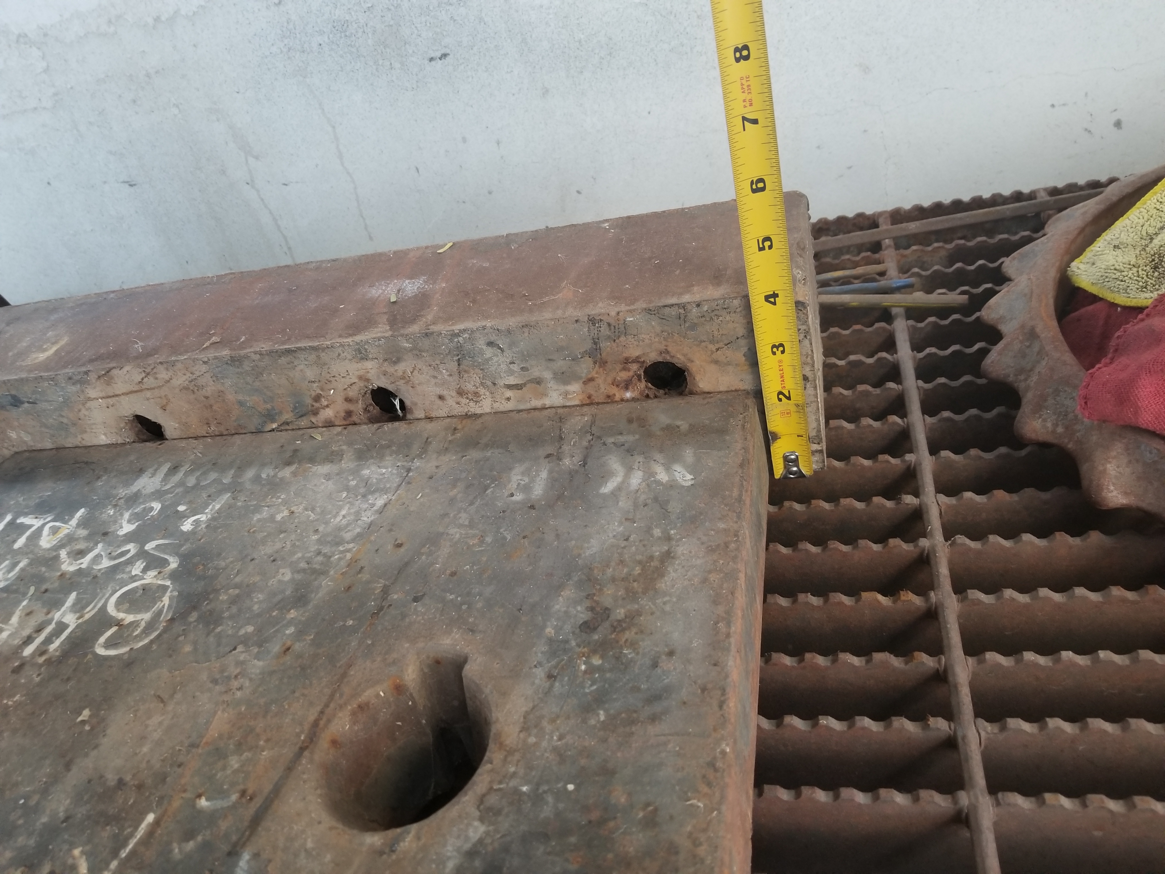

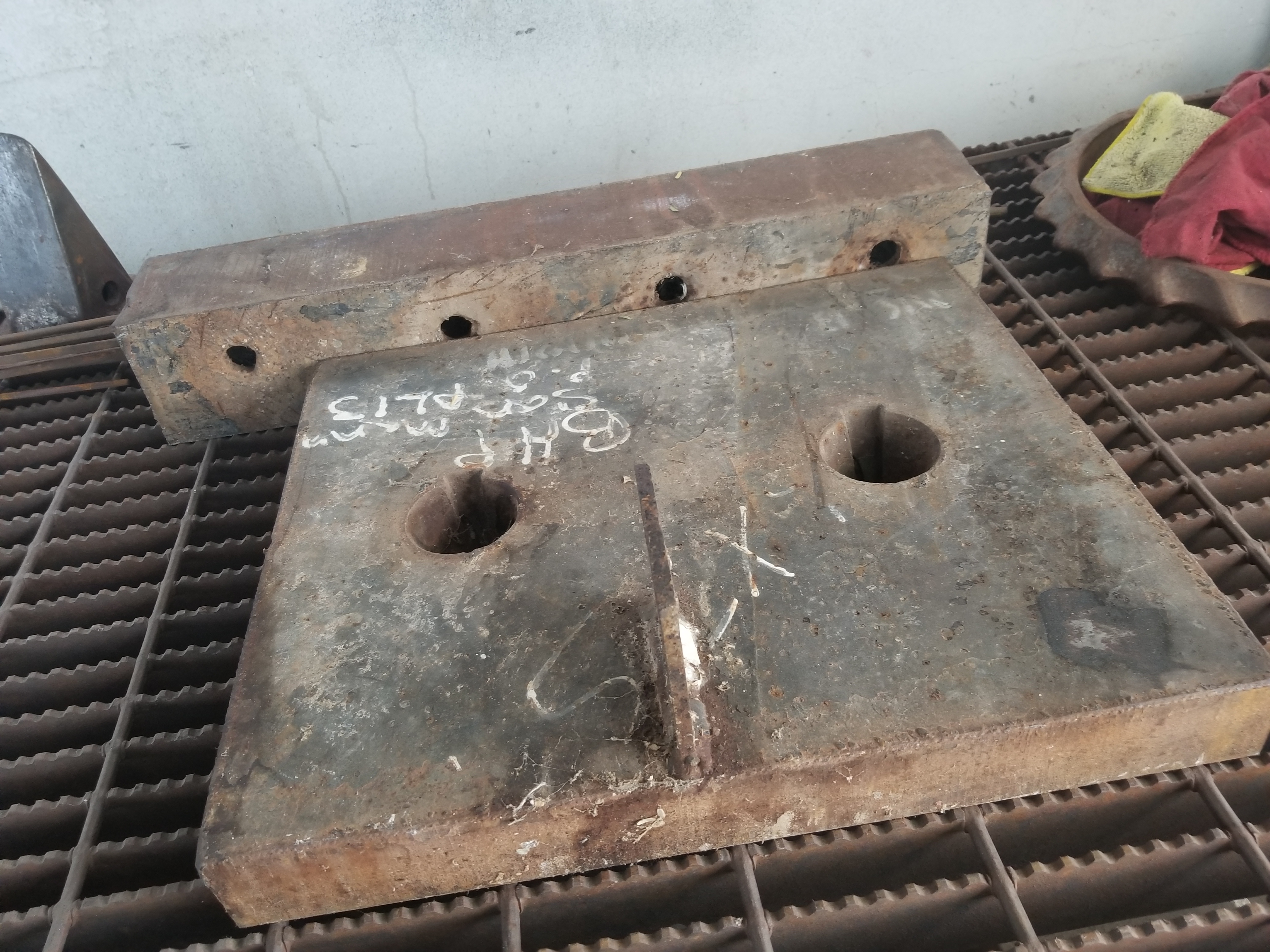

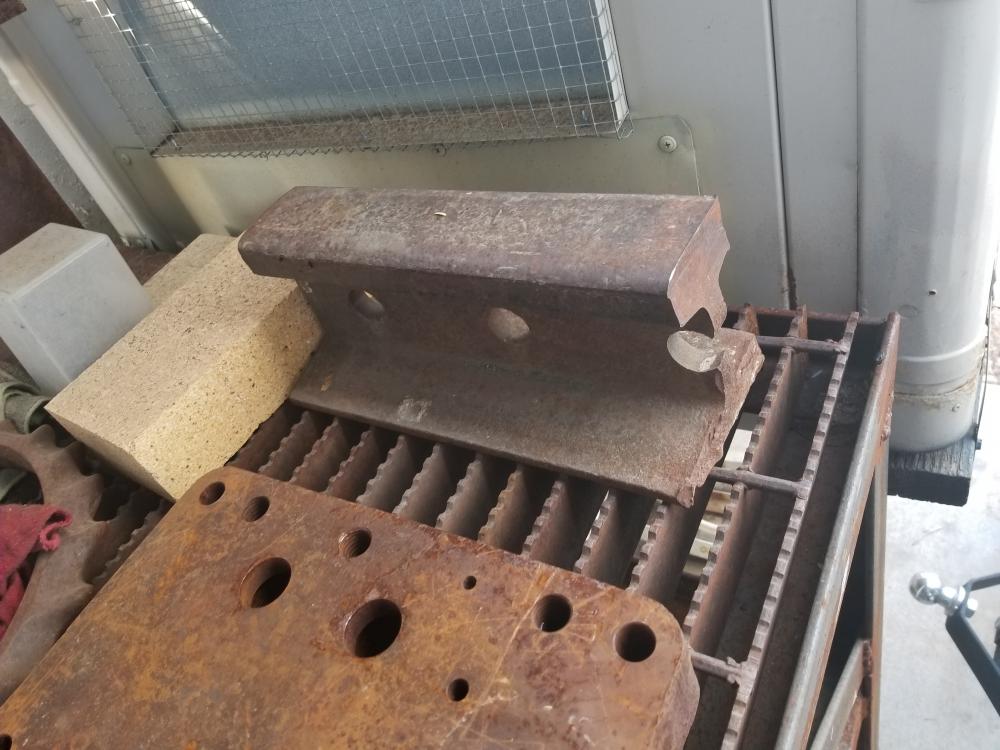

bigb Posted January 18, 2018 Author Share Posted January 18, 2018 OK getting ready to make monkey tools and rivet blocks. I have some nice 1" round stock for the monkey tools. I watched a couple videos on making rivet blocks, but I noticed the small rivet blocks that you lay on the anvil tend to bounce around and make it hard to work. I have several large, heavy chunks of steel and I was thinking of using one for a rivet block. I could start the depressions with a drill and finish shaping them with a round die. Alternately I could spot heat the area with OA and hammer a ball bearing, or a rivet head into it for shaping. I guess it would be sort of a poor man's swage block? Does this sound like a good plan? Quote Link to comment Share on other sites More sharing options...

bigb Posted January 19, 2018 Author Share Posted January 19, 2018 Thomas what do you think about making my backing blocks out of the heavy steel pictured? My other thought was making blocks that fit in the hardie hole. PS went thru Socorro two days after Christmas but was recovering from either food poisoning or stomach flu and would not have made a good visitor. We were disappointed to see Smith's closed up but I suppose Walmart put them out of business. Quote Link to comment Share on other sites More sharing options...

bigb Posted January 20, 2018 Author Share Posted January 20, 2018 My questions were not even about making rivets, they were about making tools to set rivets. Please read post #6 and tell me what you think about making rivet blocks for backing up the rivets out of the materials I posted. Neatguy's machinery looks awesome but I am just a hobbyist and there is no way I will ever have that expensive machinery for a few rivets now and then. I have been buying rivets off ebay for the past week and I have several hundred now. Probably enough to last me for years. The only rivets I might try to make are some soft copper ones after Redsmith's suggestion, I have a lot of copper on hand and might make some just for the fun of it. I just want to be able to set a few rivets now and then, by hand. I am working on some tongs right now so that will be my first rivet. Quote Link to comment Share on other sites More sharing options...
