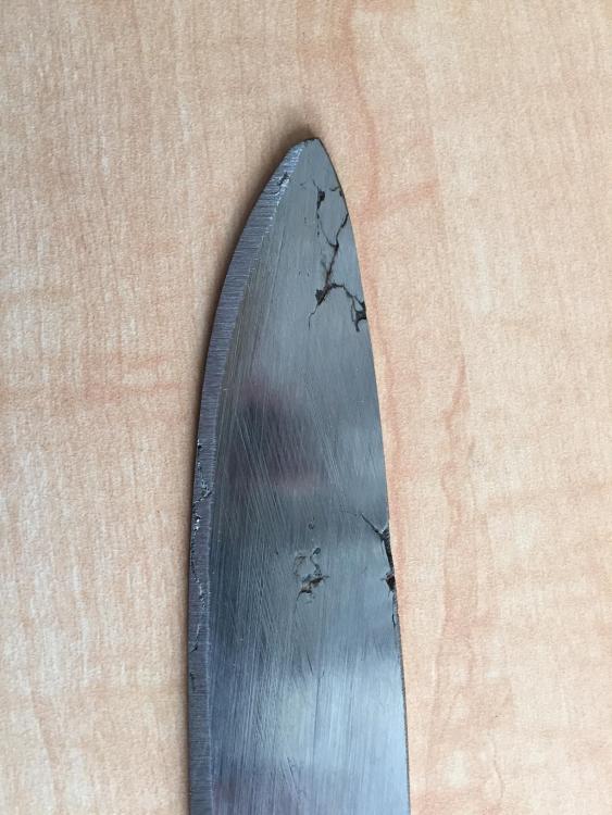

lyuv Posted December 19, 2017 Share Posted December 19, 2017 Hi all, This is a blade in work. Made of chainsaw blade and air. The chain was forge welded into a billet. Streched and folded once. Apperently, I have cracks issue. I guess it's bad welds. For various reasons, I REALY want to salvage this blade. I was thinking of filling the cracks with silver solder. What do you say? Did anyone try this? I know that generaly, metal to be soldered/brazed, need to be clean. There is no way to clean oxidation from inside these cracks. Is that a deal breaker? Any ideas or pointers? (just a note - the cracks penetrate no more than half way through the blade's thickness) Thanks, Quote Link to comment Share on other sites More sharing options...
bigfootnampa Posted December 19, 2017 Share Posted December 19, 2017 They MUST be ground away! Solder is NOT OKAY for this type use! Whatever “various reasons” you have... put them aside and either grind these defects off or start anew! You’ll be glad that you did. I just noticed... you have some serious cracks showing at the spine of the blade as well! They are almost clear through! This is not salvageable unless you can shorten the blade enough to clear away the defects! Quote Link to comment Share on other sites More sharing options...
Steve Sells Posted December 19, 2017 Share Posted December 19, 2017 I am sure its too late to close and reweld, this is a major problem of jumping into the deep end, not enough experience to know a problem until it is too late. Sorry Try grinding it out into a smaller blade Quote Link to comment Share on other sites More sharing options...

Will W. Posted December 19, 2017 Share Posted December 19, 2017 Everybody else pretty much covered it. But if you insist on doing damascus, then maybe start with the simpler processes, like a stack of pieces, rather than something genuinly difficult to weld like a chain. Quote Link to comment Share on other sites More sharing options...
