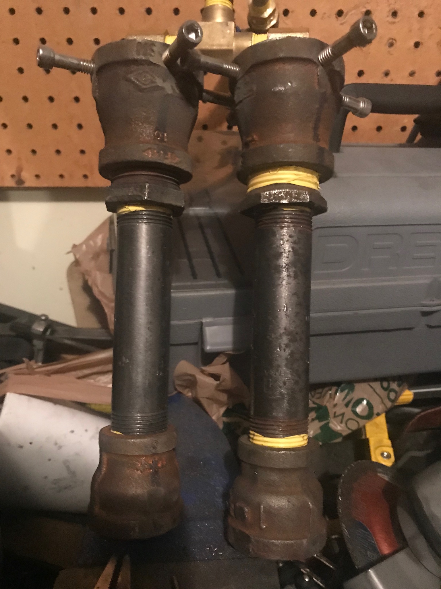

I have struggled with finding the right burner design. I had settled on the burner design attached, until I saw a burner design by Mike on this forum. I will reduce the nipple toward the burner end to ~6-8”. I welcome any feedback on simplifying the plan for the burner design. I have listed a small incomplete calculation that shows the volume of the cylinder less the volume of a firebrick (there is some additional space that will be filled in), but based on just those areas, I know I am below 700 cubic inches. Based on what I have heard and read, a 3/4” burner will heat up to 350 cubic inches of a forge to welding temperatures or above. I knew I would be north of 350 so I had to go to 2 burners and I wanted to ensure I was south of 700. Based on my burner image, I may be overkill on my design. I planned this prior to today when I found this forum and I will definitely incorporate some of the things I have seen here for the burner. But I will take any input on the burner as well.

About the burners. As drawn it looks like you're using T burners, they're easy to build and tune, the plans are available here, ask me if you have problems. Mike Porter burners are no question more efficient but they're more demanding to build. Check out his plans and make your decision based on how good YOUR shop skills are.

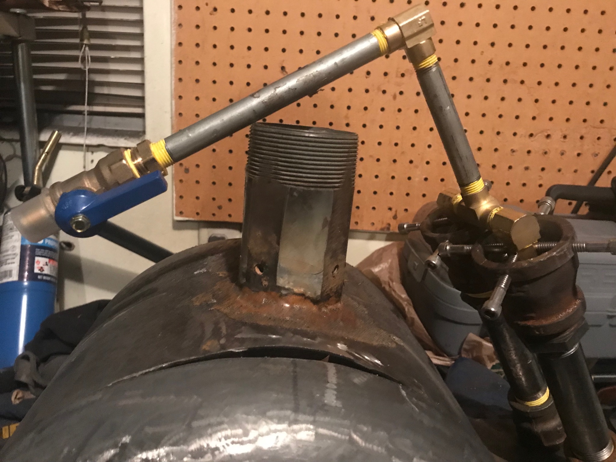

Lose all that plumbing on top of your burners all those long pieces of plumbing make your burners very vulnerable to bending and breaking. Long lengths mean lots of leverage so WHEN someone trips over or something drops on the hose something WILL give. If you're lucky it'll just knock your jets out of alignment ad you'll be shut down till you get them straightened out again. Done this one, got T shirts.:( The worse bad thing is breaking a fitting in which case you now have an uncontrolled blast of propane shooting Probably at the outside of your forge.
I put a 1/4 turn ball valve directly after the regulator on my propane tank I run a 100 lb. tank, 20 lb tanks tend to freeze quickly running ONE 3/4" burner let alone two. The 1/4 turn valve is your FAST shut off, in an emergency turning the tank valve off takes too long. The hose then runs to a manifold at the forge, I put it away from or below the forge itself to protect the RUBBER hose from excess heat. The tank, hose and manifold are on a side of the hose nobody has any need to or interest in going to keep folks from tripping o the hose or setting stuff near it. The manifold is just 3/8" pipe nipple, the female fitting on American made propane hoses is 3/8" pipe so you don't need an adapter. The 3/8" manifold has enough volume to provide all the fuel two or even four burners need at working psi. With a 2 burner system you could just use a short 3/8" nipple to a T, then to adapters to the copper tubing but I like a little volume to equalize psi to the burners, I may change that opinion as I reduce the number of burners in my shop forge.  My personal preference for the final gas supply is through 1/4" copper tubing. Use FLARE fittings to adapt from plumbing to copper! NOT the other type, don't let the guy at the plumbing supply talk you into something else, they don't do this.
That's it, if you follow the T burner instructions you'll be using the copper adapter fitting to mount the mig contact tip jet in the T fitting and can just hook it directly to the copper tubing.
Copper final supply lines do a couple things for you. First it isolates your rubber hose and tank from the fire, if someone trips over the hose they might jerk the forge a ways on the floor or table top but they won't snap off a fitting and spew burning propane around or mes up the gas jet alignments. Copper tubing doesn't care how hot the outside of your forge gets, even if it's directly above one of the forge doors it can't burn. Copper will also help support your burners, it keeps mine from falling over.

I completed building the burners, stock shelf on the front, and tubes in the top for the burners.i did end up moving my burners to the top of the forge instead of 2 o’clock position. Have some cleanup and moving on to insulation and refractory
Here are four new pics of progress. Excuse the messy workbench. I haven’t cleaned up after this round. You can see the stock shelf, and two ports for the burners. I took Frosty’s feedback on the length of pipe and changed to a much shorter extension. The regulator is in route. I picked up one that goes all the way to 60 psi and has a flow gauge integrated (although I don’t expect from my research that I will ever go beyond 30 psi if I even need to go beyond 15). When I picked up the reducers, they only had galvanized, so I ended up soaking all parts with zinc for more than three days. The acid bath worked extremely well. One thing I wanted to share is that my Dremel lost power, so I picked up a rotary tool from Harbor Freight. The locking pin button has failed on two of those units, so I have returned them and I am now on my third Chicago Electric rotary tool. I also rebuilt the Dremel, so if I continue to have the failures on the Chicago Electric version, I will switch back permanently to my Dremel which is now about 15 years old. Lots of fun, lots of grinding, and my welding skills are getting better, but I have found that I can’t go through a surge protector with the 110v mig welder. I get ok results going straight through an acceptably rated cord directly.

also, on my next update, I will put another few bolts in the burner mount to hold the burner tube on two planes.  a circle of bolts on the same level, holds the burner somewhat feebly.  I leaned this while I let my propane bottle fall and it pulled on the hose and dislodged my burner and cracked my refractory setting me back a bit.  another three bolts an inch higher would have positively located the burner and also allowed burner alignment that is very secure.
I agree on the securing bolts. I ended up moving two of mine up 3/8” on one. It was necessary to have clearance because my ports were too close. But it is more secure than the one without the staggering. Definitely a mod for my version 2 as well.
