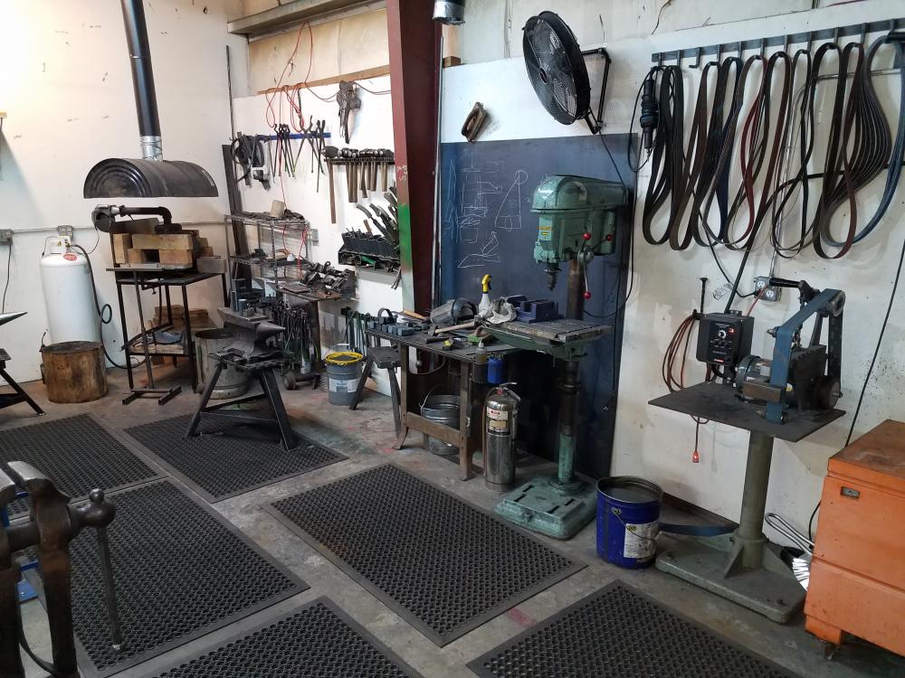

This picture is the back left corner behind the office/bathroom, there is a loft above these room but only 6.4' tall. To looking from left to right I have my 6" anvil, 110lb Big Blu hammer another 6" vice, sink. bench grinder with 2 wire wheels, Studant/2nd anvil, propane forge, small steel/jig/tool steel shelf. Go to next picture

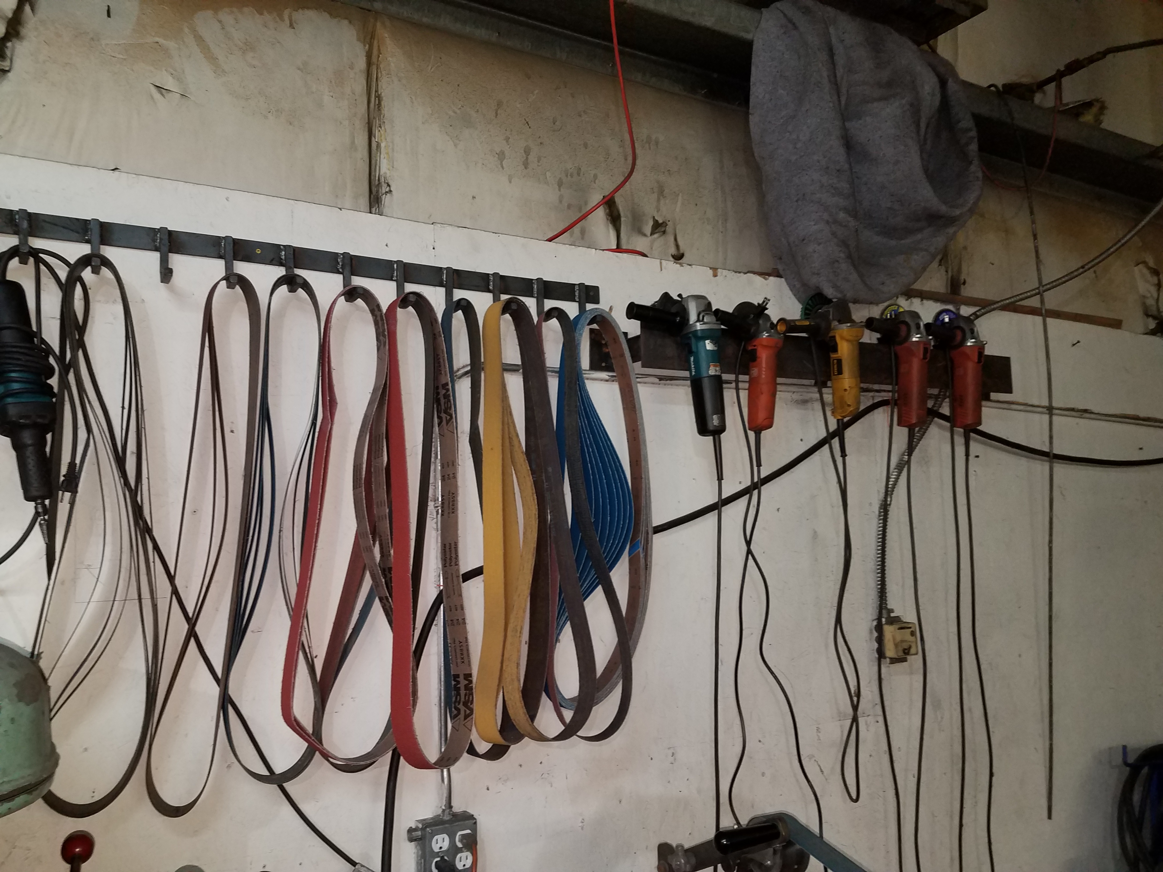

Next to the shelf I have a small steel table with a hardy tool rack, a hook rack, Hammer rack, punch/drift/hand fuller, guillotine fuller....rack, my coke forge, drill press, Belt rack, belt grinder
Grinder rack

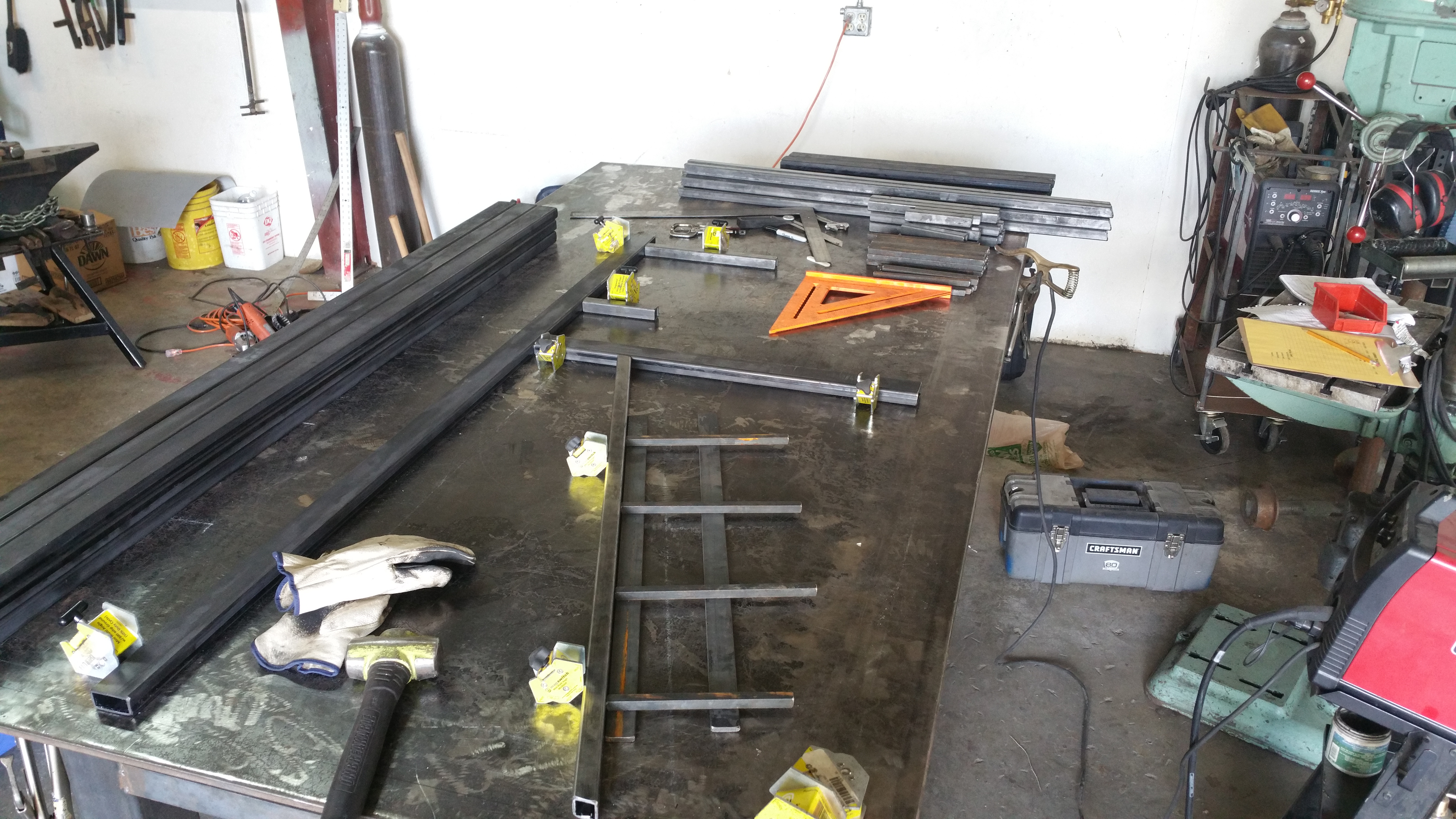

This is along the right shop in the back my grinder rack is just out of view. I build 9 stands that look kinda like a "k" Assembled they make my work bench with 2 shelves, and my steel rack, so far i have had 3,500lbs on it with no issues. I made a roller deck for my bandsaw and i have an adjustable single roller for materials over 12' long. I am welding up the legs for the bench/steel rack.
This is all the legs stood up and starting to get the wood shelves attached.

I also have a 4x8 fab table it is on casters cause i need to be able to roll it around my shop. I'll post the rest of my shop in a few.

I'm curious about the hood over the gas forge. Is that a powered exhaust? For the fumes or the heat?
yes i have an exhaust fan, I don"t get to many fumes from my forge, but welding smoke and heat is the main reason.
