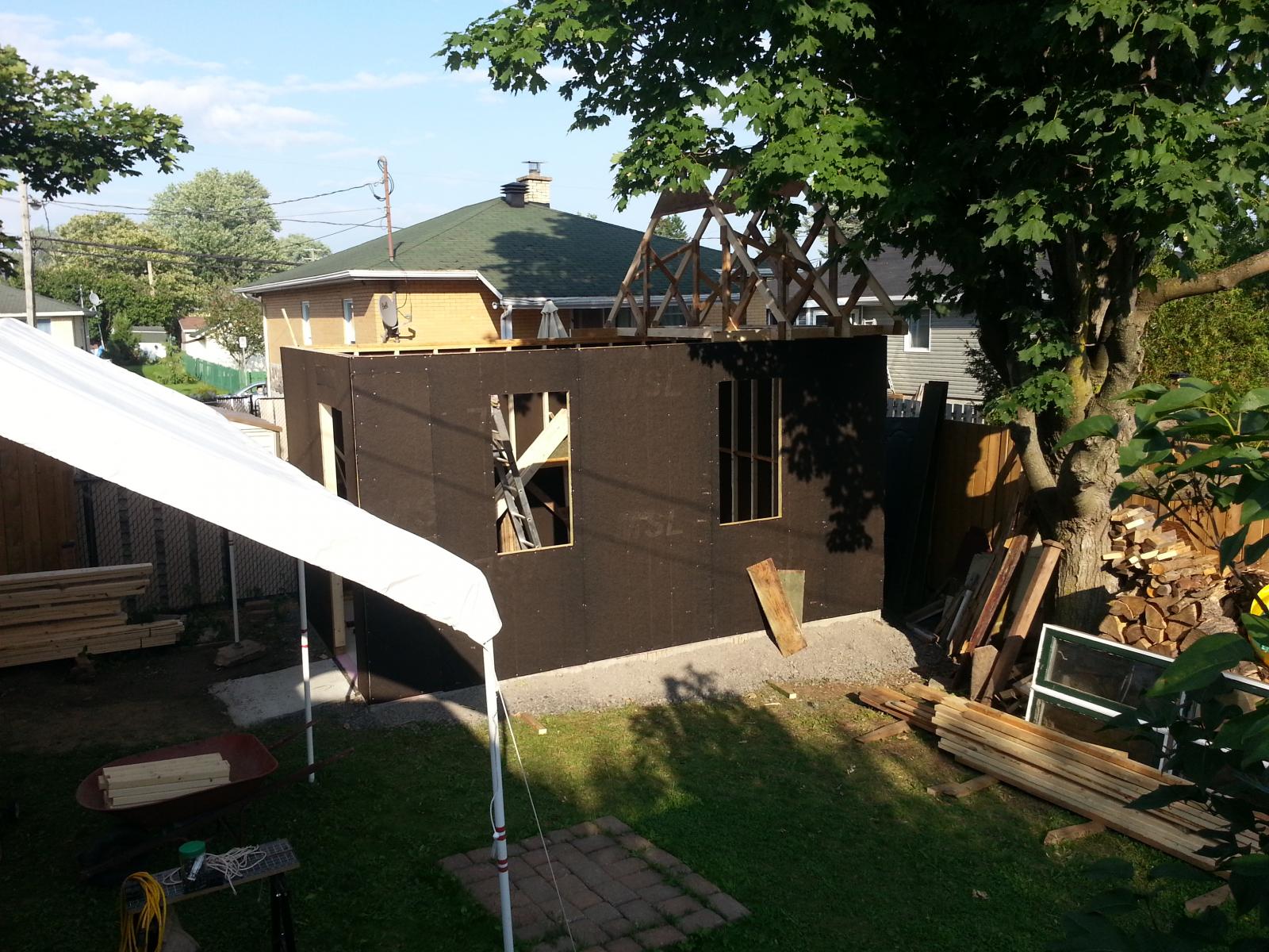

Much progress over the last few weeks, since I was on vacation. Poured the concrete slab before going away to Pennsic War (a big SCA event). Once I came back I started putting up the structure, with much help from my dad.
Here's a few pictures of the progress...
large.20170801_160958.jpg.f882672dbcc0a74ad4f238af28c746e2.jpglarge.20170816_171027.jpg.f76df665948b91433a44af1006639777.jpg
large.20170820_170750.jpg.30462f473f878a56001da26b3dac734a.jpglarge.20170826_164232.jpg.9d6c94a82077b80984d6383575a19840.jpg
I'm starting to install the roofing this week. :)

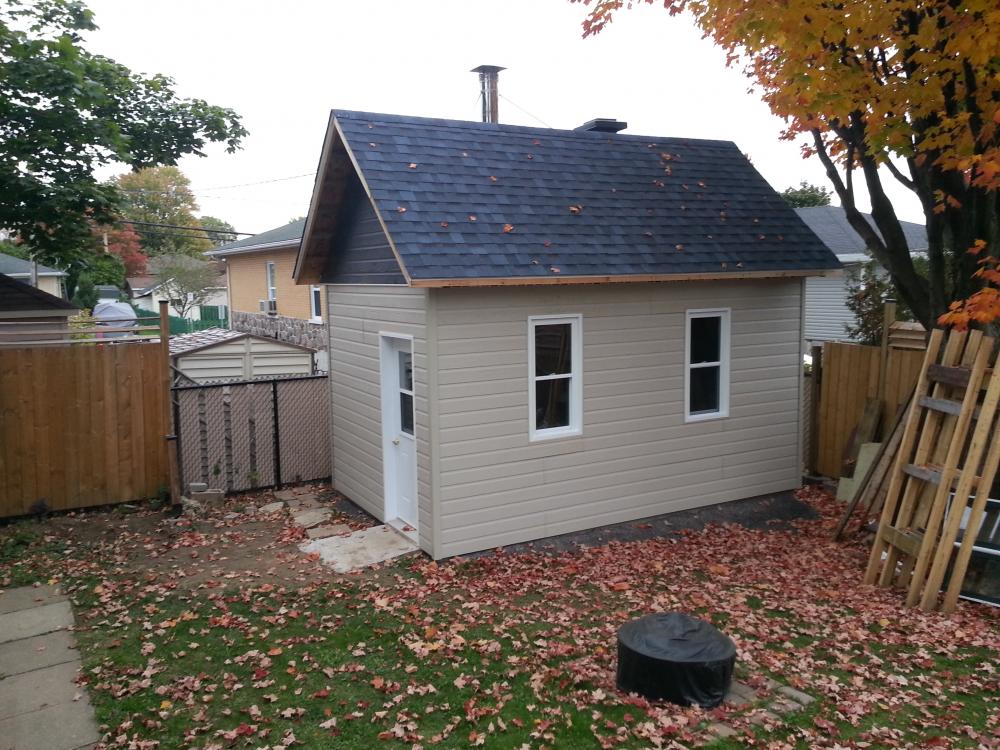

Workshop update: The roof is done, including the chimney. All that's left is to add the spark arrestor to the chimney cap.
I've started working on the inside while I wait for the siding and windows to be delivered. I made a mistake in not ordering those sooner, but it's not like there's nothing else to do in the meantime.

Long time since my last update. The exterior is done and I'm working on the inside. I have installed some shelves. The lighting is done as well, although for now it will be plugged into an extension cord to the house whenever I need it.
20171028_164628.thumb.jpg.2f3753ee02e009b0e66c5f739bc928c2.jpg20171117_162719.thumb.jpg.68bc5c789c14be5337cf0e2a2d78dfdf.jpg
Still have a lot of work to do before I am ready to light a forge in there, but it is coming along. :)
