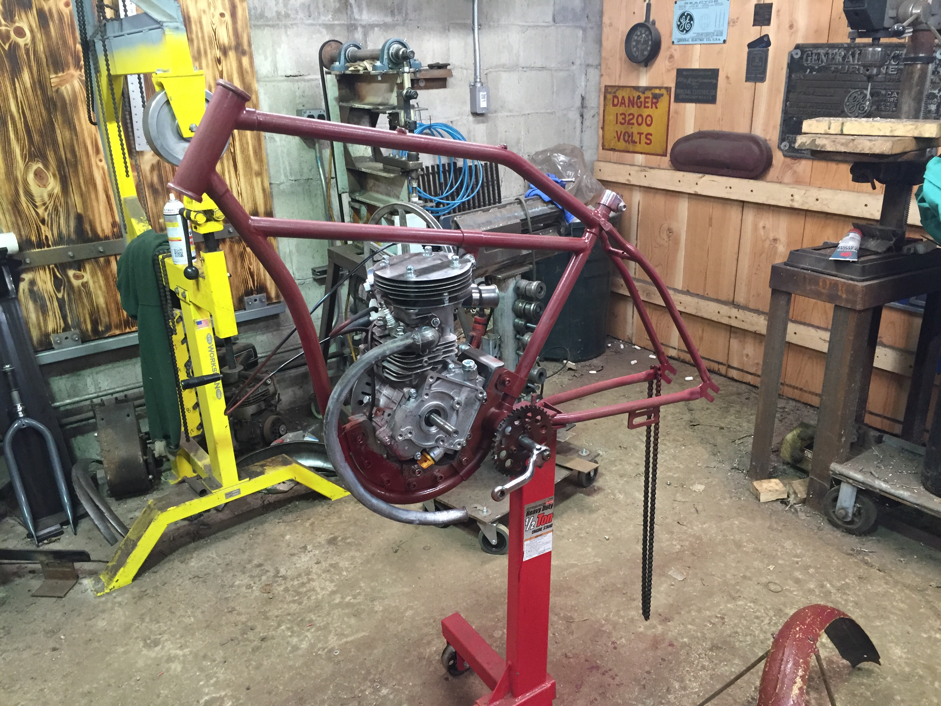

1910 Indian/Harley replica
Guess this is right category for this.

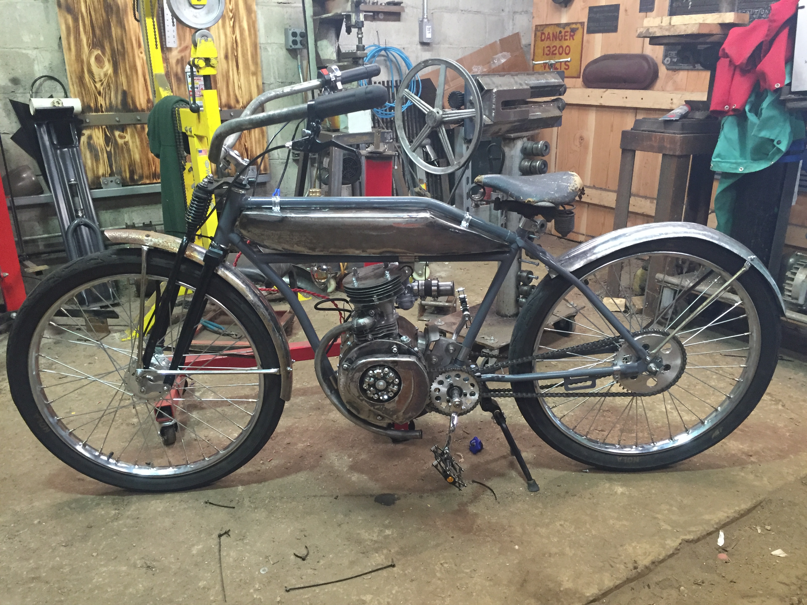

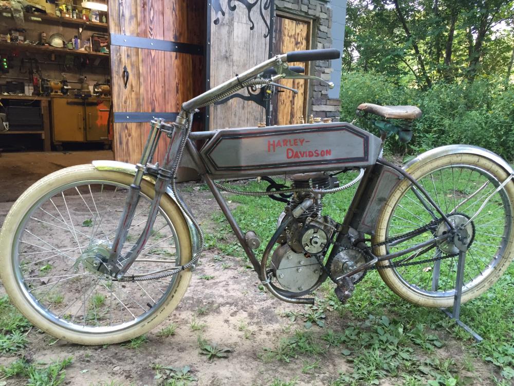

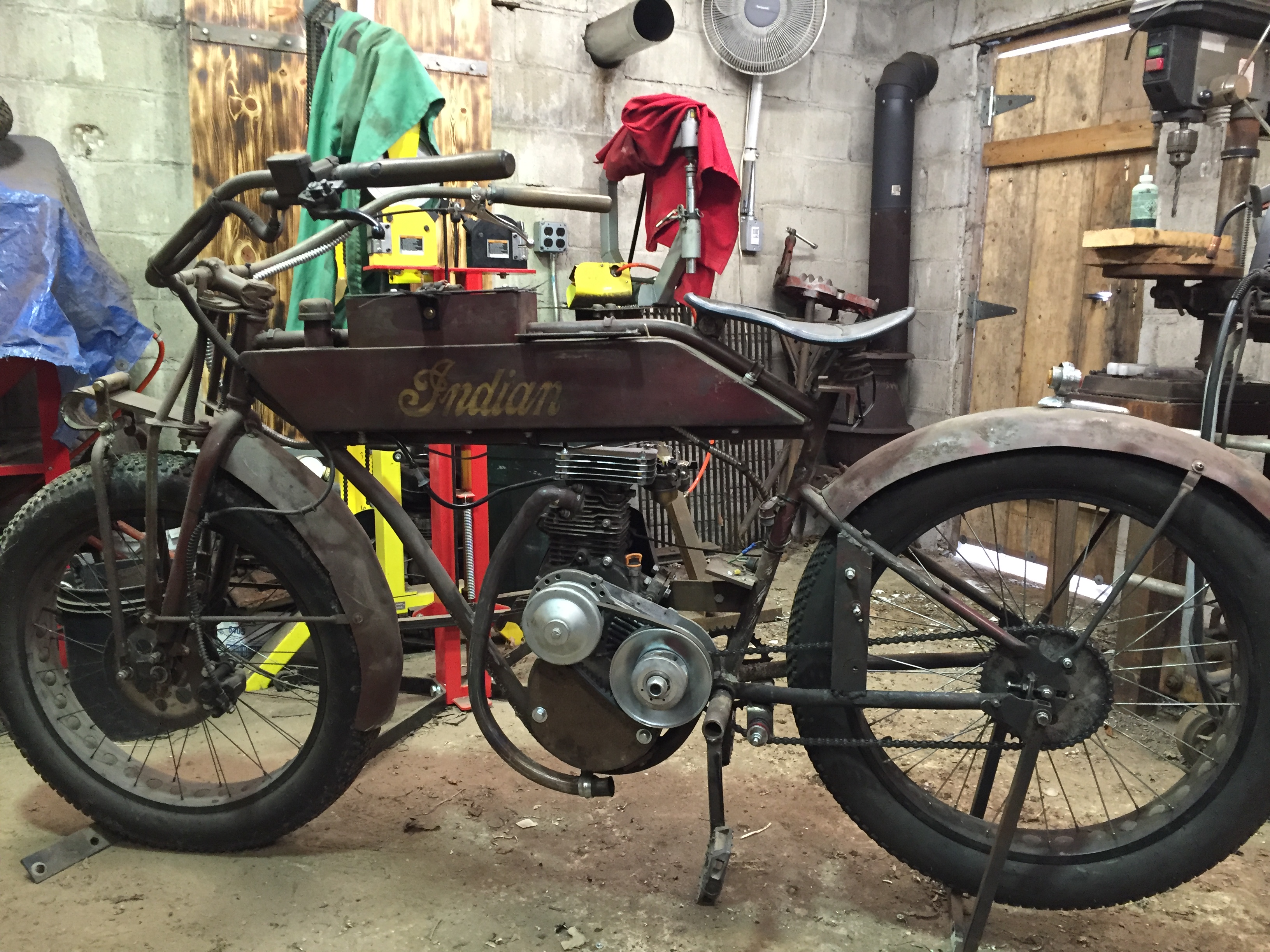

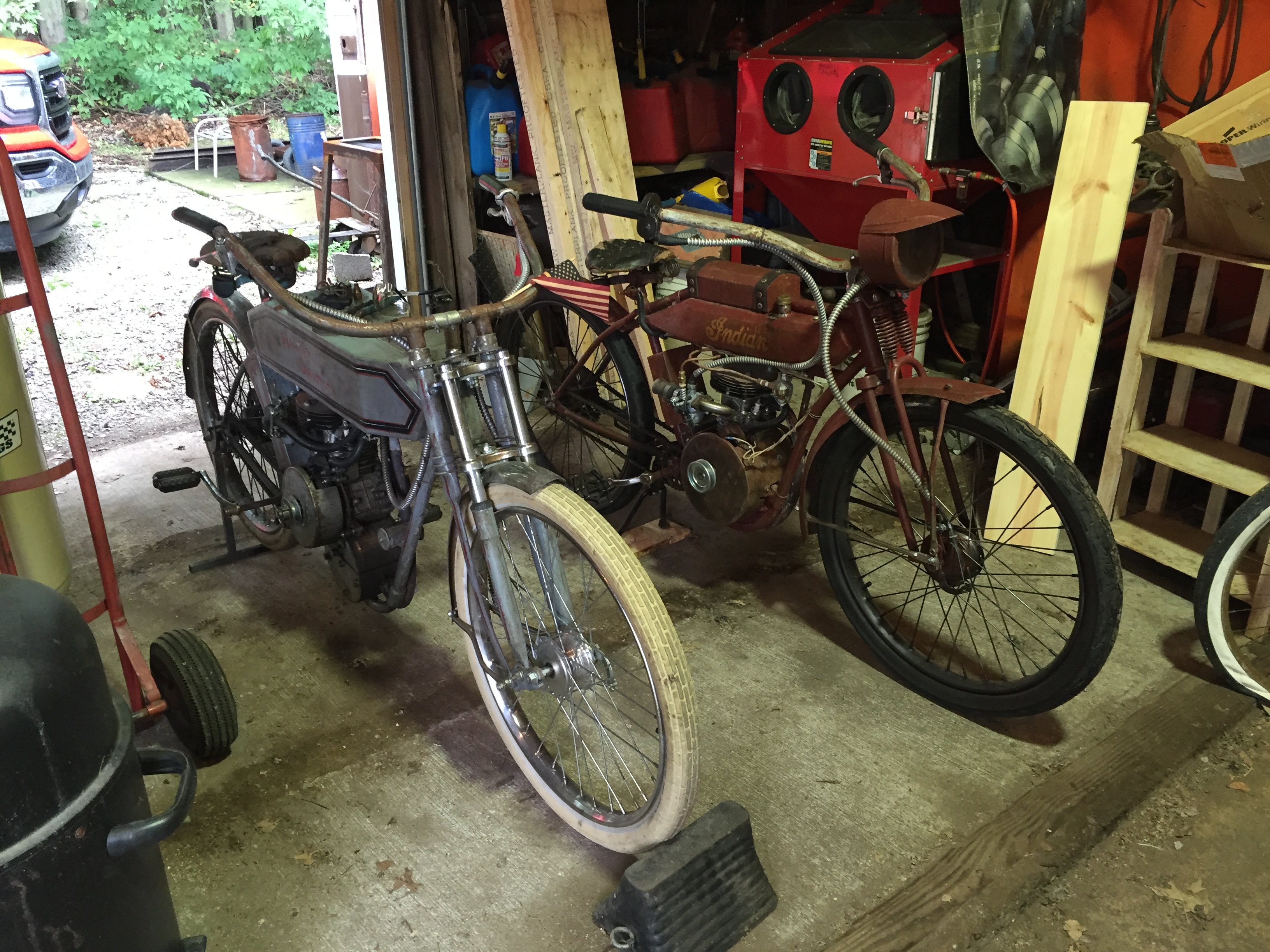

Made these last couple years.
Frame and sheet metal all from scratch on Harley replica.

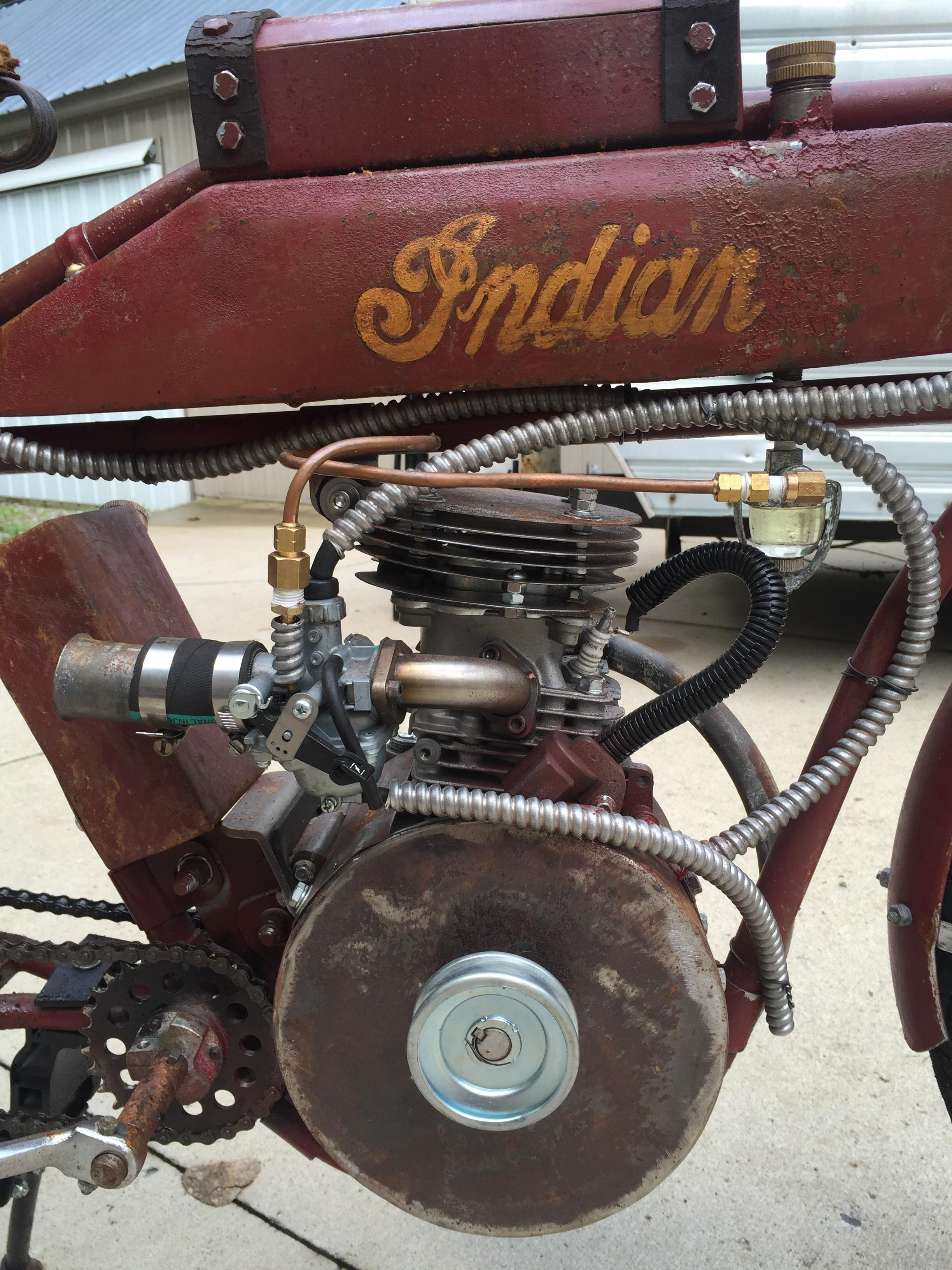

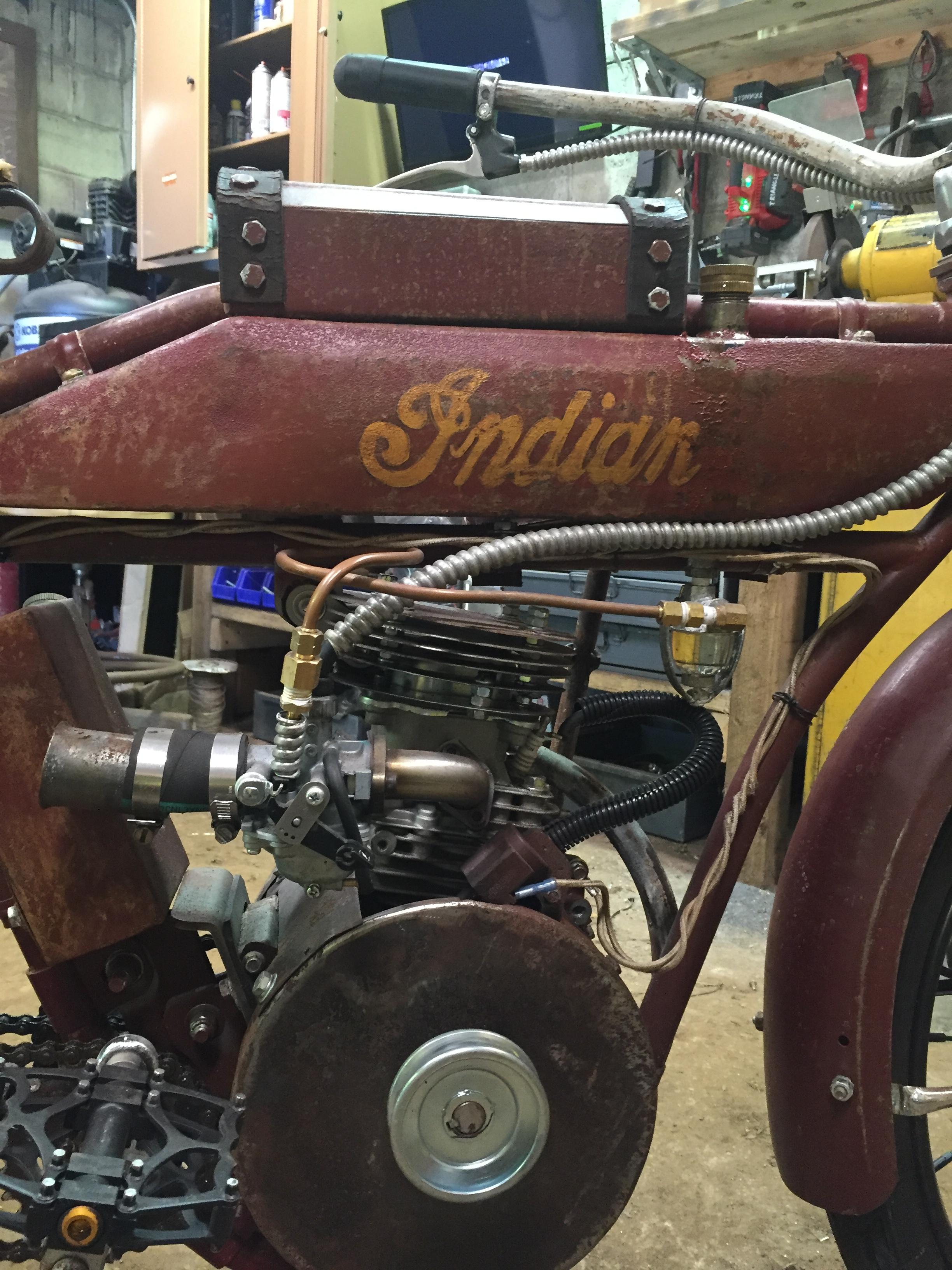

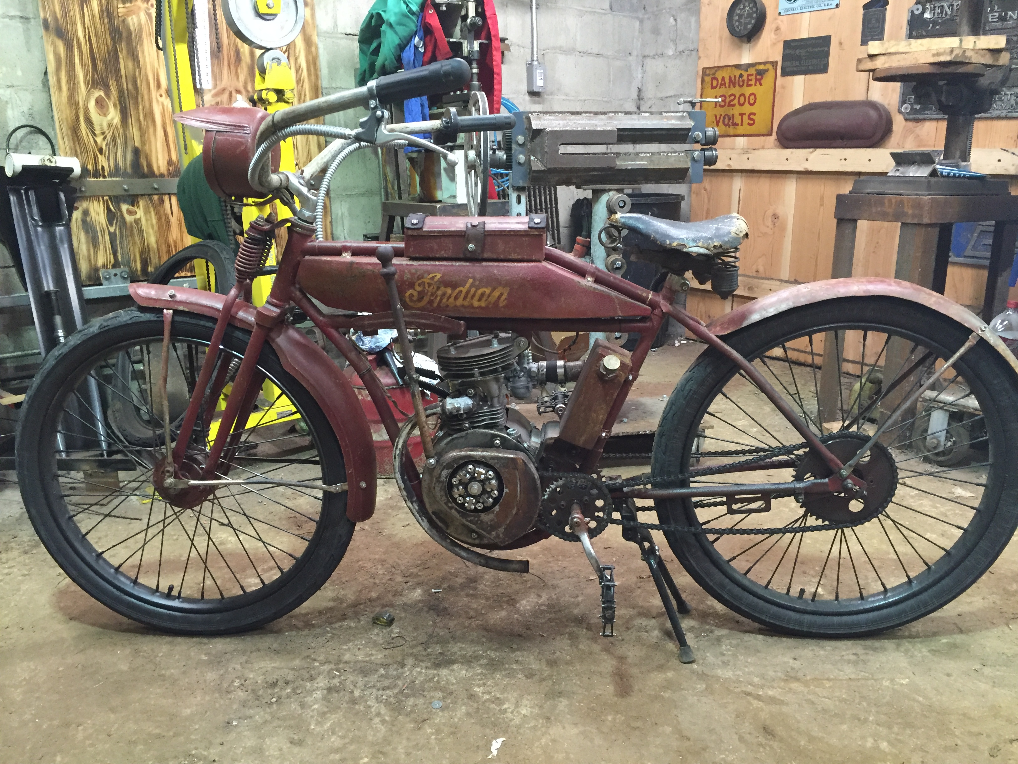

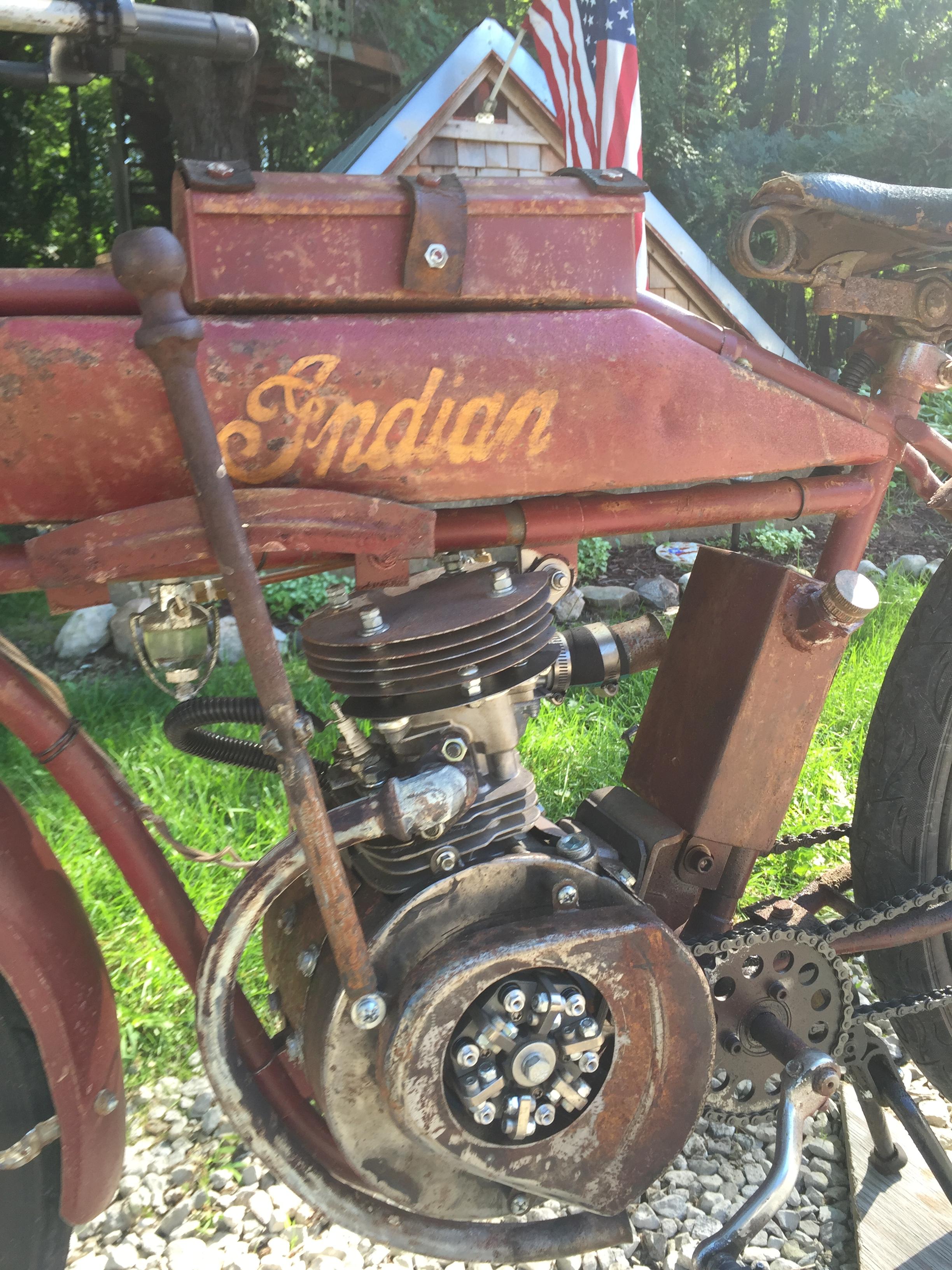

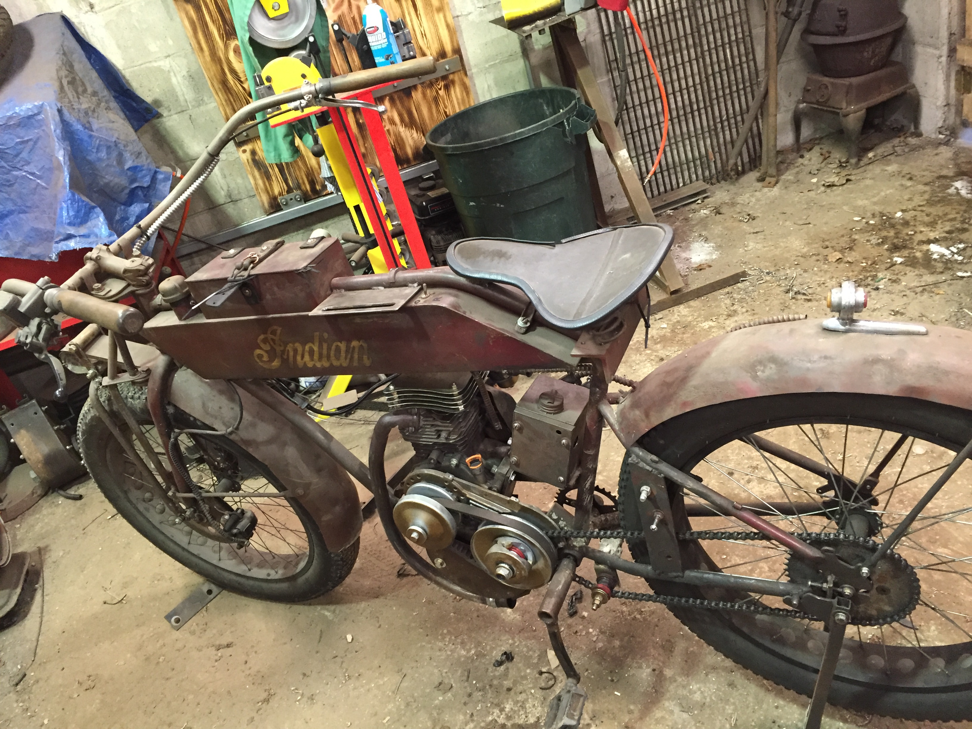

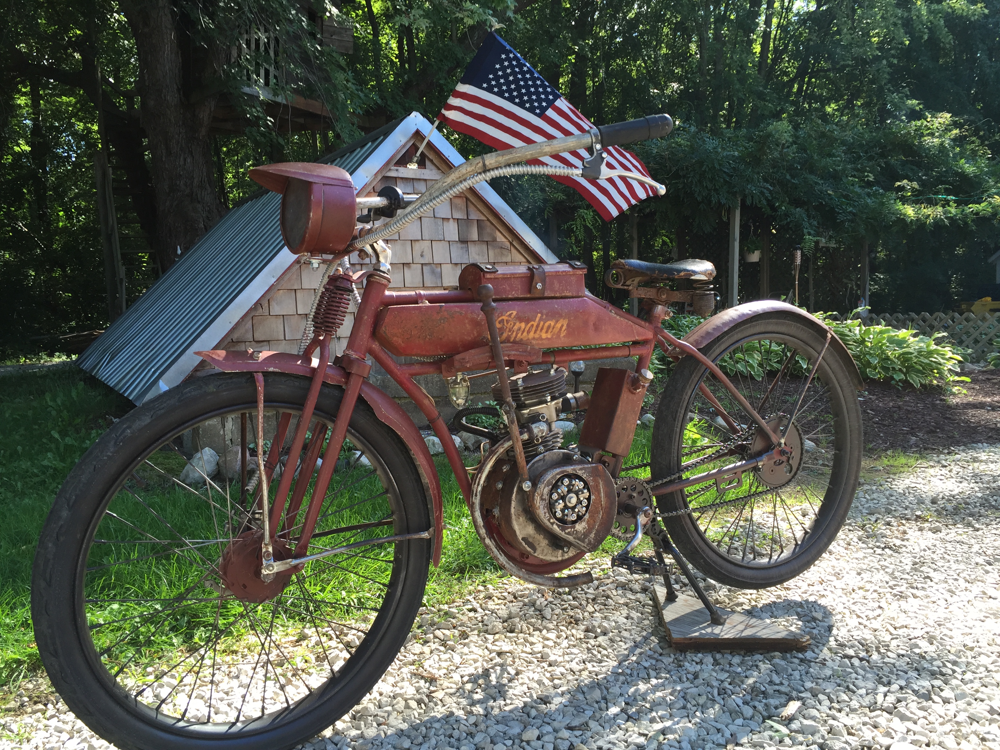

Sheet metal on Indian replica from scratch. Bought frame.
Thanks
Awesome work 58er. Do you ride them? If so I bet you turn some heads with those. I don't know much of anything about them but I love the look.

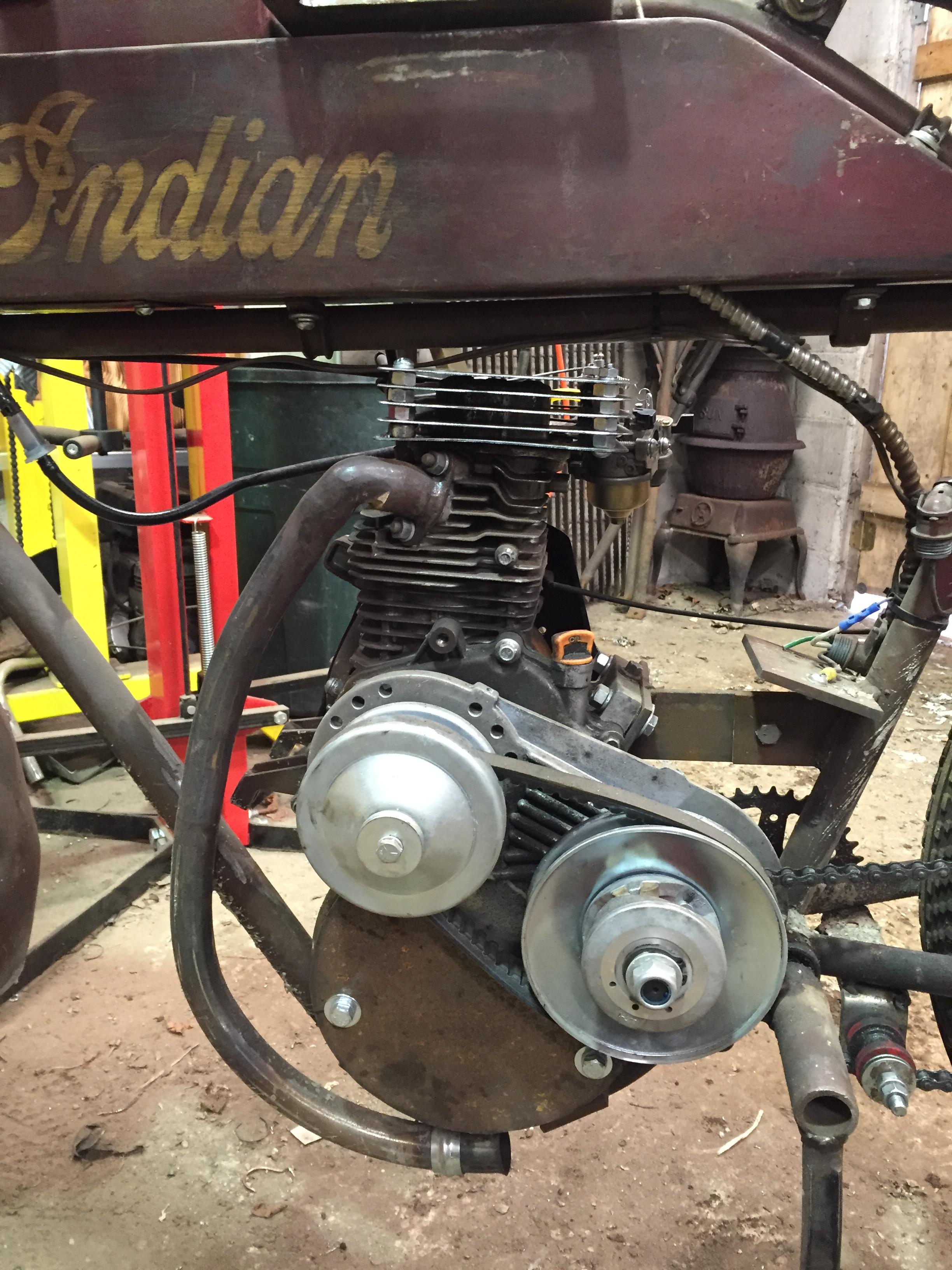

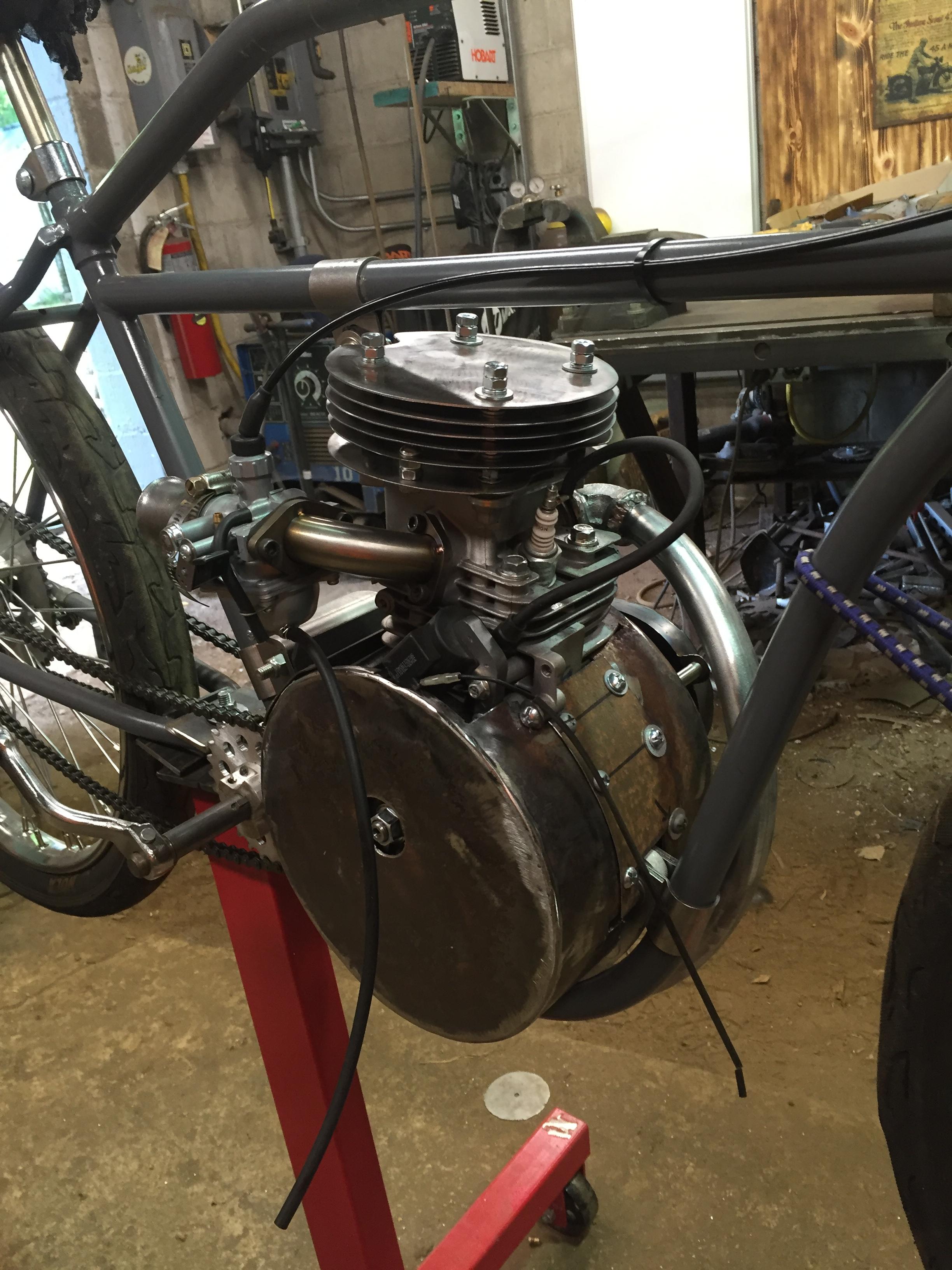

Thanks They are actually harbor freight 79cc predator engines. I strip them down take out low oil sensor /governor and mount them vertically. Then I make a set of " flathead" fins  for the top to make them look more interesting. If they go bad. 99.00 gets you a new one.
They rarely do. Very good honda clone motor.

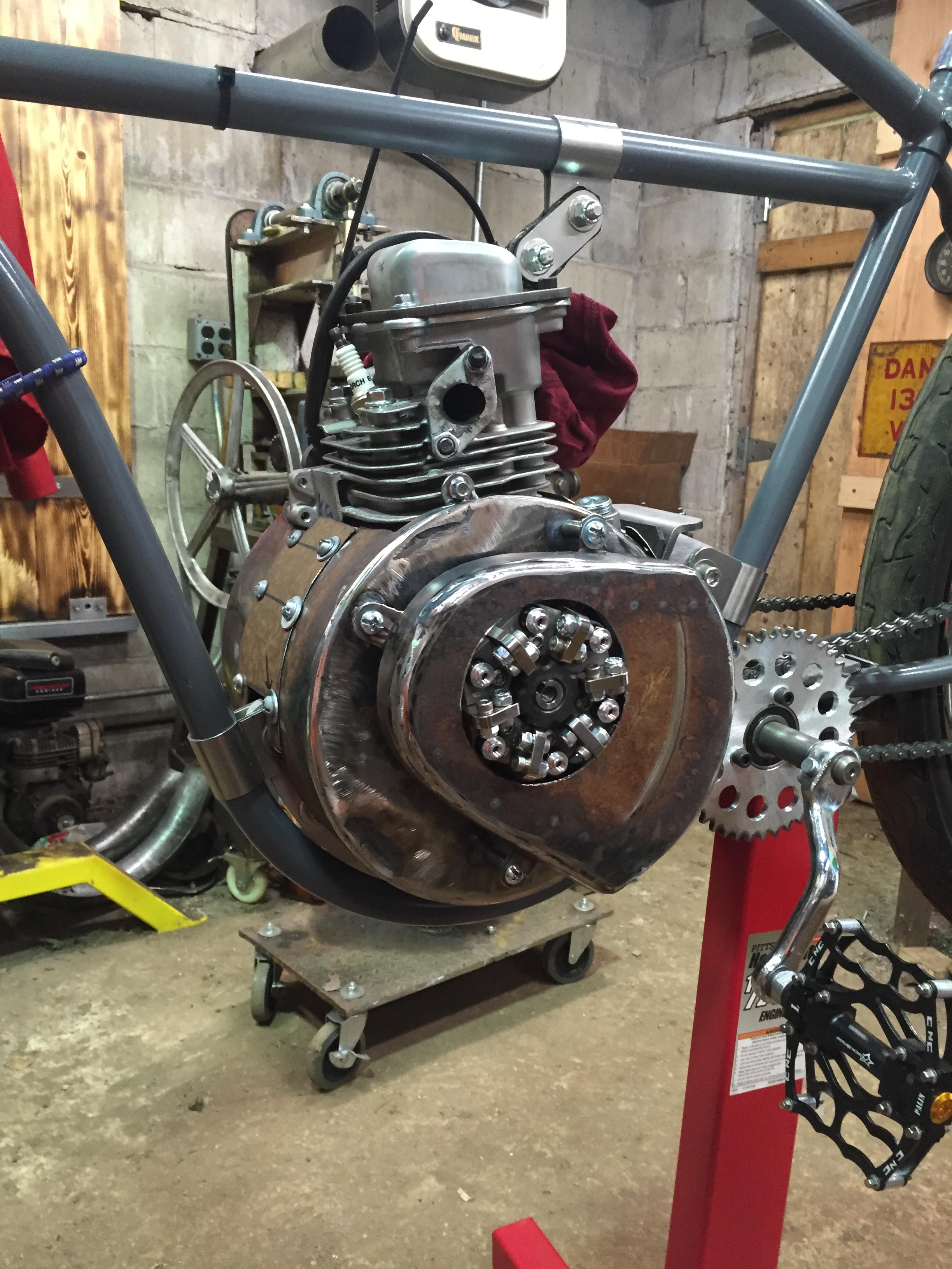

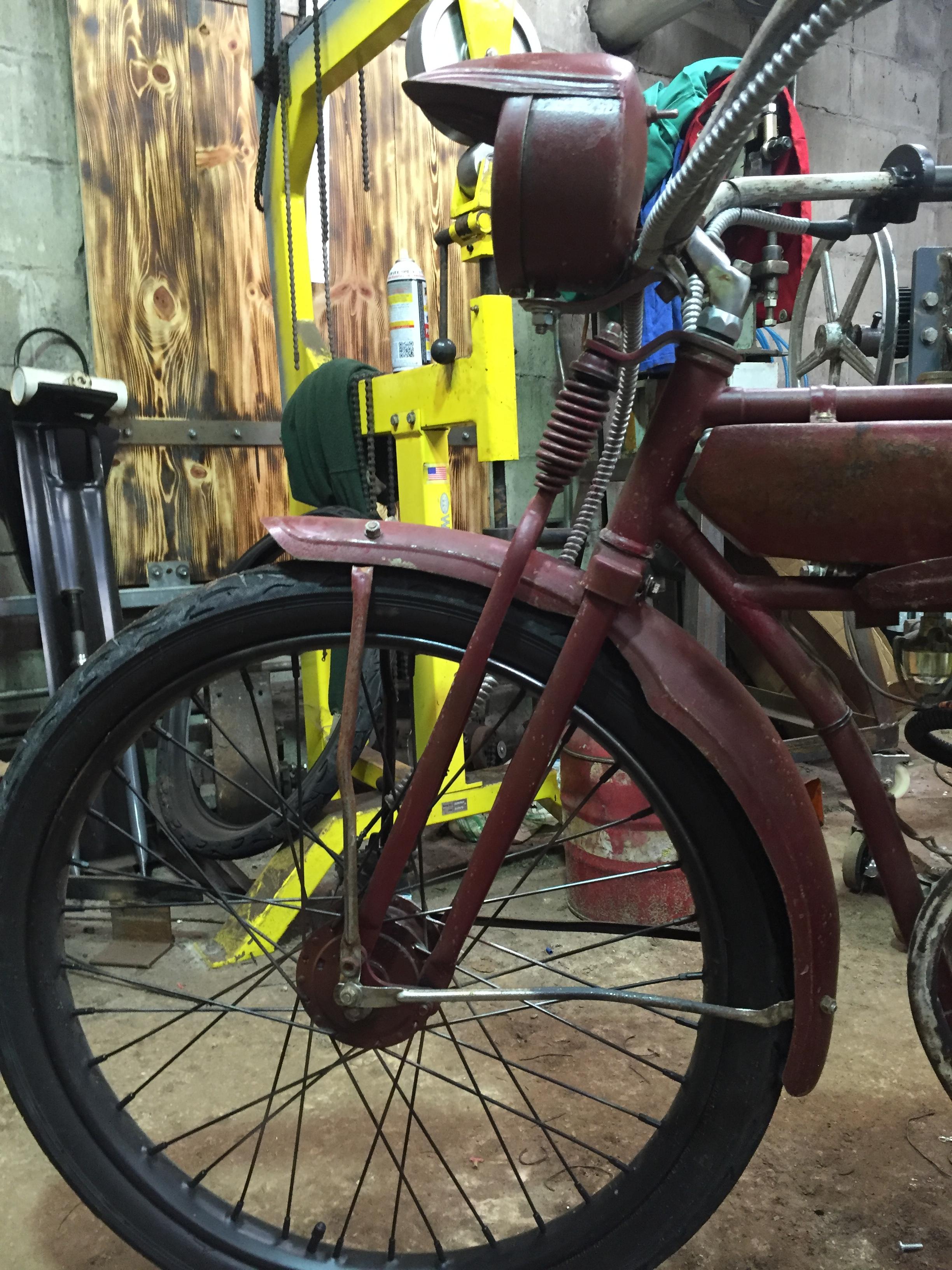

Here's another experimental bike I made from a fat tire bike from the store.
I used a golf cart type clutch on it and a little bigger predator motor.
Not really historically accurate but kinda cool.

Yes. Agreed on the steering of bikes of this vintage. The Harley replica has accurately bent handlebars and it's very difficult to ride. Takes getting used to.
 On the Indian I took a more modern approach when I bent them up. The indian is a more performance minded bike and will go 35-40 and is very stable.

4 stroke Honda clone engines.
I get them from harbor freight
