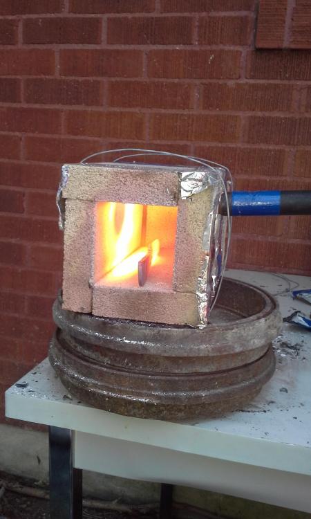

Version one, DSCN0579.thumb.JPG.6d819eae90bb3e2c95f0266d8d77a871.JPGversion two,DSCN2930.thumb.JPG.ddaf0e52a79be52af8e3a9b030064c83.JPG version three,DSCN3508.thumb.JPG.1be9da39ccaef640aa42517c2d9e04a4.JPG all with the same brake drum and tuyere piping. By the time I'd bolted the drum into the metal cart, I'd cut off the ash dump end of the piping and put a bucket of water under the ash dump, full enough to cover the end of the pipe, that ended all rusted up ash dump issues.
that last version was hauled to a Hammer In and donated to the Iron in the Hat event. Replaced with a cast iron forge and firepot.

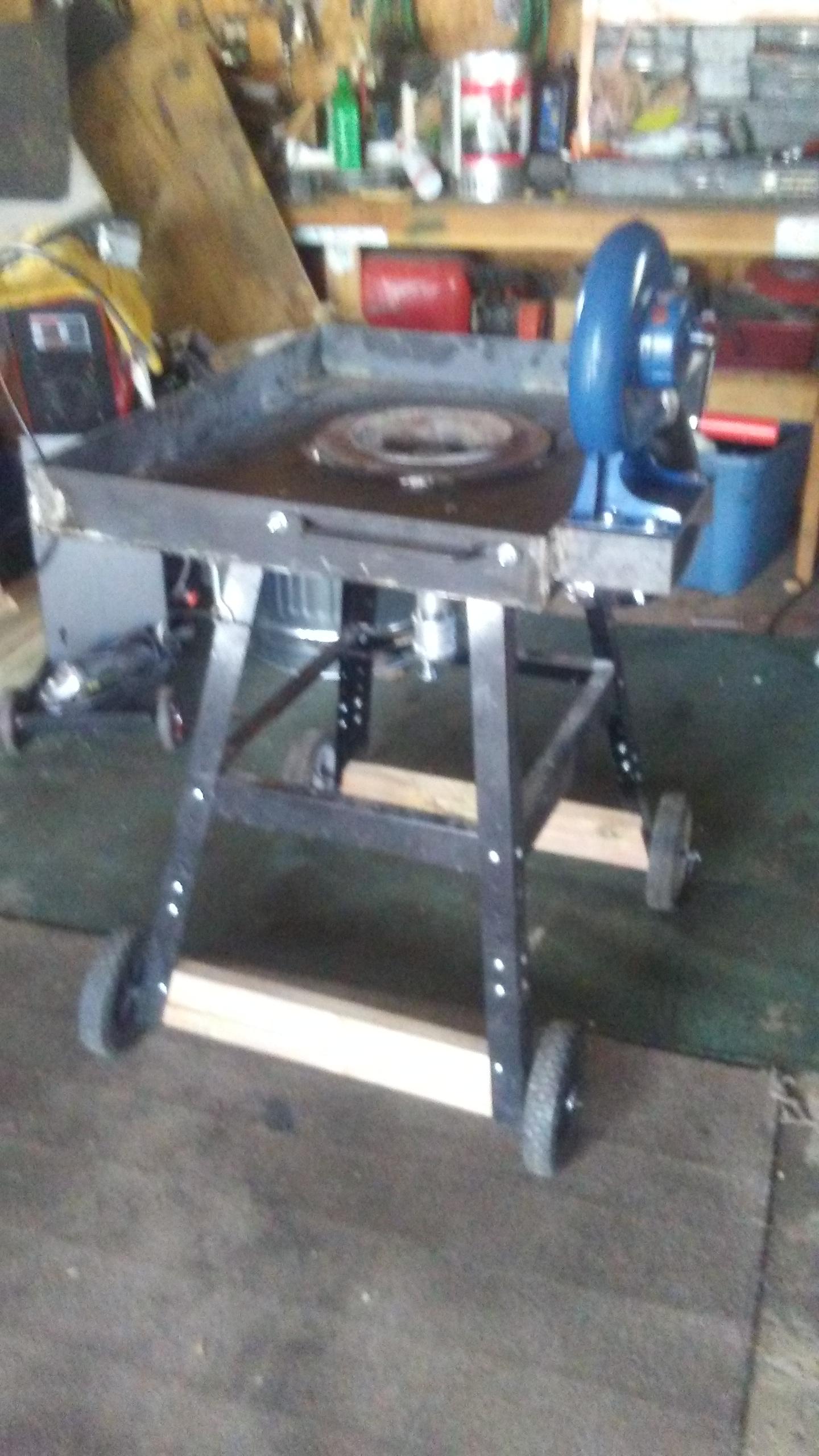

Here is mine, been in service for 25+ years. The only cost was for the pipe and electricity + welding rods for the welder.
The blower was donated by a friend who owned Hanby Lumber & Milling that had a blacksmith shop in the early 1900s.
The body is cut down from a semi-trailer wheel with a 22 inch manhole ring as the table. The legs are a split grader blade. Everything scrounged from various sources.
Here is my first attempt. Still not finished, have to put a lip around outer edge of table. Firepot made from 3/4" plate thanks to a friend with a lot of steel and a plasma cutter. Had I known more the design would have been different. Good start until I know more what my needs are.
