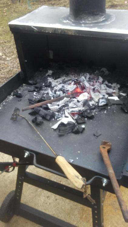

  5. I started the new forge up with some charcoal today. I wanted to see how it went. I had a pair of nippers I wanted to try fashion into tongs so I gave it a go. OH MY GOSH how fun it is to hammer that red iron. It's like beating hard clay into shapes. It feels so soft till the heat goes out. I'm loven it. Here's a couple pics. The tongs just got a start and I need to review videos.
  6. I have some things yet to put on mine but it's operational if I wished.

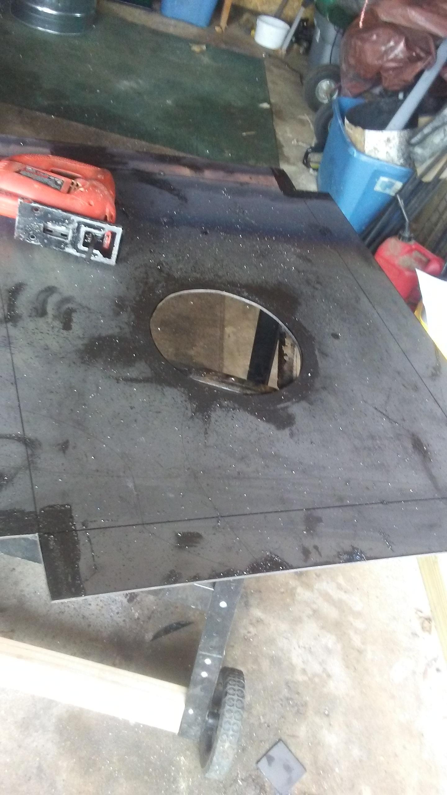

  8. I should have mentioned that the table was upside down. Here's a pic with more of it together. I'm impressed with that cheap blower. It works great. I need to get some angle iron and make my hood, next.
  9. Here's a couple pics of my start on the new forge. I was in to Home Depot and got the makings for the tuyere and blower attachment. I'm lamenting on the stand that shows bellow the tray in the pic. If I should put heavier legs on this or use the stand. It's not heavy duty but rolls around nice. I guess I can see and change later. The tray is 24"x30" with 3" sides. I think I will make a hood over the firepot end to gather smoke up and away. I'm putting some time into this so it will look good and be functional for quite some time.
