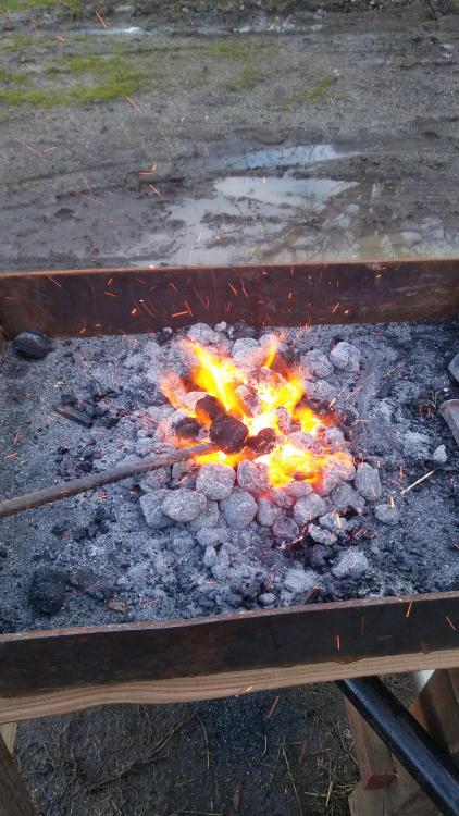

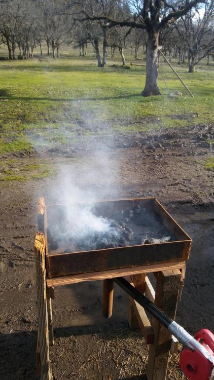

Sacred Steel Forge Posted March 10, 2017 Author Share Posted March 10, 2017 I understand and fully agree! Well this is where it gets interesting for the pros, because my design is a one of a kind and i havnt see anything like it before. It was designed by me and a buddy whos an ex smith, it is designed as a 2 in 1 forge. Its a table top forge with angle iron mounted below the table so i can slide a smaller brake drum forge beneath it and have a larger forge. Now i thought that too much air must be escaping from in between the table bottom and the brake drum top right where the two meet. But again i was using burquettes and i did get enough heat to make a knife so i believe i have the right amount of airflow with an alright design but i was using the wrong fuel source. Again i will post pictures but if you can give me your opinions off of my brief descriptio it would be much appreciated. Thanks again for all the advice so far (: Quote Link to comment Share on other sites More sharing options...
Sacred Steel Forge Posted March 10, 2017 Author Share Posted March 10, 2017 here are some photos i had on my phone already these do not show the construction perfectly but it will help you with an idea of what i have. I will post more in dept ones today when i reach the forge but here are some alright ones. The wood table is not attached to any of the metal. Quote Link to comment Share on other sites More sharing options...
ThomasPowers Posted March 10, 2017 Share Posted March 10, 2017 Need a taller fuel pile for one thing. And I'd guess looking at those forge fleas that you need to tone down the air a bit. Quote Link to comment Share on other sites More sharing options...
Sacred Steel Forge Posted March 10, 2017 Author Share Posted March 10, 2017 Usually the entire table is filled and i figured i could reduce the airflow a little. From what you can see though its probably my fuel source? Quote Link to comment Share on other sites More sharing options...
Daswulf Posted March 10, 2017 Share Posted March 10, 2017 Really could use pictures with it cleaned out a bit. Little details matter when diagnosing things. A leaf blower is way too powerful a blower for charcoal without an air gate or diverted to control the amount. Is there a cap on the ash dump? Quote Link to comment Share on other sites More sharing options...
Sacred Steel Forge Posted March 10, 2017 Author Share Posted March 10, 2017 There is not ileft it open because i figured the force of the small blower would have been to much, that is also the reason the brake drum is not airtight on the bottom allowing very little air to escape but enough to keep the underside of my table cool as well Quote Link to comment Share on other sites More sharing options...
ThomasPowers Posted March 10, 2017 Share Posted March 10, 2017 Yes better fuel = more heat you should be able to burn up steel with no problem. Still too much air! Quote Link to comment Share on other sites More sharing options...
Sacred Steel Forge Posted March 10, 2017 Author Share Posted March 10, 2017 Would a hairdryer be too much air flow even one with different speed settings? Quote Link to comment Share on other sites More sharing options...
Frosty Posted March 10, 2017 Share Posted March 10, 2017 You CAN use briquettes but you have to break them up to about -3/4" pieces to increase the surface area. This increases the chemical reaction of the fire which makes a hotter fire, more fuel burning per second means hotter. The increase in surface area also consumes the oxygen more completely so the steel won't scale as much on it's way to heat. A blow drier is far superior to a leaf blower, I use an electric leaf blower to burn slash piles, limbs, logs and stumps. Bust the briquettes into acorn size pieces, it'll work a LOT better. If you reinvest the time and effort you used making a bottom blast forge and turn it into a side draft you'll have a fine working forge. Check out Charles' "Box of Dirt Forge" posts here and there's a current thread about the "JABOD" forge with build and use pics. Briquettes WILL work there are just better fuels. Heck, if you set it up properly and have some experience briquettes work better in some ways. Still, buy lump, build a retort or shovel it out of a camp fire as you need it. Frosty The Lucky. Quote Link to comment Share on other sites More sharing options...
