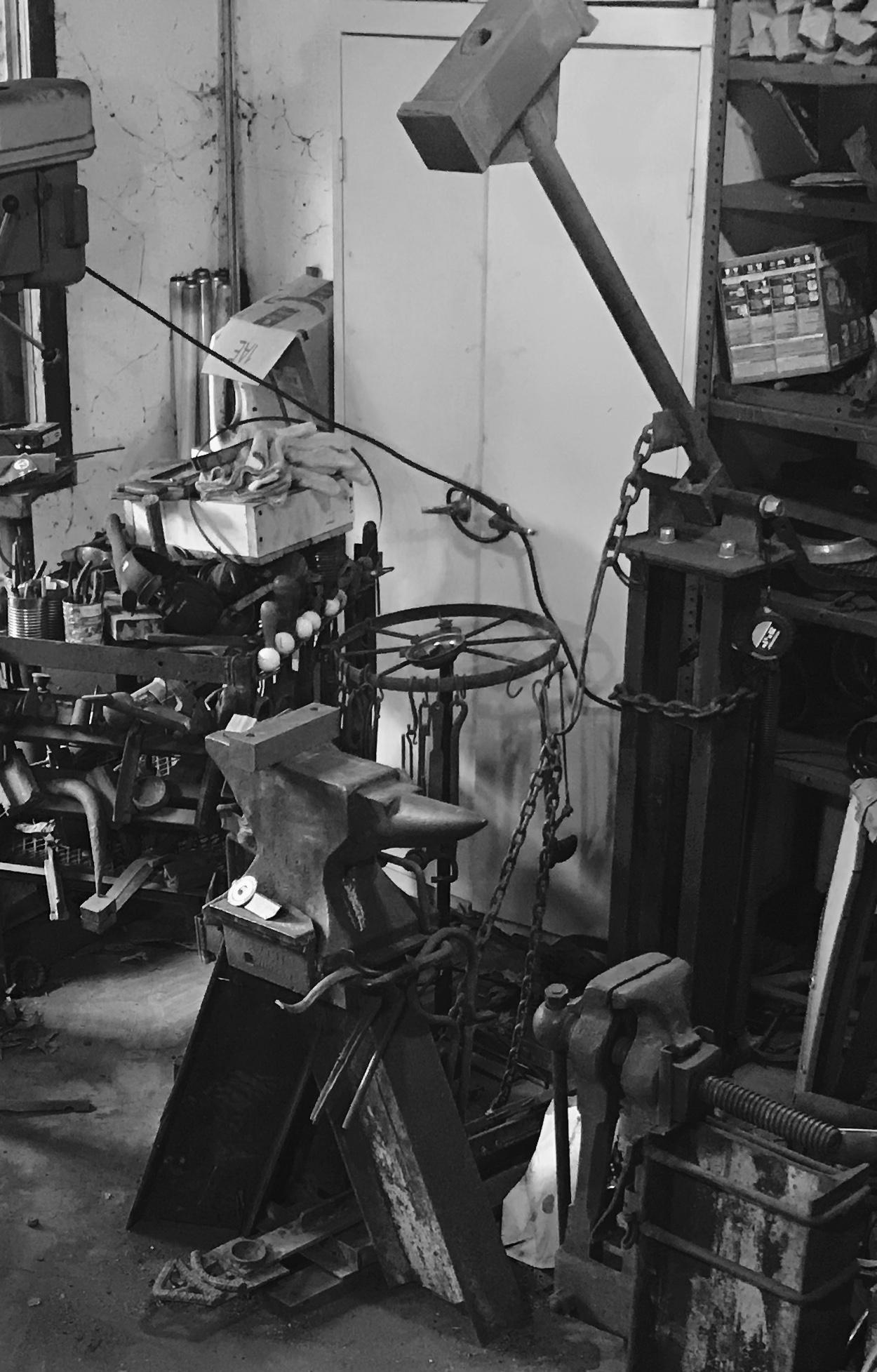

The advantage of the striking anvil/portable hole isn't its resistance to being struck, in this case, but its stability and accessibility (my main anvil is hard to access from all sides, because of the attached treadle hammer). Also, while my main anvil has a 7/8" hardy hole, the striking anvil's is 1½", so it's easy to weld tools up on a stem of 1½" square tube (of which my local supplier often has cheap drops).
Interesting. Do you have a pic? And is this a permanent attachment? No critique, I'm just curious. For what it's worth, both my anvil and my post vice are set up for 360 degree access.
Here you go:
Yes, it’s (semi-)permanently attached. There are four big Allen-head screws under the anvil base that can be removed to disconnect it from the hammer.

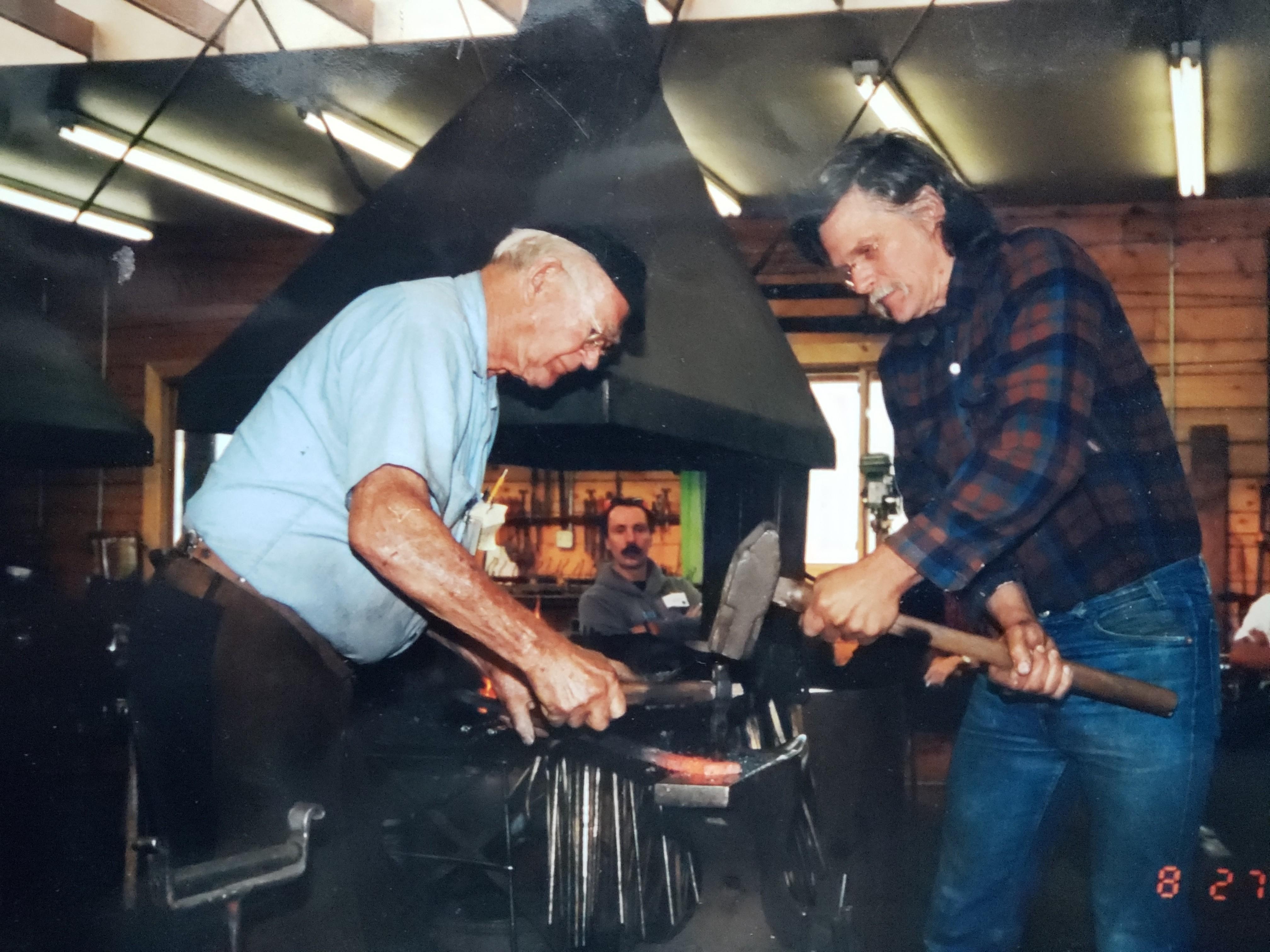

So you don't need an apprentice for the old "When I nod my head, hit it!"
That’s right; I can do it myself!
