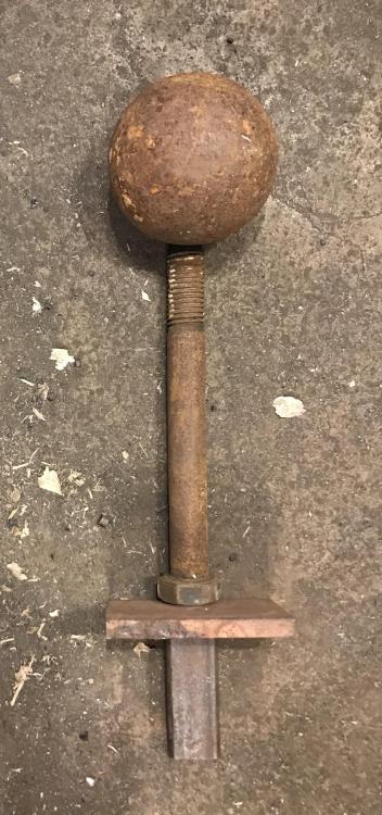

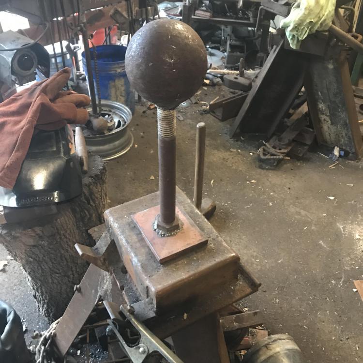

Very cool! Are there any adjustments as to where it hits?
Meaning can you do an edge to edge or half faced blow?
No, it just hits in one place.  I don’t forge with it directly; there’s way too much slop in the pivot mechanism for accurately placed hammer blows. It’s fantastic for use with top tools, though.
