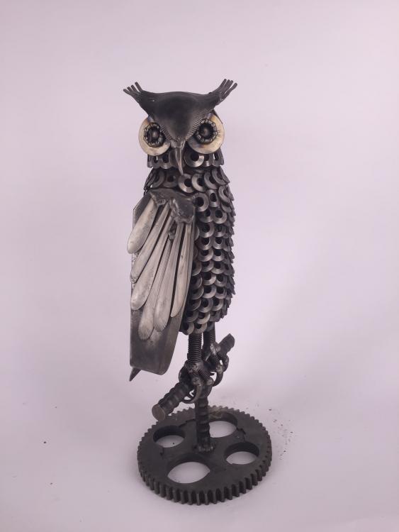

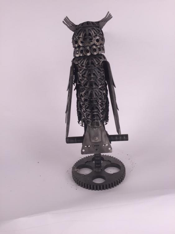

Daswulf Posted December 12, 2016 Share Posted December 12, 2016 Here is a commissioned owl that was asked for a while ago and needed before Christmas. done and done. I thought about a mouse in it's claws but this one is good as is. Next one, since I have atleast 1 or 2 more to make. I only made 3 or 4 different sets of eyes for this guy. one I liked more but it didn't work out shape wise. his head is built off of a bearing and spins fully around. hopefully my photography is better but I messed it up again. I've spilled enough beers, and stomped enough bulbs tonight. Jeesh......next time.... enjoy. Quote Link to comment Share on other sites More sharing options...

Daswulf Posted December 12, 2016 Author Share Posted December 12, 2016 Thanks Darryl. Yup those are fork and spoon handles on lawnmower blades. The blades looked too plain on their own. The head is an assembly of a large bolt and nut through a bearing. The bolt/nut part is welded to the body and there is a cv axle? race welded to the outer of the bearing for welding the head parts to. The beak was just forged out round bar stock. You can make horned owls. It would be more exotic. Marc, my second look at that owl I noticed the crow. Quote Link to comment Share on other sites More sharing options...
CTBlades Posted December 12, 2016 Share Posted December 12, 2016 That is simply beautiful my friend, you do some incredible work. I really like the use of the washers and overlaying them as you work around the piece instead of just butt welding each washer to the next. I provides a great depth to the work. Quote Link to comment Share on other sites More sharing options...
Daswulf Posted December 12, 2016 Author Share Posted December 12, 2016 Thanks CT! The key is to start at the bottom and work your way up. Takes some eyeballing of where you will end up at, and just welding the top of each washer lets the next one up hide the weld a bit. Takes a bit of patience too lol. Quote Link to comment Share on other sites More sharing options...
