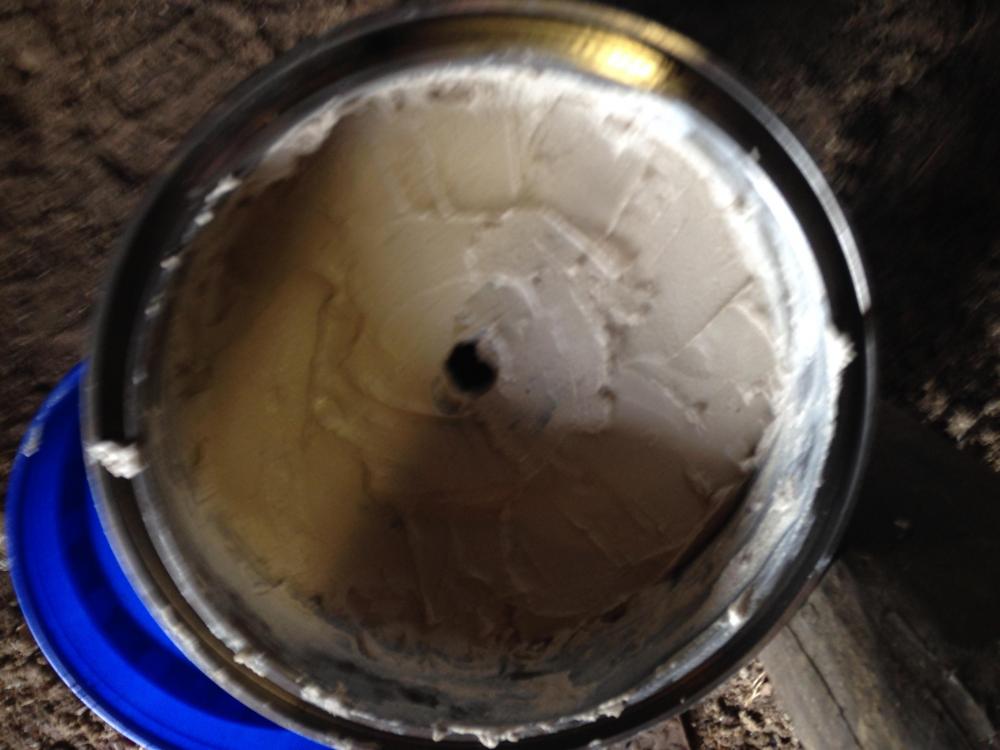

  8. Version 1.1-moved up the forced air supply, and added a ball valve to control air flow (using a shop vac for air supply-on blower mode) Still need to work on the ashgate idea. Definetly gets alot hotter quicker with the air supply 18" closer.
  9. Very nice. The copper looks great the way you used it.

  11. If anyone works in the automotive field, or has access to a Mac distributor these hammer definitely keep the hand fatigue down, they have a dampening system in the hndle: (about $60 each) http://www.mactools.com/en-us/Striking-and-Struck/Hammers/SH2AV/AntiVibe-Blacksmith-Hammer-2-lbs- http://www.mactools.com/en-us/Striking-and-Struck/Hammers/947e7bb5-9f7e-44a5-a209-a30a014f0fe5/AntiVibe-Drilling-Hammer http://www.mactools.com/en-us/Striking-and-Struck/Hammers/99f40cb5-da83-4a65-89c6-a30a014f137f/AntiVibe-Sledge-Hammer

  15. Appreciate the tips, gonna move up the air supply as suggested and see what I can make for a ash dump. Was going to weld a bent piece of rebar to the drum to support longer pieces during heats. So might as well do the mods then. Again thanks for the tips.
  16. I run the shop for a large Chrysler, Dodge, Jeep and Ram dealer. Get a good bit of scrap picking from the repairs as well, have a few axles and springs to tool around with. I do have a grate over the air flow pipe, and the clean out plug is annoying but will work for now. Already had the refractory cement, figured it would keep the drum from cracking. I didnt want a table style setup since I have everything outdoors, mostly so I don't burn the barn down lol. Definitely alot of good info on here so far.
