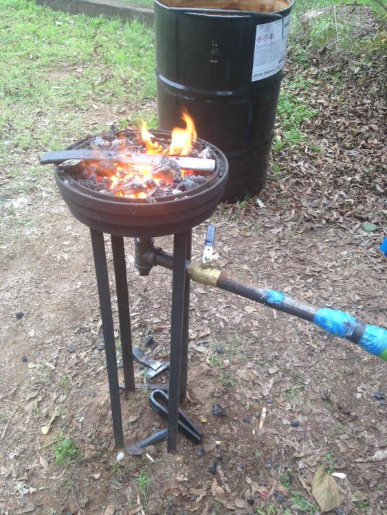

  5. On a secondary note, i had my first burning metal happen while heating multiple pieces. Was yelling at our pitbull puppy for eating pecans in the back yard (im in the back pasture outside the barn) and check my rr spikes i was working in tomahawks and melted the dang heads off of them. So the new setup gets hotter much faster!!!

  7. Good tips, i like the fence idea, will be my next project. I was actually using the leaf spring to melt wax to make a few dozen egg carton fire starters, kept my melt can from tipping over or melting.
  8. Version 1.1-moved up the forced air supply, and added a ball valve to control air flow (using a shop vac for air supply-on blower mode) Still need to work on the ashgate idea. Definetly gets alot hotter quicker with the air supply 18" closer.
