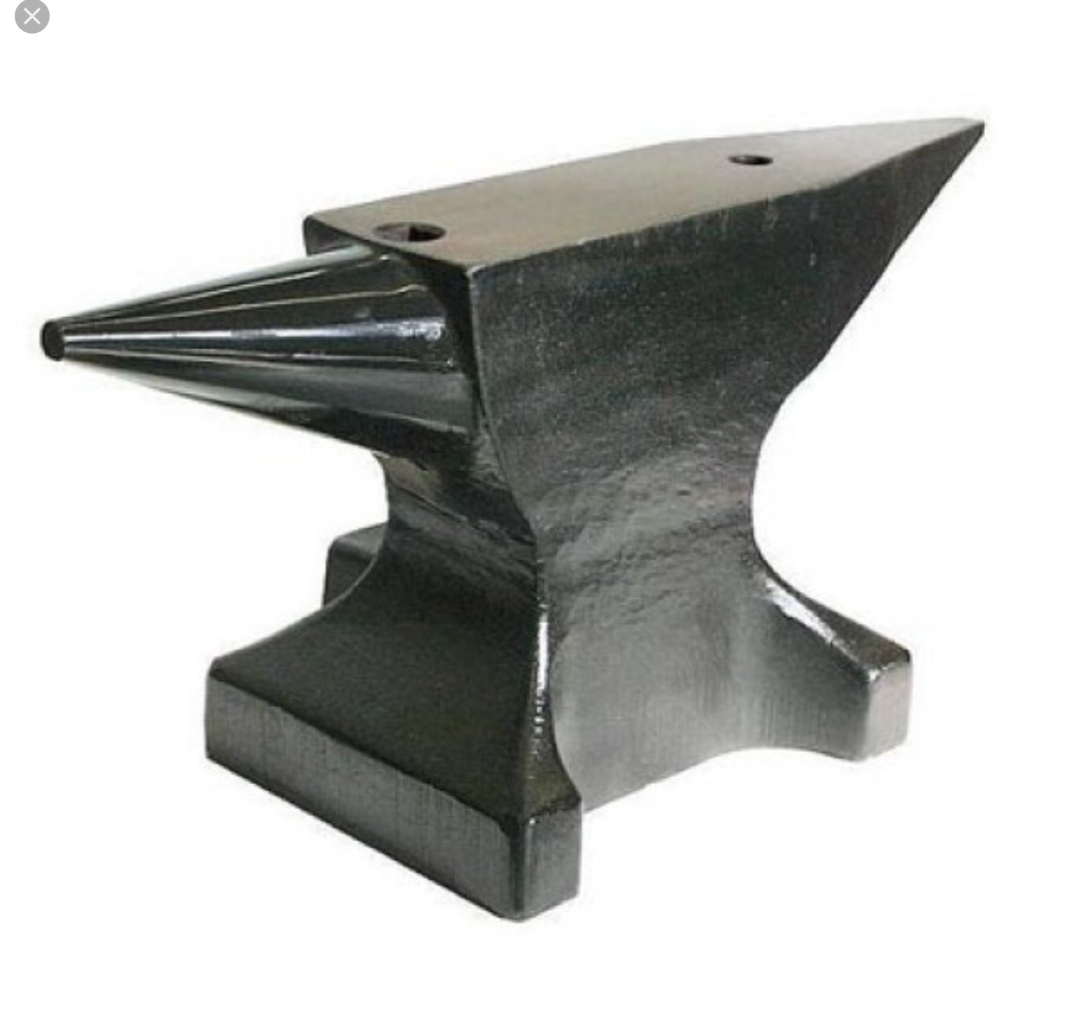

LarryW Posted November 28, 2016 Author Share Posted November 28, 2016 I downloaded an anvil and used it as my inspiration Anvil.pdf Quote Link to comment Share on other sites More sharing options...
ThomasPowers Posted November 28, 2016 Share Posted November 28, 2016 That heel would not work well with my methods of work and items I do; however different people different ways. Quote Link to comment Share on other sites More sharing options...
C-1ToolSteel Posted November 28, 2016 Share Posted November 28, 2016 All I would change is make the heel a little thicker vertically and a little thinner horizontally. Here a comparison to an actual Peddinghaus. Quote Link to comment Share on other sites More sharing options...
ThomasPowers Posted November 28, 2016 Share Posted November 28, 2016 I have an A&H that I use extensively for doing fork work because of it's thin wide heel; I guess you could build a bridge tool. Quote Link to comment Share on other sites More sharing options...

LarryW Posted December 2, 2016 Author Share Posted December 2, 2016 I read somewhere that a large bonfire would put out enough heat to possibly harden the anvil. However, would that harden the whole anvil? And if it did harden the whole thing would it be detrimental to the strength of the anvil? Also I reshaped the heel of the anvil so its not as long and thin, as suggested by some people. I will post an updated picture soon! Quote Link to comment Share on other sites More sharing options...
ThomasPowers Posted December 2, 2016 Share Posted December 2, 2016 You would not need a torch so much as a rocket engine You will have to put a lot of heat into an anvil and heat loss is a power function of the temperature differential as I recall so it gets harder the hotter you need to get it---which is why a furnace helps. As for bonfire; they are sometimes good for a low red but not generally the higher temps---what alloy will you be using as THAT will control time and temp and quenchant and tempering... If you heat the whole anvil but quench from the face with a high pressure fire hose then the body of the anvil should stay softer. Having the entire anvil hard will increase the brittleness so differential hardening and differential tempering is definitely the way to go. Quote Link to comment Share on other sites More sharing options...
Frosty Posted December 2, 2016 Share Posted December 2, 2016 Larry: Have you told your instructor you're wanting to cast 150-200lbs of steel? Casting steel is not a trivial matter and requires a pretty specialized set up. Bringing a steel anvil to critical temperature is another non-trivial matter, I can get 200lbs.+/- to 400f in a couple hours using a 55gl. drum end, 40lbs. of charcoal briquettes and a mattress inflater type blower. How do you plan to quench it? Think about the project for a while. To get the face to critical temp you WILL have to get the whole anvil to so close to critical as to make no real difference. Quenching that much steel is problematical for a couple reasons: First is getting a fast enough chill time to harden it. Second is keeping the residual heat in the remaining mass from drawing the temper to a normalized state. Just getting a good quench isn't easy, water will boil on the contact surface and the steam will insulate the steel so it doesn't chill fast enough to harden there. An oil quench not so much but it will still form a smoke layer to the same effect. You MUST agitate the quench vigorously enough to wash away ANY steam or smoke on the surface. How are you going to pull that off? Have you given it any thought? A fast moving creek, small water fall, etc. and set up your furnace next to it? How are you going to move the really HOT anvil? If you go with an oil quench, do you know how much oil it'll take? While I've never quenched more than about 40lbs. I'd bet a 200lb. anvil would boil 55gl. of oil. Of course you'd want to use a proper quench oil or at least a heat transfer oil. Have you price checked quench oil? This is a much larger project to do yourself than you think, I've been involved in SMALL versions and those were more trouble than the end result was worth. Knowing what I do I'd find an industrial foundry that'd be willing to contribute to your class project and have it cast and heat treated professionally. Heck, if you go about it right they might do it for the tax write off. Frosty The Lucky. Quote Link to comment Share on other sites More sharing options...
LarryW Posted December 2, 2016 Author Share Posted December 2, 2016 Quote Link to comment Share on other sites More sharing options...
ThomasPowers Posted December 2, 2016 Share Posted December 2, 2016 size of the hardy vs pritchel looks off; lots of old tooling with 1" shafts for hardy holes, though the old anvils varied quite a bit and even had irregular hardy holes at times. (not a big issue when you could make everything to fit yourself...) Quote Link to comment Share on other sites More sharing options...
C-1ToolSteel Posted December 2, 2016 Share Posted December 2, 2016 I like the design. I would still make the heel thinner, but that's just personal preference. To give give you my honest opinion, I think it's a WAY too ambitious project. With that being said though, I've never made an anvil over 20 lbs, and I really hope it works out for you. One thing you might want to consider is downsizing it to no more than 150 lbs. That would make everything easier, and with the beefiness of your design, you would still have a very substantial anvil. Quote Link to comment Share on other sites More sharing options...
