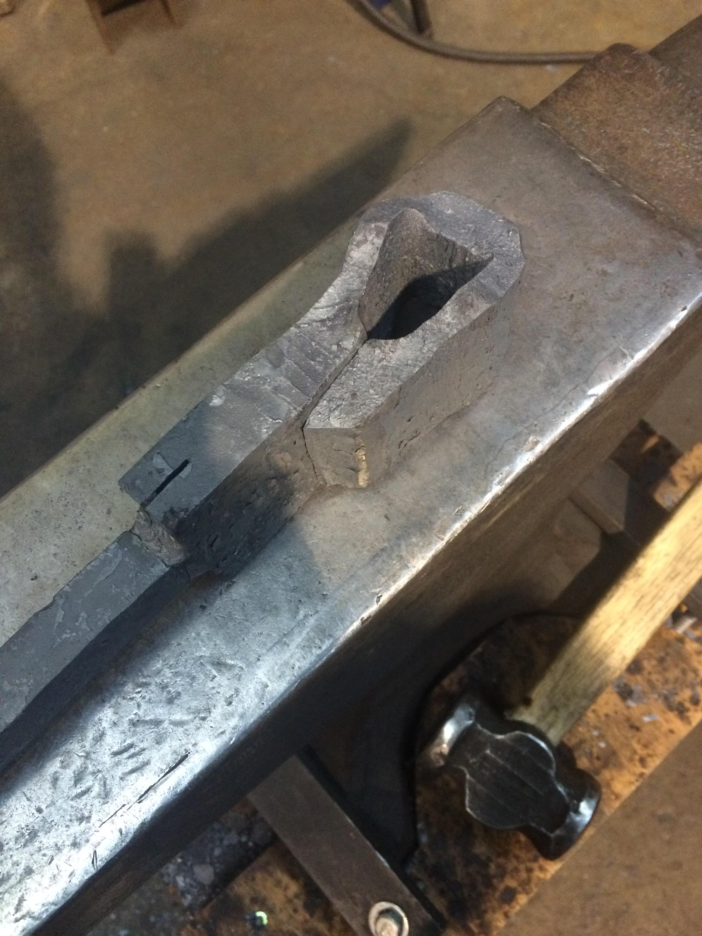

teenylittlemetalguy Posted November 7, 2016 Share Posted November 7, 2016 Recently I got to attend a Viking axe class with Jim Austin. I am super stoked with the results. I have made a few small hawks before, wrap and weld and welded bit but nothing this big. ended up over 1-1/4lbs. This featured a traditional asymmetric weld on the eye and a 1075 bit welded in a mild body. Did I mention I am stoked? Link to comment Share on other sites More sharing options...
Daswulf Posted November 7, 2016 Share Posted November 7, 2016 Wow. I haven't seen them welded like that. Nice work. Link to comment Share on other sites More sharing options...
teenylittlemetalguy Posted November 7, 2016 Author Share Posted November 7, 2016 11 minutes ago, Daswulf said: Wow. I haven't seen them welded like that. Nice work. thank you. I am told that there are tons of examples of them welding the eye this way. I like it myself a lot better than wrap and welds for sure. He had some tricks that made it easier as well. Link to comment Share on other sites More sharing options...
ThomasPowers Posted November 7, 2016 Share Posted November 7, 2016 Perhaps it's an artifact of the machine age; but I've noticed so many people expecting that there is only 1 way to do something. Back when everything was handmade and by different hands at different times and different places a number of ways may have been "common". "Knives and Scabbards, Museum of London" lists one form of classification of medieval knives just based on how the high C edge is welded to the wrought iron body of the knife, (lap, butt, cleft, reverse cleft,....etc and so on) (BTW if you are interested in the using knives of medieval times this is one of the great sources: Archaeological drawings to exact scale, dates, information on metallurgy for several HUNDRED blades! Link to comment Share on other sites More sharing options...

Tubalcain2 Posted November 7, 2016 Share Posted November 7, 2016 nice work. i'm guessing you used a power hammer? Link to comment Share on other sites More sharing options...
teenylittlemetalguy Posted November 7, 2016 Author Share Posted November 7, 2016 1 minute ago, Tubalcain2 said: nice work. i'm guessing you used a power hammer? is this the tubalcain from youtube fame? there was a power hammer used to do the initial prep from bar stock as that is all grunt and not much learning. Link to comment Share on other sites More sharing options...

Latticino Posted November 7, 2016 Share Posted November 7, 2016 14 minutes ago, teenylittlemetalguy said: there was a power hammer used to do the initial prep from bar stock as that is all grunt and not much learning. Not sure where you got the "not much learning" from. I took James's Viking axe class as well, admittedly at a different location, and learned quite a bit about axe forging as well as some good group forging procedures. Perhaps you were just too advanced a smith for the class, but I found Jim to be quite expert and very willing to share his techniques. Link to comment Share on other sites More sharing options...

teenylittlemetalguy Posted November 7, 2016 Author Share Posted November 7, 2016 1 hour ago, Tubalcain2 said: no thats tubalcain. i'm tubalcain2. i have no fame that i know of. its never too late. 8-) 1 hour ago, Latticino said: Not sure where you got the "not much learning" from. I took James's Viking axe class as well, admittedly at a different location, and learned quite a bit about axe forging as well as some good group forging procedures. Perhaps you were just too advanced a smith for the class, but I found Jim to be quite expert and very willing to share his techniques. I meant not much to learn in going from bar stock to the start of the axe, it would have taken a lot of time for not much knowlege. the class however was FANTASTIC. Jim is a great teacher, I couldn't have asked for better. 35 minutes ago, Marc1 said: I don't read his comment like you do. I read ...Powerhammer, short cut, not Vikinglike, only used for the initial menial task. Very nice job mate. yep thank you! only used the power hammer as a short cut. Most all of what you see was my hand work, and a little striking help here and there. Link to comment Share on other sites More sharing options...
