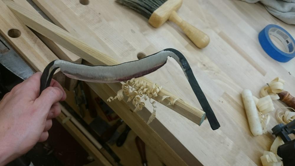

bobasaurus Posted September 16, 2016 Share Posted September 16, 2016 I forged a small drawknife today: Quote Link to comment Share on other sites More sharing options...
stockmaker Posted September 16, 2016 Share Posted September 16, 2016 Thanks for posting. Forging a draw knife is on my list of things to-do, if possible keep the progress pictures coming. The transition between handles and blade is nice, have you done many of these? Quote Link to comment Share on other sites More sharing options...
jlpservicesinc Posted September 16, 2016 Share Posted September 16, 2016 few questions.. Are you working by pattern or drawing? Are you copying or recreating and existing one? A few minutes at the forge can take hours off of grinding.. What are the final plans as to how it will be used.. Reason I'm asking is this determines how the edge both in thickness, shape and handles are decided.. Looking forwards to the finished product.. Quote Link to comment Share on other sites More sharing options...
bobasaurus Posted September 16, 2016 Author Share Posted September 16, 2016 Thanks stockmaker, never forged one of these before. There are a few problems, but it came out okay. After some grinding it will be a decent tool. 1 minute ago, jlpservicesinc said: few questions.. Are you working by pattern or drawing? Are you copying or recreating and existing one? A few minutes at the forge can take hours off of grinding.. What are the final plans as to how it will be used.. Reason I'm asking is this determines how the edge both in thickness, shape and handles are decided.. Looking forwards to the finished product.. Basically just winging it, though I have two commercial drawknifes I looked at beforehand as a rough reference. I splayed out the handles on this one to give more clearance, as the blade is pretty small. The blade curved when forging in the bevel, so I left it. I'm going to grind a flat on one side and a bevel on the other, and use it for all kinds of smaller woodworking tasks. The handles are angled more for bevel-down use than bevel-up. Quote Link to comment Share on other sites More sharing options...
gote Posted September 16, 2016 Share Posted September 16, 2016 You can avoid the curve if you want. It is possible to hit on the side that is going to become the edge to straighten it. Do this as soon as you see it bend. It will not become very much blunter in the process and the little that you get disappears in the next heat. This of course means that you must have an anvil with some length. A sledghammer head is too small. Quote Link to comment Share on other sites More sharing options...

ausfire Posted September 17, 2016 Share Posted September 17, 2016 And what stock did you use? Looks a bit like a shaft from a gas lift or light hydraulic ram?? A bit long though. Quote Link to comment Share on other sites More sharing options...

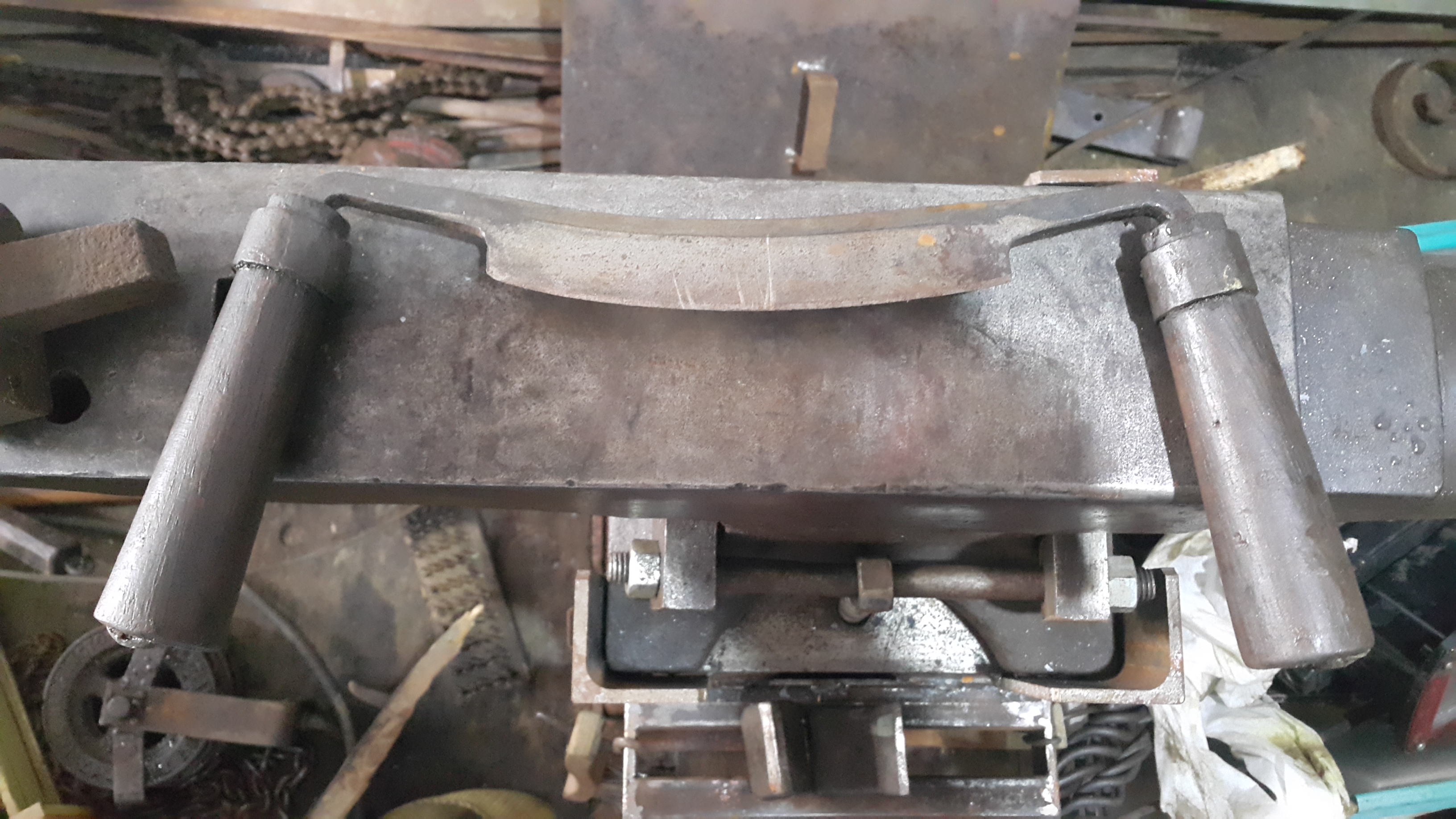

bigfootnampa Posted September 17, 2016 Share Posted September 17, 2016 I'm not sure what kind of handle you intend, but I usually like to forge tapered tangs long enough to extend through the handles and be riveted. Blind tangs with a few barbs to prevent backing out work pretty well too. IMO you have done right to orient your handles for working bevel down... I find that to be much more versatile for most of my work... where needed I don't hesitate to flip the knife though. Quote Link to comment Share on other sites More sharing options...
bobasaurus Posted September 18, 2016 Author Share Posted September 18, 2016 3 hours ago, bigfootnampa said: I'm not sure what kind of handle you intend, but I usually like to forge tapered tangs long enough to extend through the handles and be riveted. Blind tangs with a few barbs to prevent backing out work pretty well too. IMO you have done right to orient your handles for working bevel down... I find that to be much more versatile for most of my work... where needed I don't hesitate to flip the knife though. When you say riveted, are you inserting a rivet through both the handle and tang like a knife, or are you treating the tang like a large rivet and peening the end? I'm not sure what to do for the handles yet, honestly. I have a wood lathe, so I can turn them. Attaching will be tricky. 14 hours ago, ausfire said: And what stock did you use? Looks a bit like a shaft from a gas lift or light hydraulic ram?? A bit long though. I started with 1/2" diameter O1 drill rod. Quote Link to comment Share on other sites More sharing options...
bigfootnampa Posted September 19, 2016 Share Posted September 19, 2016 I either peen the ends over or just bend them over... like a clenched nail. Basically traditional treatment. Quote Link to comment Share on other sites More sharing options...
jlpservicesinc Posted September 22, 2016 Share Posted September 22, 2016 On 9/19/2016 at 9:01 AM, bigfootnampa said: I either peen the ends over or just bend them over... like a clenched nail. Basically traditional treatment. I to the same thing depending on how the handles are finished out.. metal washers on the ends get peened, wood gets clinched.. Quote Link to comment Share on other sites More sharing options...
bobasaurus Posted September 22, 2016 Author Share Posted September 22, 2016 Did you make that drawknife? It looks very clean compared to mine. If I had thought to forge shoulders into the handles then peening would work great... not sure what would keep the handles from riding up with my current forging. Maybe I'll try to get a tight fit and glue, then peen or thread on caps of some kind. Peening might be hard, since I made the whole thing from O1 and heat treated it all. I softened the handles with a torch some, we'll see if it was enough. Quote Link to comment Share on other sites More sharing options...
arkie Posted September 22, 2016 Share Posted September 22, 2016 It may not look "authentic", but you might get a die and thread the tips of the handles then screw nuts on them. Quote Link to comment Share on other sites More sharing options...

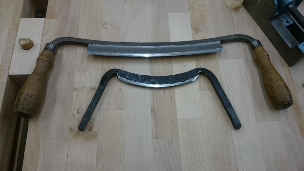

bobasaurus Posted September 22, 2016 Author Share Posted September 22, 2016 I ground and sharpened it today. Still need to make handles... maybe not smart to sharpen it first, but I wanted to try it out. Quote Link to comment Share on other sites More sharing options...
Frosty Posted September 22, 2016 Share Posted September 22, 2016 Looks like a nice spoke shave to me. Nicely done. Frosty The Lucky. Quote Link to comment Share on other sites More sharing options...
jlpservicesinc Posted September 22, 2016 Share Posted September 22, 2016 9 hours ago, bobasaurus said: Did you make that drawknife? It looks very clean compared to mine. If I had thought to forge shoulders into the handles then peening would work great... not sure what would keep the handles from riding up with my current forging. Maybe I'll try to get a tight fit and glue, then peen or thread on caps of some kind. Peening might be hard, since I made the whole thing from O1 and heat treated it all. I softened the handles with a torch some, we'll see if it was enough. Yes. This was made in the blacksmith demo trailer doing demos at a show.. 5160 blade, pear wood handles.. forge welded ferrules.. Water quench. all hand made, no drills, grinders or the like.. Just files, and sand paper.. Quote Link to comment Share on other sites More sharing options...

rockstar.esq Posted September 28, 2016 Share Posted September 28, 2016 jlpservices, That was a very informative post! Thanks. I thought I'd mention that a drawknife often has a slight bevel on the "flat" side so you can finely control the depth of cut. That slight modification can make the tool capable of much finer work. Quote Link to comment Share on other sites More sharing options...
bobasaurus Posted September 28, 2016 Author Share Posted September 28, 2016 3 minutes ago, rockstar.esq said: jlpservices, That was a very informative post! Thanks. I thought I'd mention that a drawknife often has a slight bevel on the "flat" side so you can finely control the depth of cut. That slight modification can make the tool capable of much finer work. Mine has a slight convex curvature on the flat back towards the edge, letting me rock it a bit to control the cut on the flat. This was less intentional than from my inability to grind a perfect flat without convexing it a bit. Quote Link to comment Share on other sites More sharing options...
Charles R. Stevens Posted September 28, 2016 Share Posted September 28, 2016 I find that the old draw knives have a blade design not unlike a razor. The stiff, solid back (most are soft, as many old ones that have been abused are mushroomed) a fuller just infront and then the edge bevel. Often if you lay the stone against the back, and use it as angle gauge (like you do a razor) you can get that nice edge you need on it. Quote Link to comment Share on other sites More sharing options...
jlpservicesinc Posted September 28, 2016 Share Posted September 28, 2016 I prefer mine to be perfectly flat on the back side.. This allows for me to take off just the right amount at a high spot and by running the knife flat I can burnish the wood at the same time.. If I need to take more just change the angle of the draw knife to what ever depth of cut I want.. In the olden days where everything was done by hand.. They had like 1000's of different kinds of draw knives.. Concave, convex, Round, sweeped. Short, long, wide, narrow.. pivoting handles, blades swept forwards, blades swept backwards.. Each had a particular task which it was designed for or more in mind but could also be used for other things.. Some of the concave bladed ones are also designed to be used upside down.. Quote Link to comment Share on other sites More sharing options...
