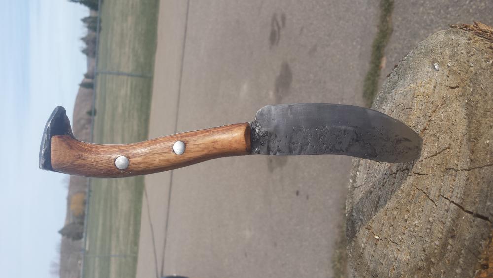

D.C. Posted September 7, 2016 Share Posted September 7, 2016 So, maybe I can post a couple pictures since the O.P. Wanted some ideas. I'll even include a spike "knife like object"..I'll get some more later off my computer Quote Link to comment Share on other sites More sharing options...
