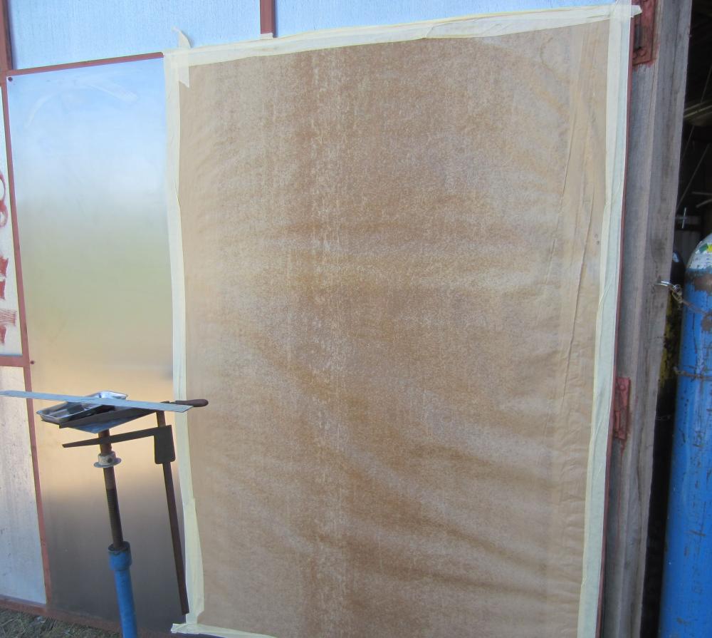

Gergely Posted August 31, 2016 Share Posted August 31, 2016 Dear Folks, Share your experience with us about how you draw your bigger projects! Thank you for your helpful generosity. Facing a new issue made me think what do people use as a drawing board when it comes to bigger drawings. In my thoughts the board has to hold up while hot stock touching it during the controlling of size/shape. My idea was two pieces of 1mm sheet metal fixed on my shop door. So I got 2x2 meters of drawing space. As chalk doesn't like this surface, and precision doesn't tend to like chalk I thought some paper taped to the metal could help. After drawing the shapes to the paper I want to cut out the drawing - making some kind of negative of the drawing. Then spraying some paint on the negative should get the original picture on the metal surface. When it's not needed anymore it can be removed by some solvent. (I sense there could be a simplier way. ) Here is the picture of version 1.0. The next day I had to change the paper and the fixing method because the tape failed to hold. Now it's lighter weight paper fixed with magnets. Quote Link to comment Share on other sites More sharing options...

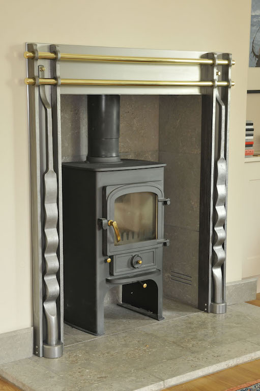

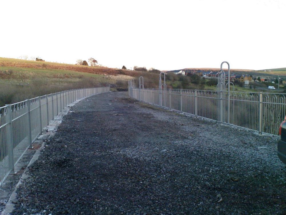

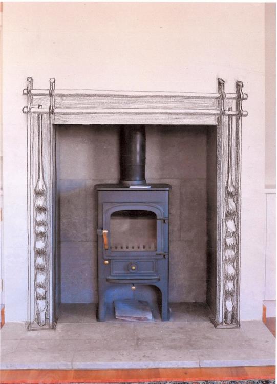

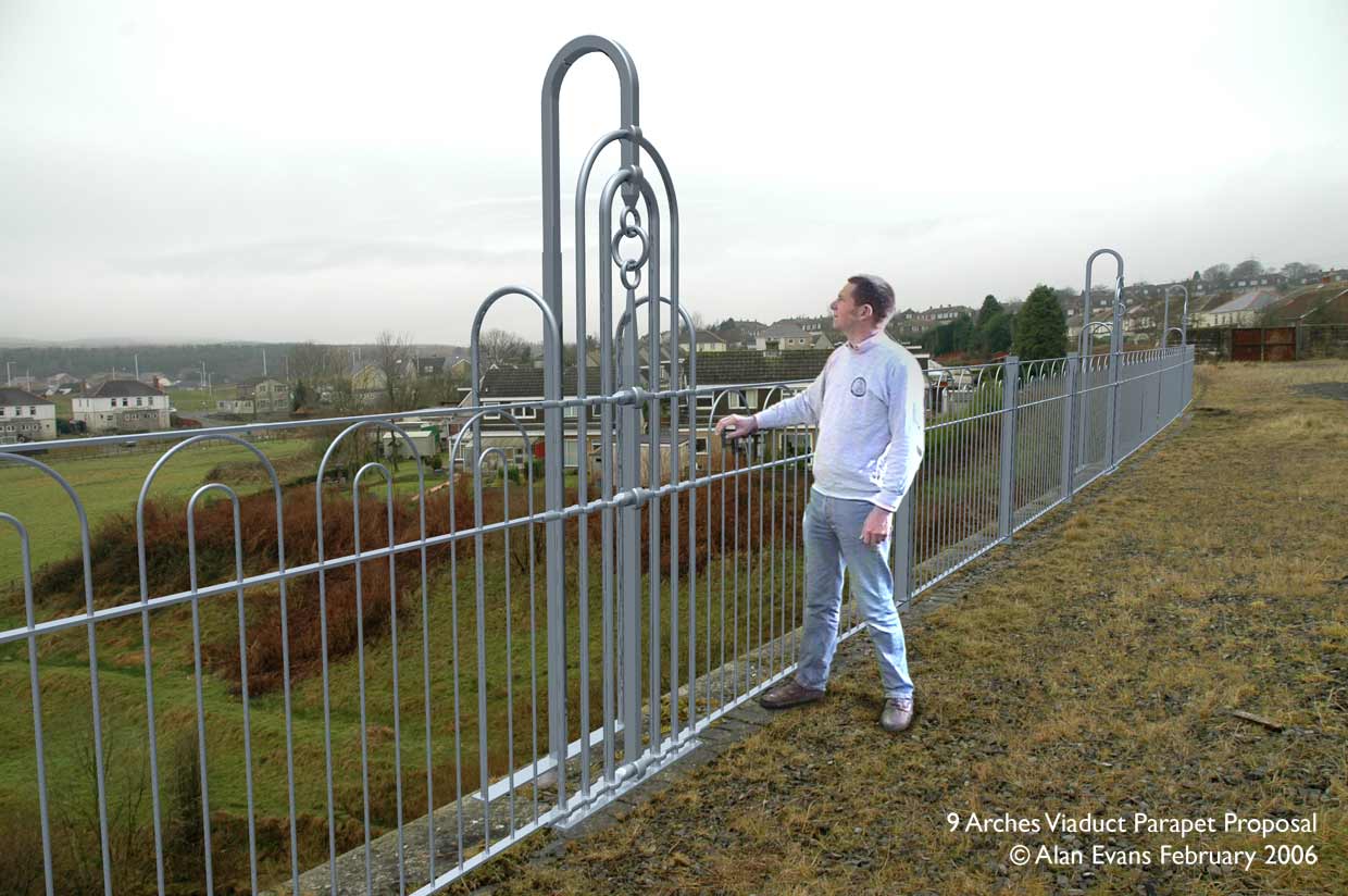

Alan Evans Posted September 1, 2016 Share Posted September 1, 2016 On 31 August 2016 at 10:41 PM, Gergely said: Dear Folks, Share your experience with us about how you draw your bigger projects! Thank you for your helpful generosity. Facing a new issue made me think what do people use as a drawing board when it comes to bigger drawings. In my thoughts the board has to hold up while hot stock touching it during the controlling of size/shape. It all depends on the project and my proposal. I use paper and a Ø7mm (5/16") 4B clutch pencil, in preference for presentation drawings. But often will do a photomontage on a site photograph in Photoshop. Or sometimes draw directly onto a site photo If it is small enough I draw full size on the bench and assemble the piece on the drawing I have a classic AO draughting table with a an X-Y drafting head which is rarely used now apart from as a sketching surface. In the early 1990s I taught myself to use CAD (MiniCad/Vectorworks) and 3D modelling (FormZ) which I used for the big architectural projects. With the later versions of the software you could make up quite convincing photorealist images by superimposing the rendered model on a site photo in Photoshop. The great advantage is that you can be micron accurate over tens of metres which you could never draw out full size. I managed to accurately model a railing scheme for a Victorian railway viaduct on a rising curve over a hundred odd metres long which would have been a pain any other way. The first images of the following pairs are virtual railings if you did not spot it! For full size drawings in the workshop I use the floor, the bench or some 3 x 1.5 metre (10' x 5") birch ply boards with pencil the surface I refresh by a roller and emulsion paint. They can be bolted together for the lay-out drawing and dismantle to use as component lay-on boards. Alan p.s The viaduct can now be called the 999 Arches viaduct... Quote Link to comment Share on other sites More sharing options...

Gergely Posted September 4, 2016 Author Share Posted September 4, 2016 (edited) On 2016. 09. 01. at 1:24 AM, Pine Country Forge said: Soap stone and concrete.... Yeah, that's simply the best - I have a problem though: My concrete floor is too dusty and uneven to use as board. (And nowadays I'm out of horizontal shop space ) For smaller projects I use the upsetting plate which is 15"x20" plate, chalk marks it pretty good. On 2016. 09. 01. at 5:39 AM, SmoothBore said: Well, ... you're not going to like this answer. But my advice would be to forego the life-size "paper dolls", ... and learn to work from properly scaled mechanical drawings. Even the most fundamental CAD drafting software, is an INCREDIBLY USEFUL TOOL. I use AutoCAD every day, for a wide variety of purposes. Finding unknown dimensions, angles, spacial relationships, etc., etc., etc. Yes, You're right SmoothBore. I very painfully lack the skills for using CAD softwares. I've tried to learn one and I haven't gave it up yet, cause I really need it: my head can't do some levels of imagination. I think it will still be necessary to have something "life-size" where the tricky hot shapes can be compared quickly - not having time to have measured the actual angles and sizes. On 2016. 09. 01. at 7:05 PM, ThomasPowers said: I've seen a lot of things drawn on forge hoods; every thing from simple keeping a record of billet folds/welds to details of items being forged That can be a universal thing wherever blacksmiths have hoods... Having no hood I like to use the covering sheet of my springhammer, sturdy notepad On 2016. 09. 02. at 0:40 AM, Alan Evans said: It all depends on the project and my proposal. I use paper and a Ø7mm (5/16") 4B clutch pencil, in preference for presentation drawings. But often will do a photomontage on a site photograph in Photoshop. Or sometimes draw directly onto a site photo If it is small enough I draw full size on the bench and assemble the piece on the drawing I have a classic AO draughting table with a an X-Y drafting head which is rarely used now apart from as a sketching surface. For full size drawings in the workshop I use the floor, the bench or some 3 x 1.5 metre (10' x 5") birch ply boards with pencil the surface I refresh by a roller and emulsion paint. They can be bolted together for the lay-out drawing and dismantle to use as component lay-on boards. Alan Thank you, Alan for those good ideas! And those pictures shown some fantastic work, thank you for sharing us those, too! On 2016. 09. 02. at 2:26 AM, Judson Yaggy said: Draftsight is a freeware version of AutoCad if you already know Autocad but don't want to spend $4k or so. VERY useful. A lot of designers and architects that I work with use Google Sketchup for beta level designs, it helps to be able to receive their files and know enough to roll around thru the drawing and pull some dimensions from it. Free hand drawing on any flat surface is as important as being able to swing a hammer in architectural ironwork. Many many techniques are applicable. For full size shop drawings on nonflammable media I use sheet steel and White Out type correction pens, Presto and Bic white out also work. Doesn't burn or fade, lay a red hot piece of steel on your drawing and the lines stay visible. Also works better than anything I've tried for free hand torch or plasma cutting, a white out line doesn't burn off till the steel is gone. Thanks for the tips JY! I think we had Bic here - it's worth a shot to try. Thank you all for sharing your thoughts and experience! And please keep them coming - pictures too! Best wishes: Gergely Edited September 4, 2016 by Gergely spelling Quote Link to comment Share on other sites More sharing options...
