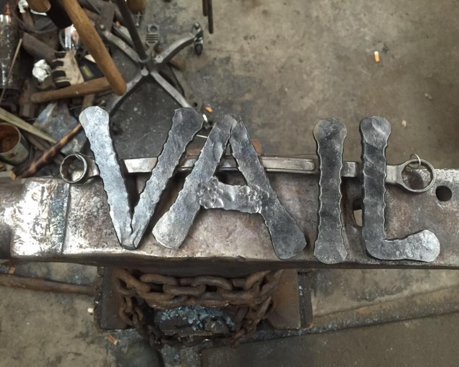

Well I was originally going to try letters made out of wrenches but customer gave me mostly free reign. Wrenches were fighting me as I need to make tongs to handle them.  I mentioned rebar and showed an example. She loved it. The finished project was her idea I wasn't happy with several parts and positions but hey, she's paying the bill. And liked it. This is a gift for her dad in a wedding coming up. Any advise on letters? I know a few things I'd have done different. But opinions and better experience is always welcome.

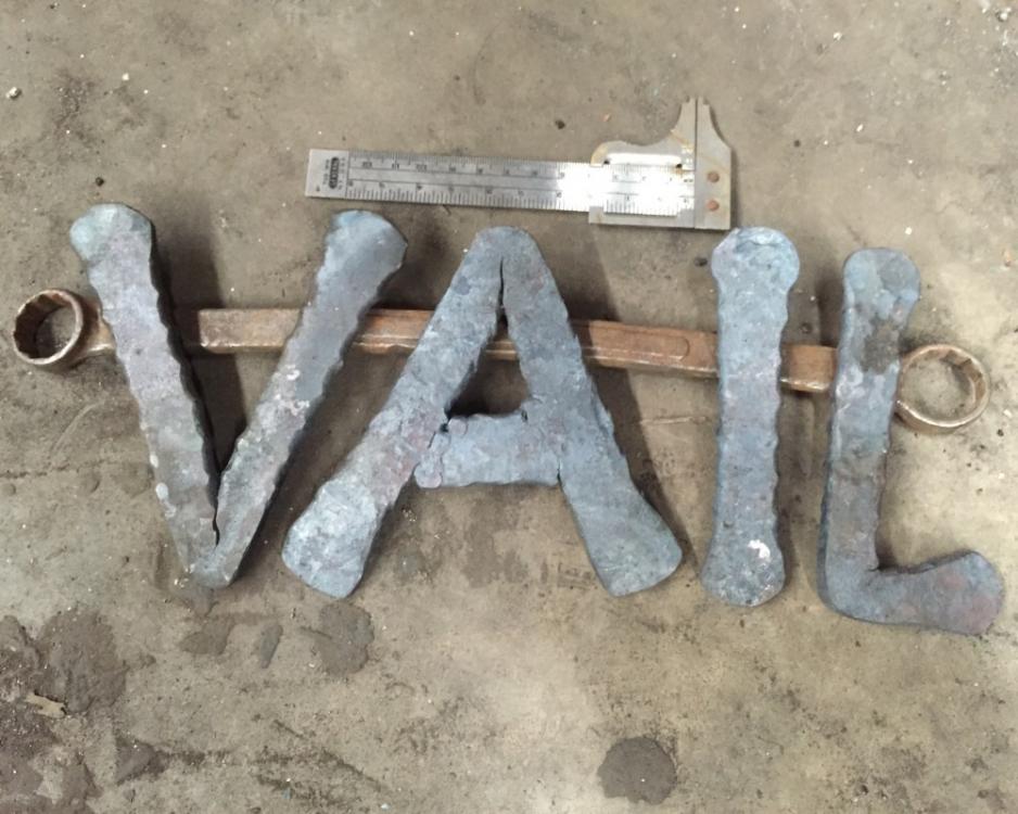

First photo is final product which she was happy with and wanted. Second photo was her layout.
A little perspective on Graphic Design.
In the days when Printers used "moveable type", ( individual letters ) they were taught to space the individual characters, so that the "white space" between each letter was fairly even.
This makes for a more discernible presentation.
In the case of "VAIL" a bit more space between the "V" and the "A", ... and also between the "I" and the "L" would be more pleasing to the eye.
For what it's worth ..........
For what it's worth....I like them, they look good. I would take a flatter to the "A" cross bar joints so they match the smoother finish of the other letters and maybe sharpen the  "L" corner a little (upset?). Depends how much time you want to invest in them. All in all I think the rebar gives a suprisingly nice look to the letters. Very cool!
SmoothBore, thank you for the info, and I agree. I wanted to change the spacing but  this one was how she wanted it. I will use better spacing on any future letters.
Mtnstream, I can see what you mean about the L. I wanted to remake the A entirely as I didn't like it but she insisted I keep it. I wanted to make it match the v better and I botched the cross part.
I appreciate the ideas.
"better" is "more pleasing to the person stuffing money in our pockets".   You might want to do a story board showing how differing  arrangements look.  Could even do it with zeroxed versions of those letters.  I could even see it with the A as the basis and the "side" letters canted along the A's sides.
The L: I'd draw out the corner a bit so you could hammer it back in to square it up a bit on the outside, fast and easy.

I think that it shouldn't look too perfect or it would lose its character.  In fact, I'd weld a large nut onto the wrench in the space between the "A" and the "I" in order to fill the space and add to the tool theme.  Maybe even put one in the center of the "V" as well to balance it out.  The imperfections create the feeling of "work in progress" which is really every tinkerer's mantra.  I'm guessing that is what your client's father is.  Heck, a slightly crooked letter would even work the way I see this piece.  Exaggerating imperfections is the best way to hide them!
Thanks for the idea, btw, I'm stealing it.  I really like the effect caused by the ridges on the rebar.  Not realizing it was rebar when I first saw the picture I thought to myself, "wow, nice craftsmanship making those uniform ridges on the letters!  It must have been a pain to do...."
Thomas, those are good points. Just made me realize if I'd have done the steps differently I could have done better. And the storyboard idea is a good one.
