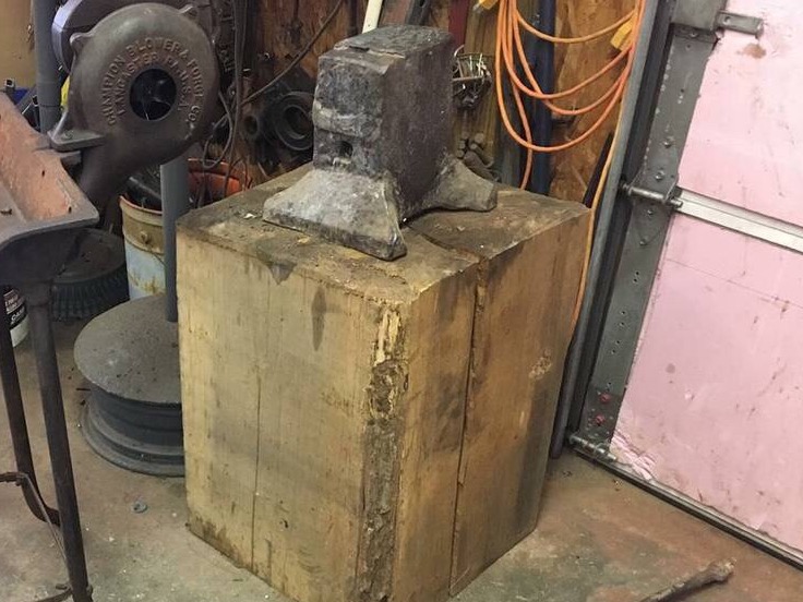

Does this look broken?
On a local craigslist ad a guy has a forge with hand cranked blower a leg vice and a 'bridge' anvil on a hardwood stump. Looking at the pictures it makes me think the anvil use to have a horn and heel but I cannot tell for sure. I'll send the guy a message and see if he can get some better pictures of it. I do know as it sits I don't think I'd pay the $200 he wants for the anvil and stand.image.jpegrimage.jpeg
Not a bridge anvil, but yes, it's like a London-pattern anvil with heel and horn broken off. Looks like part of the steel face is broken off as well.
A bridge anvil really does look like a bridge, as in this post from last July.
I cant tell if it originally had a horn and heel but the roughness where the horn would have been suggests that there could be something missing. If nothing else it looks like a section of the face plate has broken away.
$.25 a pound is value in this condition.  (in my local yard) other than conversation piece, or bad example is of very limited use.
I haven't gotten in touch with him yet so I don't have any additional pictures. However I'm glad other see that it looks like it might have been a London pattern at one point. He didn't mention a weight in the ad so I'll have to see if I can find that out when I finally get an answer. I imagine if the rebound was decent it would make a good striking anvil.

Probably, except that it's missing the hardy hole.
That could be remedied with some time and patience and much more skill than I have and maybe even a little luck might be needed.
Does that top plate look downright dented or is that a trick of the reflection from surface cleaning?  If it's deep dents, it implies a pretty soft plate. If I had to venture a guess, this was used for a specific rough sledging job rather than general smithing.  They beat it like a Michael Jackson tune.
Yes, they did make an anvils which were that shape--this isn't one of them.  It's a handy beating surface but so is any big chunk of steel from the scrap yard, hence it should be about scrapyard pricing.  Doesn't mean it isn't potentially useful, just not worth anvil prices.
yup; not a "collector"  barely a user. Mandatory check the hardness of the face and check for more delamination.  If anything it looks like a saw truing anvil save that it once did have extensions.  Dunning Kruger effect  in action!.  I wouldn't pay over 50 cents a pound and I have bought broken anvils before cheaper than that!
