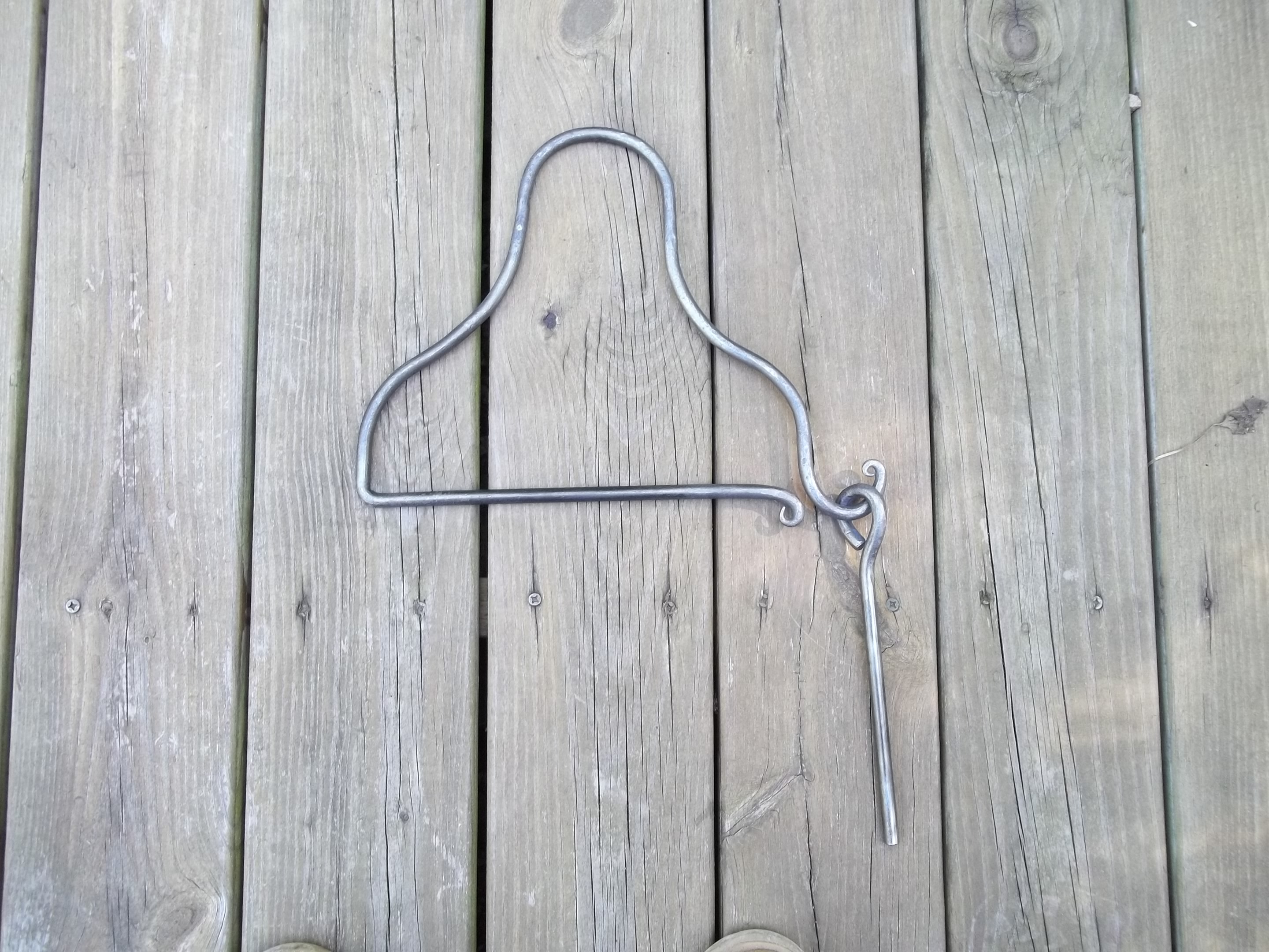

Here is a "dinner bell" shaped like a bell, of course.  Made this one for a blacksmith meeting trade item.  Each side is about 12" long.  Surprisingly, it actually rang like the traditional triangle.
