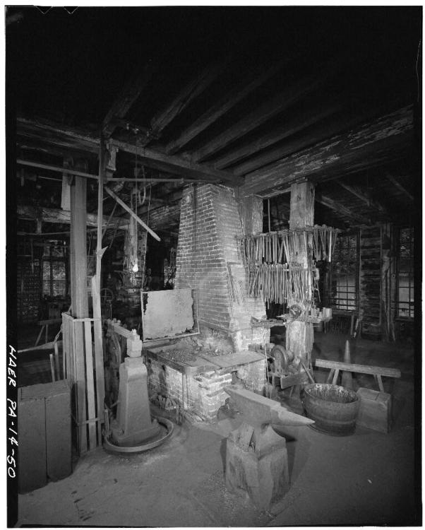

Kozzy Posted August 1, 2016 Share Posted August 1, 2016 We've finally collected enough swages, punches and hammers at the local Ag museum that simply tossing them among the other tools isn't going to cut it any more. They've asked for a hammer rack to better display them as they would have been worked with years ago. I can fab up something pretty easily but none of my initial ideas seem to have that "old-timey"vibe that seems to fit well. I was hoping to see some photos or hear ideas for a rack that would sort of convey the feeling of a dirty old iron working shop that was active from the teens to the 50's...the heyday being about the 40's. It wouldn't have been fancy but sometimes a tiny tweak makes all the difference in look and feel. My limitation is that it needs to be free standing. It's only about 15 hammers right now but room for more would be a good idea. Suggestions or ideas? I always figure it never hurts to ask because you never know when a great idea will pop up out of nowhere. Quote Link to comment Share on other sites More sharing options...

John McPherson Posted August 2, 2016 Share Posted August 2, 2016 Try as I might, I only found one old shop with special built hammer & tong racks. An old wagon shop, of unknown age and location.Two views of forge with racks mounted high up. Quote Link to comment Share on other sites More sharing options...

ThomasPowers Posted August 2, 2016 Share Posted August 2, 2016 May I commend to your attention a search on: Library of Congress pictures blacksmith and blacksmith shop careful peering into backgrounds will show a few tools racked from place to place. Quote Link to comment Share on other sites More sharing options...
Mark Ling Posted August 2, 2016 Share Posted August 2, 2016 so, I did a quick google search, and it seems that most of the tong racks were attached to the end of the forge, and occasionally a small array of hammers. in this pictue though, you can see a hammer and tong rack. Littleblacksmith Quote Link to comment Share on other sites More sharing options...

VaughnT Posted August 2, 2016 Share Posted August 2, 2016 Here's a wonderful example from an Austrian smithy that was turned into a hotel. I think it's important that the rack showcase the smith's talents, and that it's angled so you can see all of the tools hanging there. As soon as I clear some wall space, this will get moved to the top of the to-do list. Quote Link to comment Share on other sites More sharing options...
