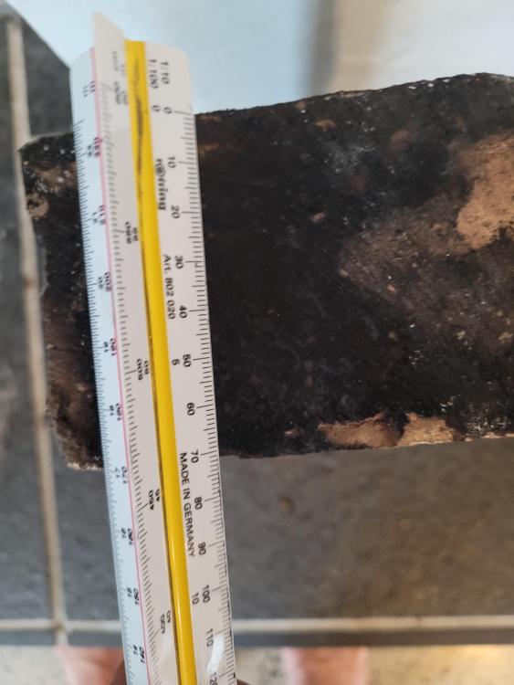

Hello all, not sure if this is the right place to post but here goes.
I am wanting to build a small gas forge and I am thinking if using bricks from a demolished fire place.
First question is: Would they be rated for the temperatures in a forge?
Second question: kinda random but I have seen several tutorials online that say plaster of Paris and kitty liter makes a good refractory cement. Sounds like B.S to me but what do you think?
Thanks in advance
16572541939467561101892484327941.thumb.jpg.8b9685012202b6af70b31585637bd7a5.jpg16572542060789044832697587638747.thumb.jpg.f92d2907eac2b2e9c4c8e6f69696b84f.jpg16572542518257484483850604265635.thumb.jpg.4d46b8b46f5d2e9e4d556d879c28a868.jpg

The short answer to your question, is Yes. I have built Forges with 9 bricks a few times. The burner can enter from the side, bottom or from the back. This type of Forge is not the BEST Design, but it is very functional. it will take 15-20 minutes for the bricks to come up to good heat, Yes there will be a lot of Heat wasted. You will not be welding in a 9 brick Forge, but you will be Forging. The key is, do something and try it. Change it a little and try it again, continue until you are satisfied. Enjoy the Journey, keep track of your creations in a scribbler, what worked. What worked better, etc.....

Hard Firebricks: You will spend more on gas in a very short time than you would have spent on a better refractory, it will take long to heat up and long to cool down to safe temperatures.
As for Plaster of Paris and stuff;  plaster of paris starts to degrade about 1000 degF below good forging temps.  It's a classic example of how BAD information gets spread on the internet---and a good touchstone; I'd not trust anything a site that recommends it has on it without a lot of double checking.

Fire place bricks are NOT rated high enough for forging, it will degrade quickly as in the first time it comes to forging temps.
If you're going to build a brick pile forge use suitable insulating light firebrick. Morgan Thermal Ceramics, K-26 insulating fire brick are rated to 2,600f which is hot enough to forge weld. IF you do it right.
Wrapping the outside of a heavy brick forge in insulation will help keep the room cooler but won't make a heavy brick forge much better than none.
