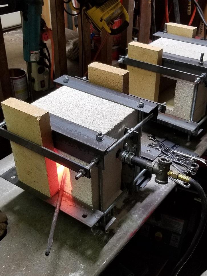

Below is a pic of a clamp together version our club made in a two day burner / forge build clinic.
It's made with 10 K-26 IFBs a few feet of angle iron and all thread, nuts, washers, etc. and is powered by one 1/2" T burner. The club bought the materials in bulk at a discount members paid materials cost + a modest profit. Everybody benefitted including the club the treasury. If your brick is suitable and you have the angle iron, forge and burner are probably $25-$40. The regulator and hose are the next big money item but not bad online.
I took this pic about 3-4 minutes after lighting this one for the first time and a member stuck a piece of steel in immediately. There are IIRC 4 professional bladesmiths in the club who built one of these on a lark and to help support the club none of them light their old forges except on special occasions. One is a locally known axe maker. The chamber is 4.5" x 4.5" x 9" and if a person needed longer slide another one close and enclose the space between with K-26 IFBs for a 20"+ long 2 burner forge. Heck make it as long as you need.
The basic brick pile forge isn't this fancy just lay IFBs flat for the deck, make it larger than the forge chamber and lay brick on edge to define the size and shape. Extra wide is a bit of a problem I resolve by making the sides double thick and cantilevering the roof bricks over the chamber and laying a couple heavy hard bricks on the wall ends to balance.
IFBs are easy to cut with a saw, I use an old carpenter's saw and make burner port holes with an old dull hole saw. You can then make the burner port holes into tapered flame nozzles and improve the burner's performance with a little creative use of a hand drill,  emery cloth and tape. Wear BREATHING and EYE protection !!!
A number of members have discovered these little beasts are all they need and this clinic was IIRC in 2016.
The insides are kiln washed with Plistex and done before they were assembled. We laid a couple cases on a brown paper covered work bench and painted them all at once with a cheap broad paint brush. by time the frames started coming online the bricks were dried enough to assemble. Plistex fire cures and with as little time as we allowed the thickness we applied needs about 30 seconds of burner to dry completely and it's ready to take yellow heat and go to work. Unlike the impatient fellow and the pictured forge, he scraped some of the kiln wash off the forge floor and we gave him a little grief about it. It was a nothing to repair though, just a quick swipe with a brush and fire cured it later. EZ PZ.

Hiya Cam,
Does it feel very light or quite heavy?
Were your cuts done with an angle grinder or a simple hand saw?
Light & hand-saw = Insulating Fire Brick (IFB).
Heavy & Angle-Grinder = Dense Fire Brick.
GOOGLE for "insulating fire brick" and look at images.
IFB's are generally off-white and porous, hard fire bricks are generally pale off-yellow and have a smooth-ish surface.
To me, that picture shows a hard fire brick.
Hope this helps,
Tink!
Tink,
Thank you for the quick reply, I am certain, by your description, that this is not a light fire brick. It is a pale off-yellow colour (maybe with some red?) and it's heavy. I've had to grind a few down (those cuts were already there when I bought them) and they are quite hard to shape.
I was just hoping it wasn't some off-type standard brick, because I doubt that would be very good for a forge, haha.
Cam
