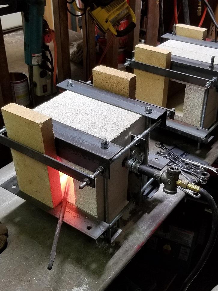

Frosty Posted December 8, 2021 Share Posted December 8, 2021 Welcome aboard Kliff, glad to have you. That's not to shabby for not really knowing what you need. Rather than reverse design a thing I much prefer to start with what I need and work up. Soooo, What kinds of tools do you wish to make? Knives don't require much forge size, 4 1/2" x 4 1/2" x 9" driven by a single 1/2" NA burner is making a number of local blade smiths a decent living here. I'll post pic of the current popular local forge a bit later. The thing that's going to be the main determining size factor is most likely the tools. Whatcha wanna make? Frosty The Lucky. Quote Link to comment Share on other sites More sharing options...

Frosty Posted December 8, 2021 Share Posted December 8, 2021 Oooh, you're going to fit right in here Kliff! I like your second forge, I think it has a lot of staying power while your skills grow. While maybe not ideal, you've already realized you'll build more. BINGO! I don't think any of us who've been playing with propane forges for a while doesn't have a couple few old models collecting dust under a bench or in a back corner. ITC-100 is a legacy kiln wash for decades, much longer than I've been smithing. There are much better available but ITC-100 is stuck in people and organization's minds and probably won't go away. I've posted pics of the Association of Alaskan Blacksmiths burner/forge clinic "no weld forge" before but it's still worth taking a look. I'm not suggesting this one instead of what you've drawn up it's just to show how uncomplicated a forge can be. The club built IIRC 37 of these, burners included in a 2 day build clinic. Buying materials and components in quantity meant they cost just under $100 each. Some of the professional bladesmiths here have all but switched over completely, 2"x2"x6" pattern welded billets are no sweat in it. This pic was take less than 5 mins. after lighting, the bar is 1/2" round hot rolled. It's heated by a 1/2" T burner and will melt your work if you don't pay attention. The IFBs (Insulating Fire Bricks) are Morgan Ceramics, K-26. Frosty The Lucky. Quote Link to comment Share on other sites More sharing options...
Kliff Posted December 9, 2021 Share Posted December 9, 2021 I like the "door" design. I was just going to stack bricks. That would keep my fat fingered clumsy hands from knocking them all over the place while I'm working. Quote Link to comment Share on other sites More sharing options...
