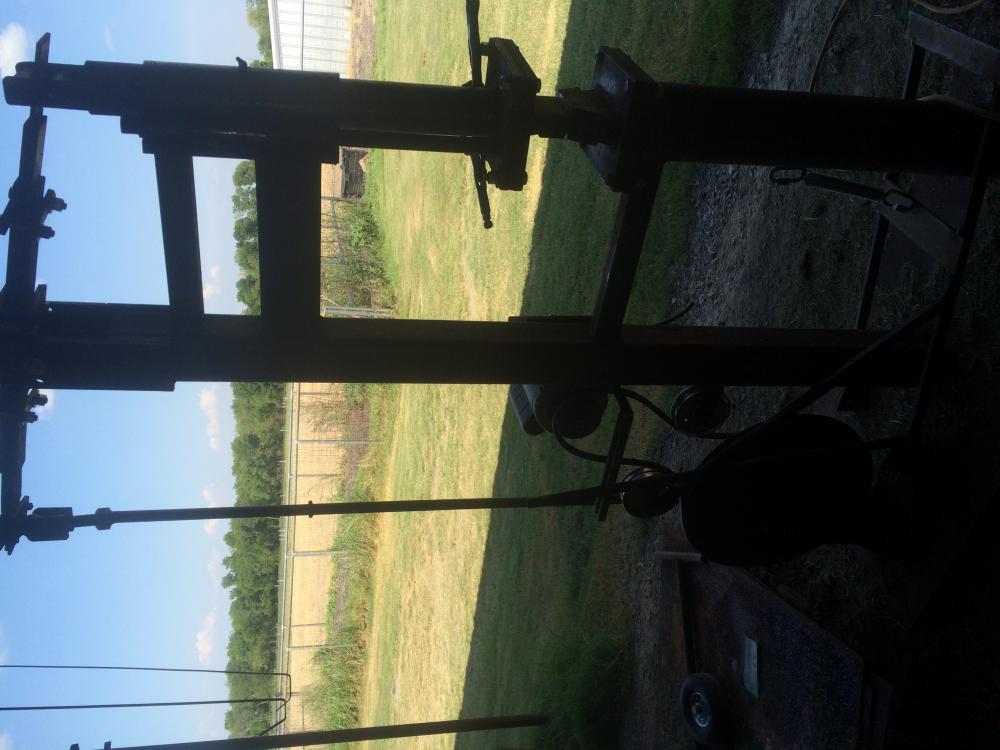

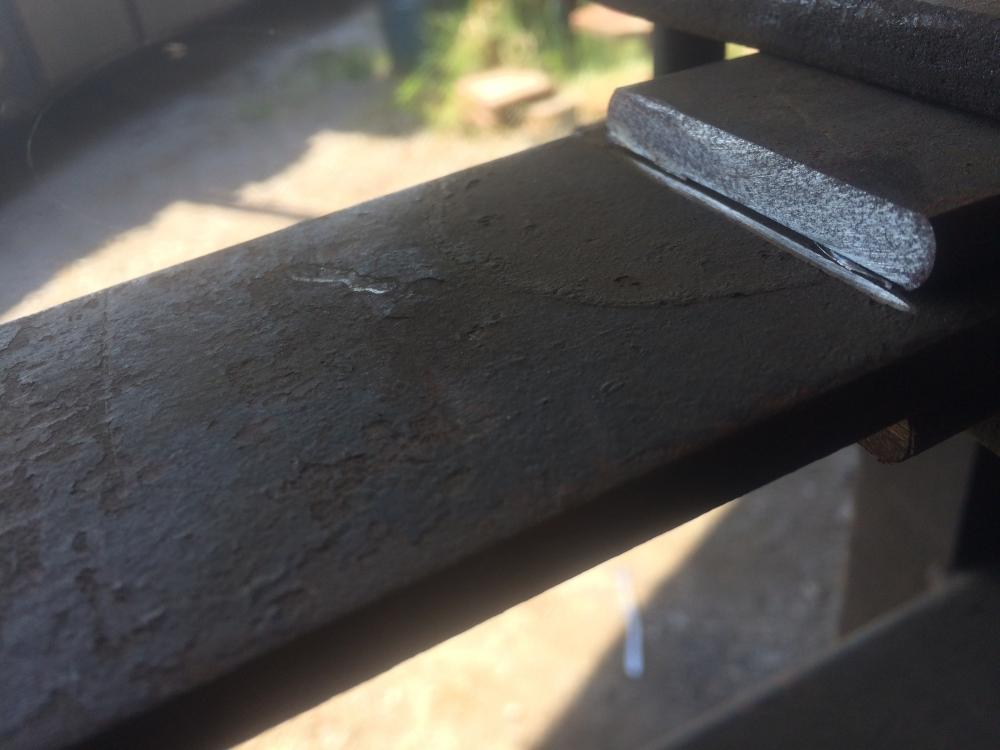

Wroughtnharv Posted July 1, 2016 Share Posted July 1, 2016 We picked up a couple of the Applachian style hammers the other day. Each one had some issues and I'm trying to work my way through one of issues on this one. It hits really hard and there is no way I can see to feather it for light hits. If you look at the head you will see they added some weight because they said it didn't hit hard enough. I'm thinking this might be the problem because it appears they almost doubled the head weight and didn't alter the spring to accommodate it. The spring has an arc when the head is resting on the anvil and the cam pin on the wheel is at TDC. The belt grabs the motor pulley when the motor is rocked forward. It's a very direct connection and I don't see where the use of an idler pulley system would change anything. This is the first experience with this kind of power hammer and any advice would be very much appreciated. I had a fifty pound Litlle Giant about twenty years ago but sold it because I didn't use it enough to justify having it. This hammer hits about the same from the get go as the LG did when asked to hit hard. I've got to finish the foot linkage assembly. I wanted to have a foot pedal that could be operated from about a range of 120 degrees. I also want the linkage to be tucked back out of the way so it won't be as easy to accidentally engage the hammer, I don't need a potato chip instead of a finger. In the next day or so I will do a video with it working on some hot bar so the learned here and have some information to work with. I appreciate the help and will have the phone with the camera and service available if someone needs photos to see details. Quote Link to comment Share on other sites More sharing options...
VaughnT Posted July 1, 2016 Share Posted July 1, 2016 I think you're definitely onto something with the spring pack. Looking at the bottom spring, it appears almost 1/2" thick. If that's the case, it's way too thick for that length and isn't really springing at all. Rather, it's acting as a stiffener for the long bar which is doing all the work and not getting nearly the support it needs. One of the reasons it doesn't "hit hard" and needed the extra weight welded to the head is that the anvil sucks balls. Even if the table it's sitting on is 4" thick, there's plenty of give because there are so many joints between the anvil and the ground. It looks like the sow block is attached to the mid-plate which is attached to two legs that go down to the main plate. Ideally, you want a direct line of fire between the hammer and the earth, not all those joints and spans. Even a really thick plate will have an element of give to it. When folks say the anvil portion should weigh a lot, that means to get as much mass directly under the hammer as possible. Having a 4" thick slab a mile away doesn't benefit the hammer. Otherwise you could weld an anvil to the side of a battleship and claim it's a million-pound anvil -- and we all know that won't work. Make sense? Quote Link to comment Share on other sites More sharing options...

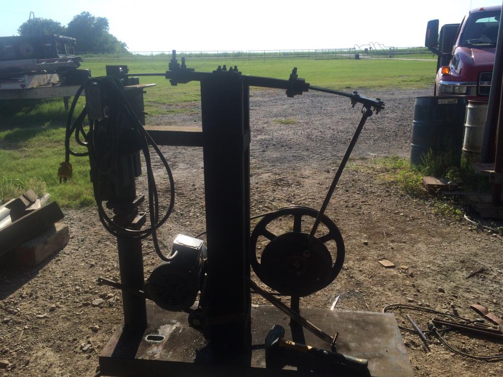

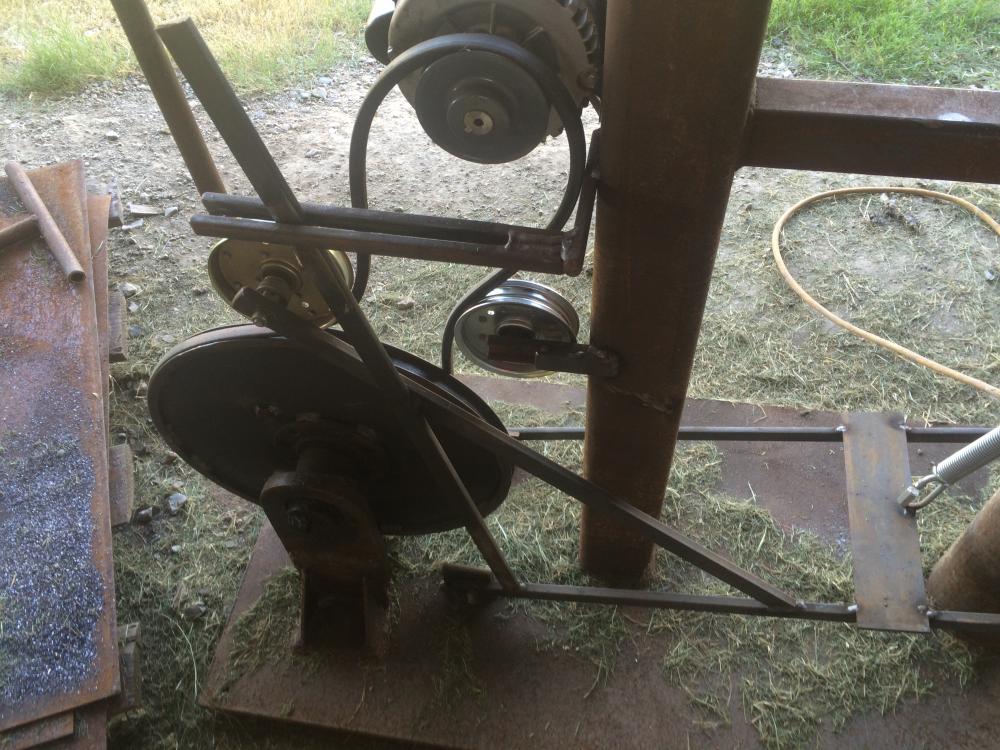

eseemann Posted July 1, 2016 Share Posted July 1, 2016 6 hours ago, Wroughtnharv said: We picked up a couple of the Applachian style hammers the other day. Wroughtnharv, was someone selling a used hammer or making them to order. Can you tell me what your motor's RPM is, the ram weight is and your large/small pulley sizes are. The photo with the hammer with the farm in the background looks like something in a magazine. Look forward to seeing it work. Quote Link to comment Share on other sites More sharing options...
Wroughtnharv Posted July 1, 2016 Author Share Posted July 1, 2016 2 hours ago, VaughnT said: I think you're definitely onto something with the spring pack. Looking at the bottom spring, it appears almost 1/2" thick. If that's the case, it's way too thick for that length and isn't really springing at all. Rather, it's acting as a stiffener for the long bar which is doing all the work and not getting nearly the support it needs. One of the reasons it doesn't "hit hard" and needed the extra weight welded to the head is that the anvil sucks balls. Even if the table it's sitting on is 4" thick, there's plenty of give because there are so many joints between the anvil and the ground. It looks like the sow block is attached to the mid-plate which is attached to two legs that go down to the main plate. Ideally, you want a direct line of fire between the hammer and the earth, not all those joints and spans. Even a really thick plate will have an element of give to it. When folks say the anvil portion should weigh a lot, that means to get as much mass directly under the hammer as possible. Having a 4" thick slab a mile away doesn't benefit the hammer. Otherwise you could weld an anvil to the side of a battleship and claim it's a million-pound anvil -- and we all know that won't work. Make sense? Vaughn you are a heckuva a lot smarter'n than you look. What you said makes a ton of sense. As for the anvil, they've got a piece under the anvil that is a direct shot straight down to the base, there are three legs under the anvil, one in the middle. BTW I have a 927 lb chunk of steel that I used to use for my anvil stand, claimed I had a 1,000 lb anvil, didn't work that way though. I have some 4" tubing with 3/4" wall thickness that I can use for the anvil, let me think about it. One other thing, the bow in the spring bothers me, do you think I should change the connecting rod length to have it straight when sitting at TDC on the flywheel and resting on the anvil? Thanks again 1 hour ago, eseemann said: Wroughtnharv, was someone selling a used hammer or making them to order. Can you tell me what your motor's RPM is, the ram weight is and your large/small pulley sizes are. The photo with the hammer with the farm in the background looks like something in a magazine. Look forward to seeing it work. I'm the wrong one to be asking those kind of questions. The hammers were available at a price that we thought reasonable and picked them up. The motor came with a couple of different pulleys and I chose the smallest to make it easier on the motor and slow down the operation. Quote Link to comment Share on other sites More sharing options...
arftist Posted July 1, 2016 Share Posted July 1, 2016 If it is hitting too hard move the Pitman arm connection to the spring closer to the center of the spring and remove the extra weight from the head. Also straightenting the spring will ease the harmonic imballance. Straaightening can be done cold by a spring shop. My main concern right now would be the final ratio; how many blows per minute is it geared for? The heavier the head the slower it should travel. How heavy is the head? What is the final ratio? With this info you can get within the basic parameters then fine tune. Finally about power hammer anvils; a good working anvil weighs 10 times the tup (moving part of the hammer). A better one weighs even more, with 20-1 considered the point of declining returns. As little as 6or 7-1 will work but with a notable drop in performance and is not reccomended. Lastly but most importantly a hollow anvil is useless. The anvil must be solid. Quote Link to comment Share on other sites More sharing options...

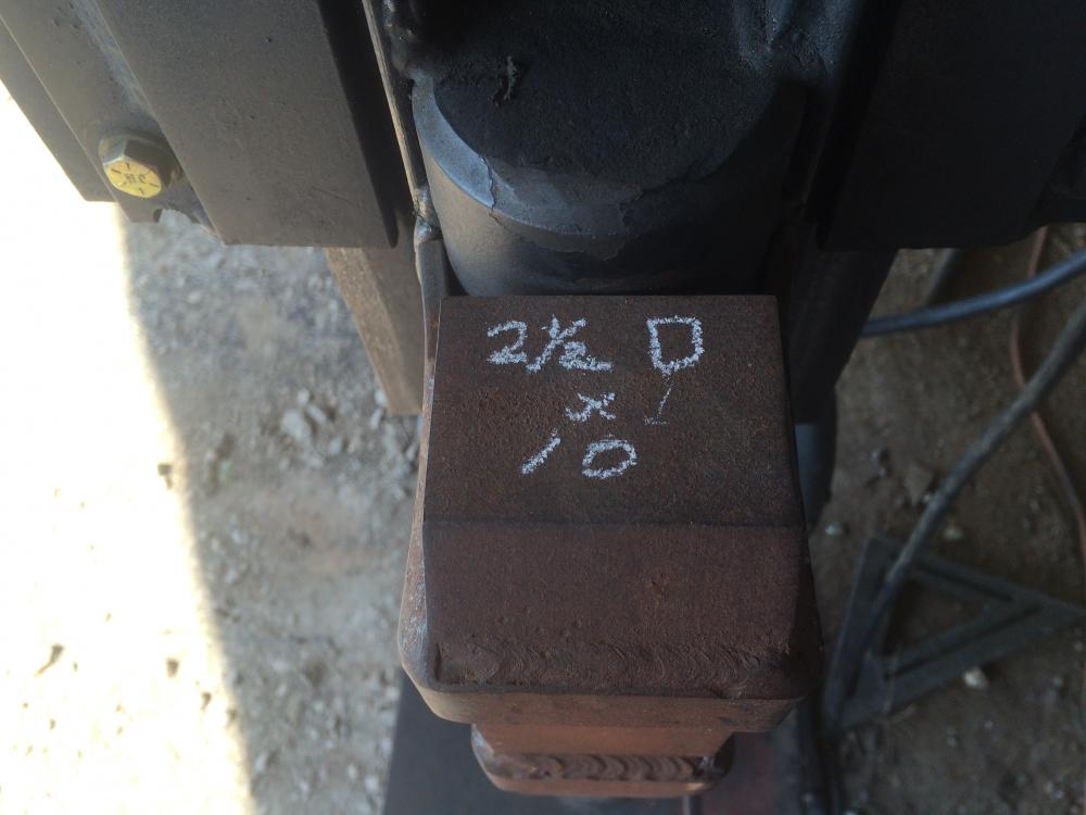

VaughnT Posted July 1, 2016 Share Posted July 1, 2016 6 hours ago, Wroughtnharv said: As for the anvil, they've got a piece under the anvil that is a direct shot straight down to the base, there are three legs under the anvil, one in the middle. BTW I have a 927 lb chunk of steel that I used to use for my anvil stand, claimed I had a 1,000 lb anvil, didn't work that way though. I have some 4" with 3/4" wall thickness that I can use for the anvil, let me think about it. The real issue is the joints and spans they created. While the center column (sow block/anvil) might be a straight shot down to the ground, you can see how it's not one continuous run. Instead, the top 2' is welded/joined to the thick plate. Then that's welded/joined to the legs underneath that go down to the bottom-most plate. All of those junctions rob efficiency. When you add up the actual weight that's below the top die's impact point, it's not nearly as high as it should be if they wanted to match everything together. What I'd do if I had my druthers, is to cut everything away that's below the tup. Just go at it with an O/A rig and rip it all out. Then bring in that beast of an anvil stand and set it directly under the tup. With a 927-pound sow block, it's be small work to make some replaceable dies to fit it. A lot of the self-contained hammers use the same two-piece construction technique to make it easier to move and align things, so we know it works well. Then it'd just be a matter of cleaning up the rest of the hammer, replacing the pulleys and fixing the spring pack. To give you an idea how stiff the spring pack can be, here are some pictures I've pulled off the interwebz in preparation for my own hammer build..... I particularly like this design because it illustrates what I was saying about ripping loose the sow block you've got. Professionally made back in the day when smiths were common, it's a solid design and just need to have an anvil mounted to be put back into service. In both instances, you can see that the spring back doesn't need to have a lot of flex like you might expect. All it's supposed to do, imo, is take up the shock of the hit so it's not transferred back through the system where it can damage the more fragile components. Quote Link to comment Share on other sites More sharing options...
Wroughtnharv Posted July 2, 2016 Author Share Posted July 2, 2016 Thank you for your patience with me Vaughn. I'm in the autistic spectrum which means I am luckier than most people when it comes to figuring things out, I just have to convert it into my way of thinking to get it to sink in. The way I see it the anvil on this hammer weighs about 90 lb according to the calculator. The original hammer weighs about 18 1/2 lbs and the add on is about 17 3/4 lbs more total of 36 1/4 pounds, less than 1 to 2 in your formula. Using the 927 lb chunk of steel is out because it serves as down pressure on the box blade, works like a fire hose in a water fight with the kiddos for that. I have a great working relationship with two scrap yards. One of them will sell me bulk at $.10 lb so I can probably find a block or cylinder of solid that weighs about 400 lbs for the anvil, this is doable. If you can double check my math. Back in the day I was pretty good at it in my head but that was then and this is now, dyslexia is coming out of nowhere occasionally and I have to triple check the math and sometimes still come up with four different answers. Quote Link to comment Share on other sites More sharing options...
Wroughtnharv Posted July 2, 2016 Author Share Posted July 2, 2016 If you look at the hammer head on you will see that the anvil is welded to the channel and then another piece of the same material is welded in between the channel and the heavy angle base. There are two pieces of heavy wall tubing on each side of the anvil between the channel and the base, one on each side. The total of the anvil is 32" of 3 / 1/2" solid bar. I am going to pull the piece of round bar out between the channel and the new base plate on the frame. I will build a new section between the channel and the new base plate out of half inch plate. This will make the main beam solid from the new base plate to the hinge point at the top. I will remove the rear legs because they aren't needed with the modification. The main spring leaf is 1/4" X 2 1/2" X 38" and where the additional leaf contacts it there are Knicks in the main leaf. I see this as a problem. So Vaughn based upon your photos and what you said I understand that too much spring rate is better than not enough, right? I can order a new flat spring that is thicker and then add to the connecting rod so that the new spring will be straight when at rest, right? Thanks again for your patience. Quote Link to comment Share on other sites More sharing options...

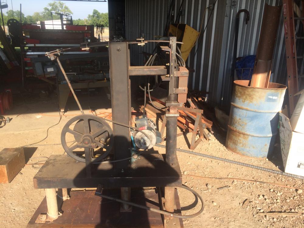

VaughnT Posted July 4, 2016 Share Posted July 4, 2016 The second hammer looks pretty decent. The spring looks to have sufficient stiffness and the anvil goes all the way to the ground. The anvil still looks a little wimpy, but it's at least serviceable. On the first hammer, if you want to give it the best chance of being a winner, you'll definitely need to replace the anvil with something solid. The fact that there's a column on both sides doesn't really help because it's still a very small "anvil" and you have some significant breaks in the energy transfer -- never mind that both bars seem to be leaning a few degrees off plumb. I still recommend cutting that stuff out and replacing it with a more monolithic construction. Here's a good photo of a fellow welding up several large plates to act as the sow block for a power hammer. Because each plate goes straight to the ground, you get the maximum performance possible. Using plates makes the assembly a bit easier if you don't have access to a solid block. Quote Link to comment Share on other sites More sharing options...
Wroughtnharv Posted July 6, 2016 Author Share Posted July 6, 2016 What would we do without the internet???? Okay guys, here's the plan. I've got a scrap yard that treats me good (ten to fifteen cents per pound) and they are searching high and low, other scrapyards as well, for me some 6" diameter round or square solid stock for anvil material. I've already grabbed three point top link for the pitman arm. And in the next day or three I'm going to cut out the anvil on the first machine. If the heavy stock is located and picked up then I will go back with it. If it isn't then I will box in the 3 1/2" round stock with 1 1/2" X 4" bar stock to give it some substance. The first machine will end up looking like a squatty body second machine. Quote Link to comment Share on other sites More sharing options...
