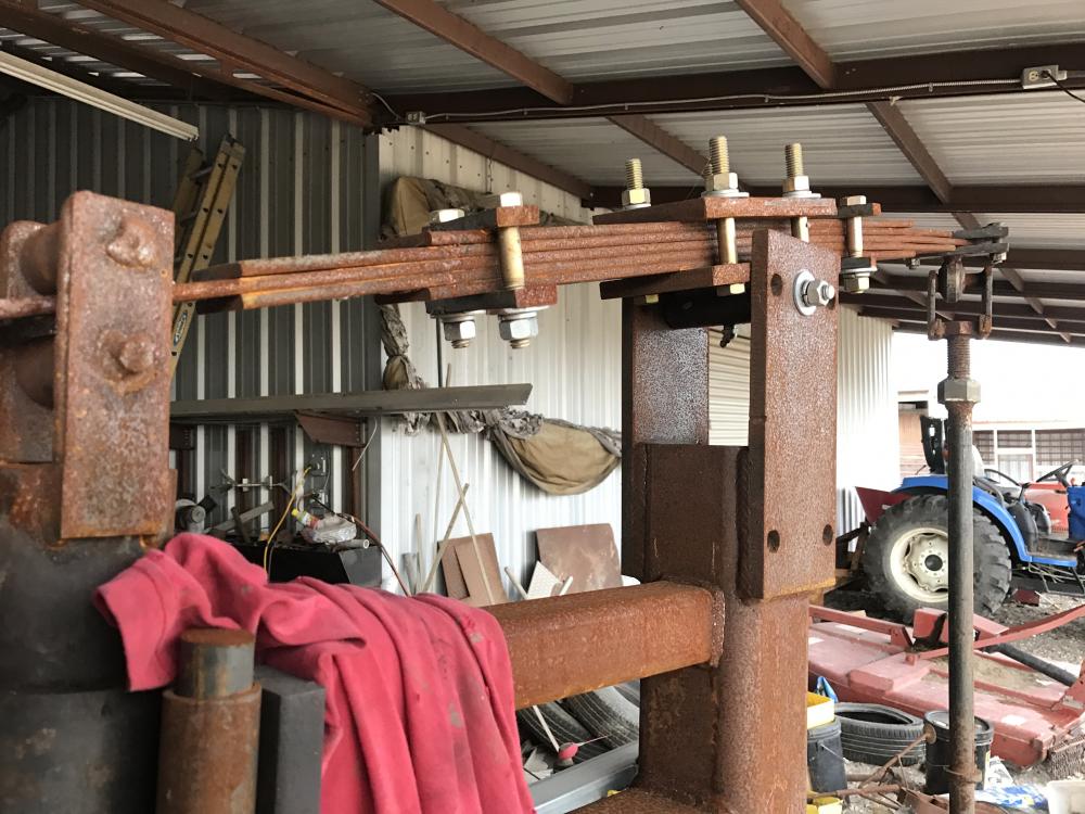

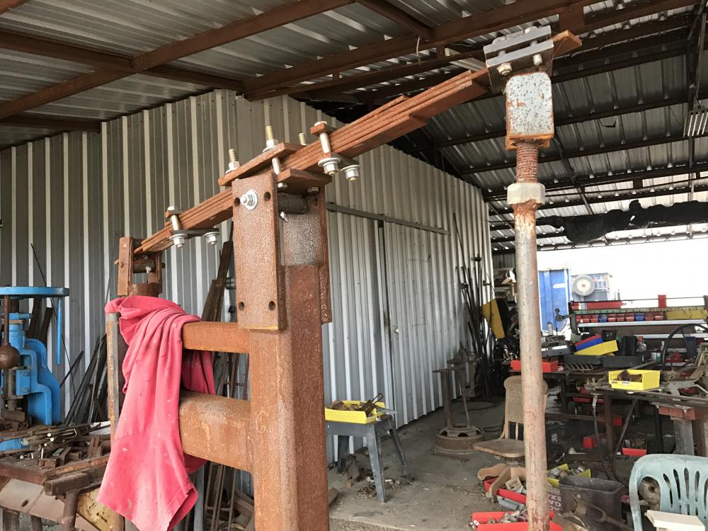

We bought the two hammers together.  My bud wanted the shorter one because it fit better in his shop area.  So before we head out for our great RV adventuring one oh one I'm going to make sure the shorter hammer functions well enough for bud to enjoy it.  The old spring set up is at THE spring shop in Dallas according to reputation.  The master spring guy has a full plate with normal vehicle spring stuff, even though they are basically a blacksmith shop for custom leaf springs he told me he will make me what I want because he doesn't have a clue about what we need.
Here's my plan: multi leaf assembly based upon the tall hammer with five springs 2 1/2" wide and 5/16ths thick.  The biggest difference is the overall length, 38" vs 40" and the shorter springs will be longer by a couple of inches.  The connecting rod will be made from a tractor three point top link so we get the adjustments we need when using tooling.
I've modified the anvil portion of the hammer and will go over that in a couple of days.  Monday I will call the spring master and give him the above instructions.  Concerns and advice is appreciated.
