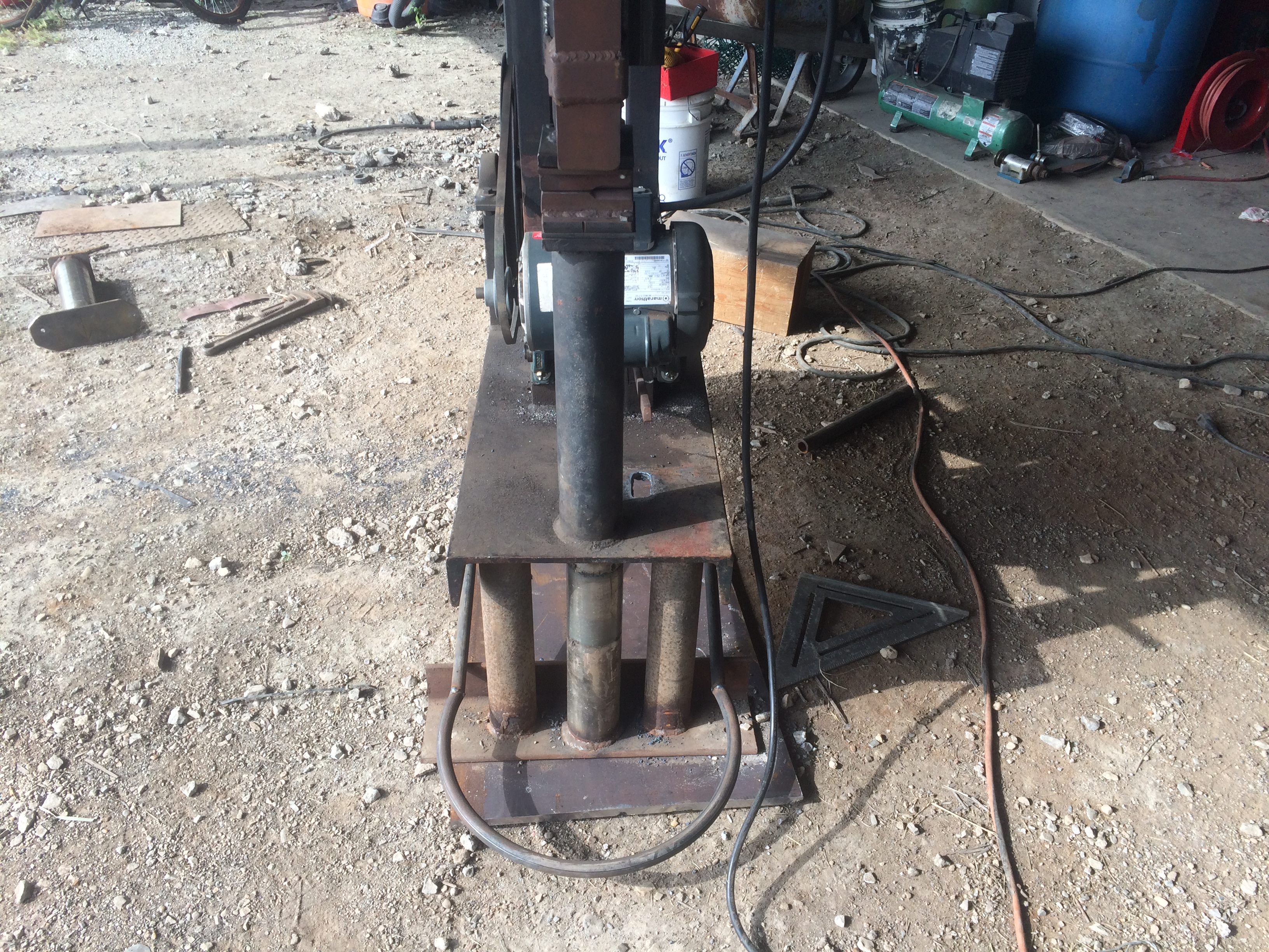

What would we do without the internet???? Okay guys, here's the plan. I've got a scrap yard that treats me good (ten to fifteen cents per pound) and they are searching high and low, other scrapyards as well, for me some 6" diameter round or square solid stock for anvil material. I've already grabbed three point top link for the pitman arm. And in the next day or three I'm going to cut out the anvil on the first machine. If the heavy stock is located and picked up then I will go back with it. If it isn't then I will box in the 3 1/2" round stock with 1 1/2" X 4" bar stock to give it some substance. The first machine will end up looking like a squatty body second machine. -

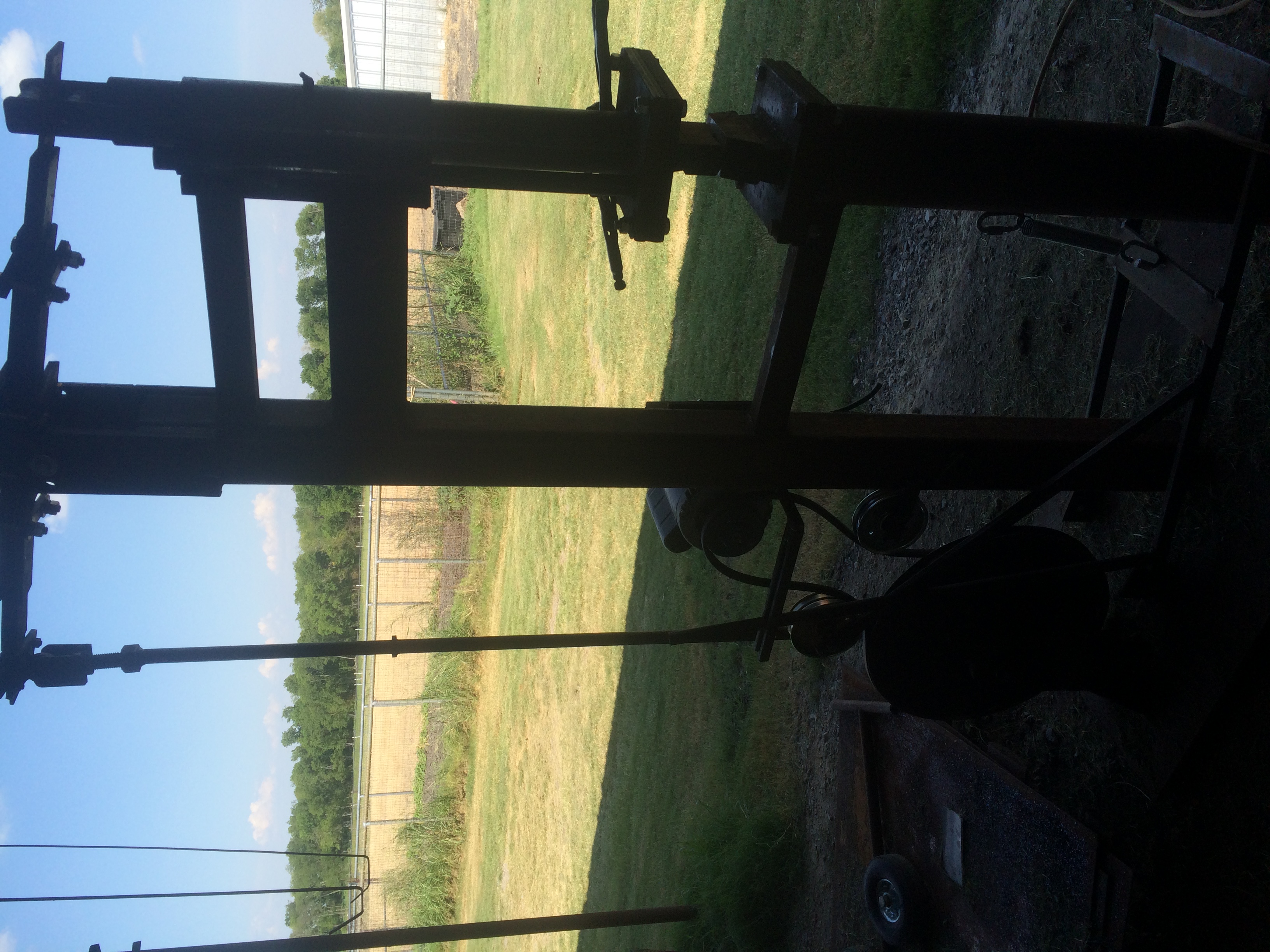

This is the second hammer. It will go in my shop. The first hammer will go to another shop and we want it working as well as possible before we install it. -

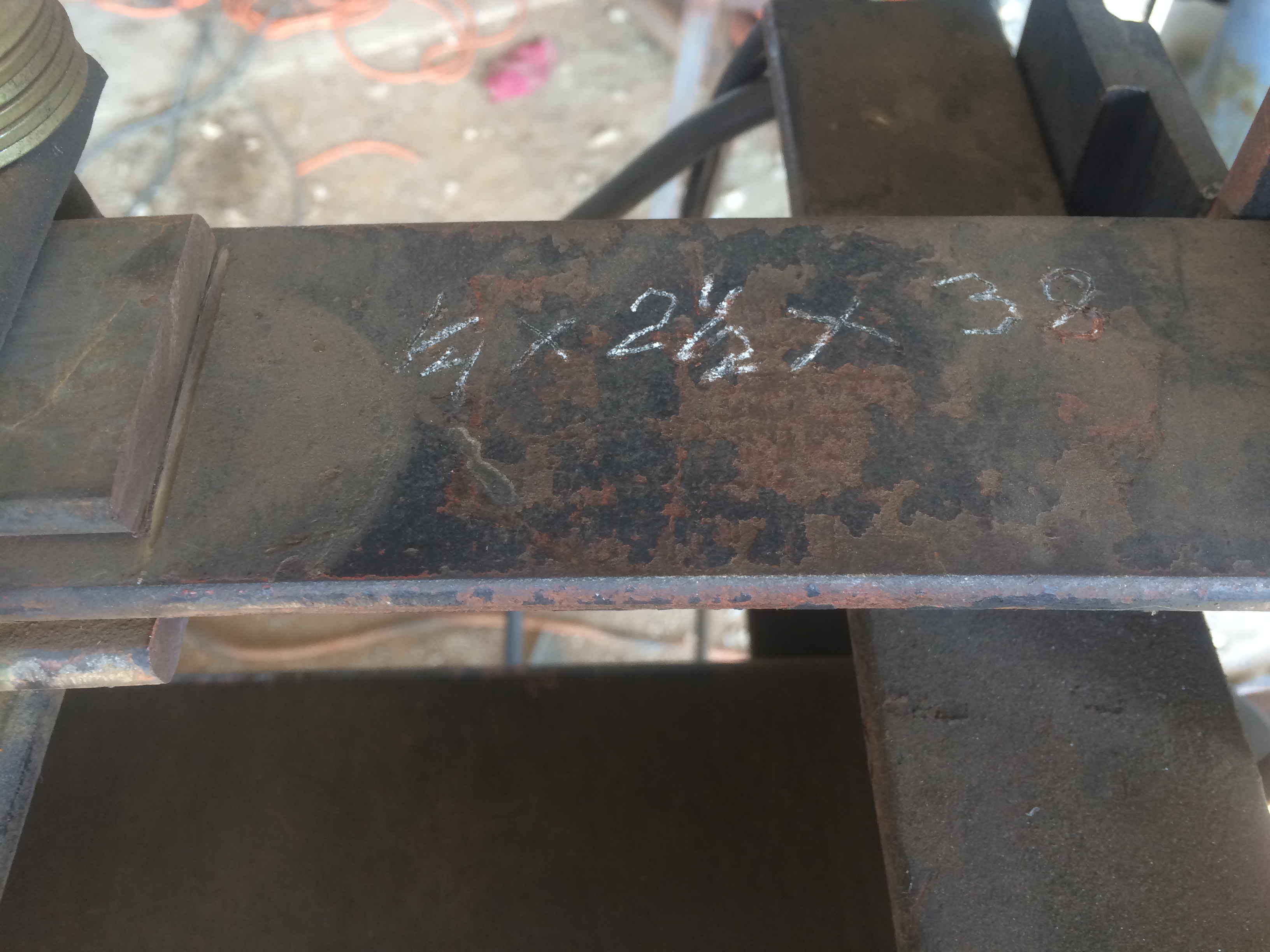

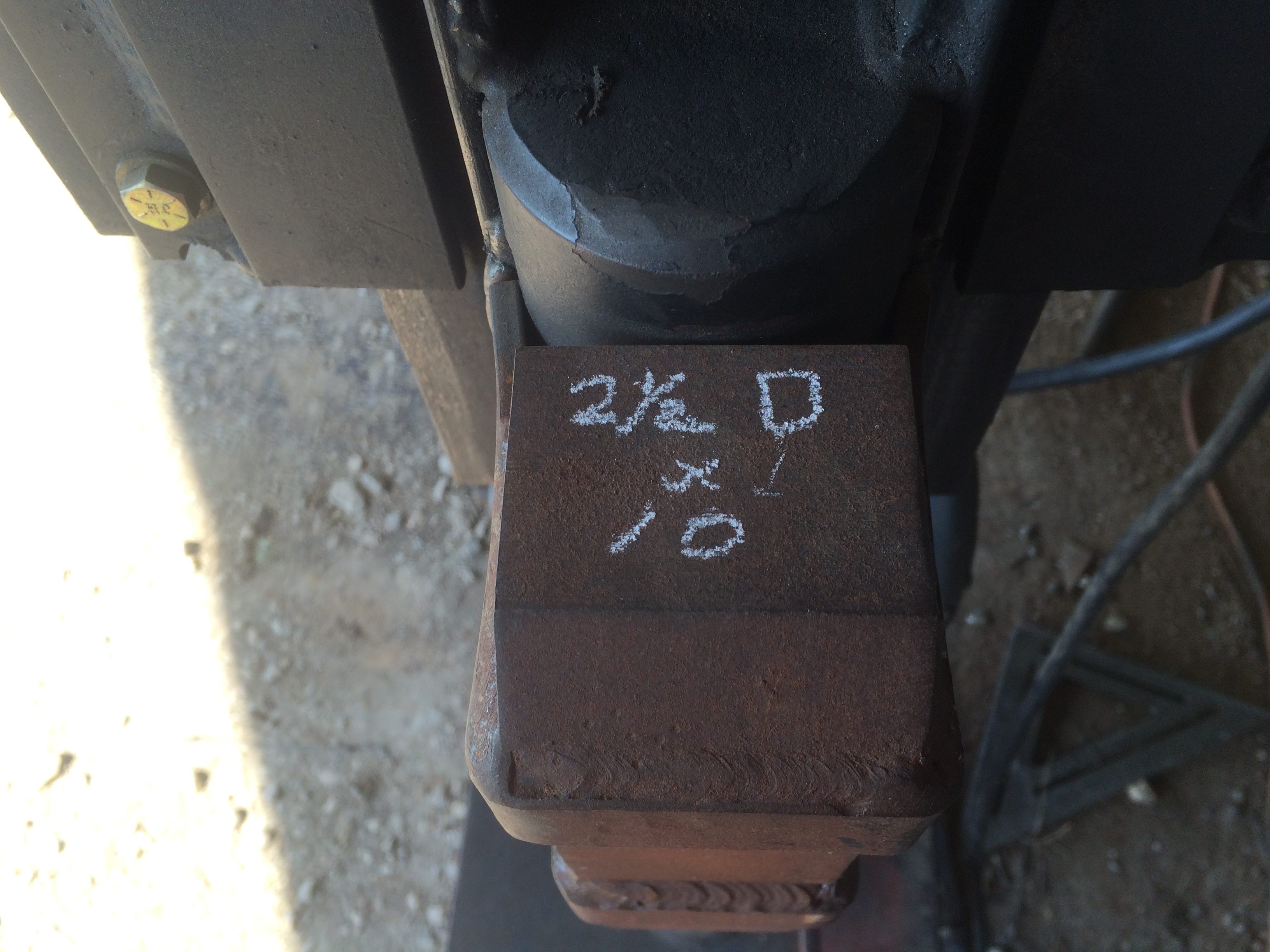

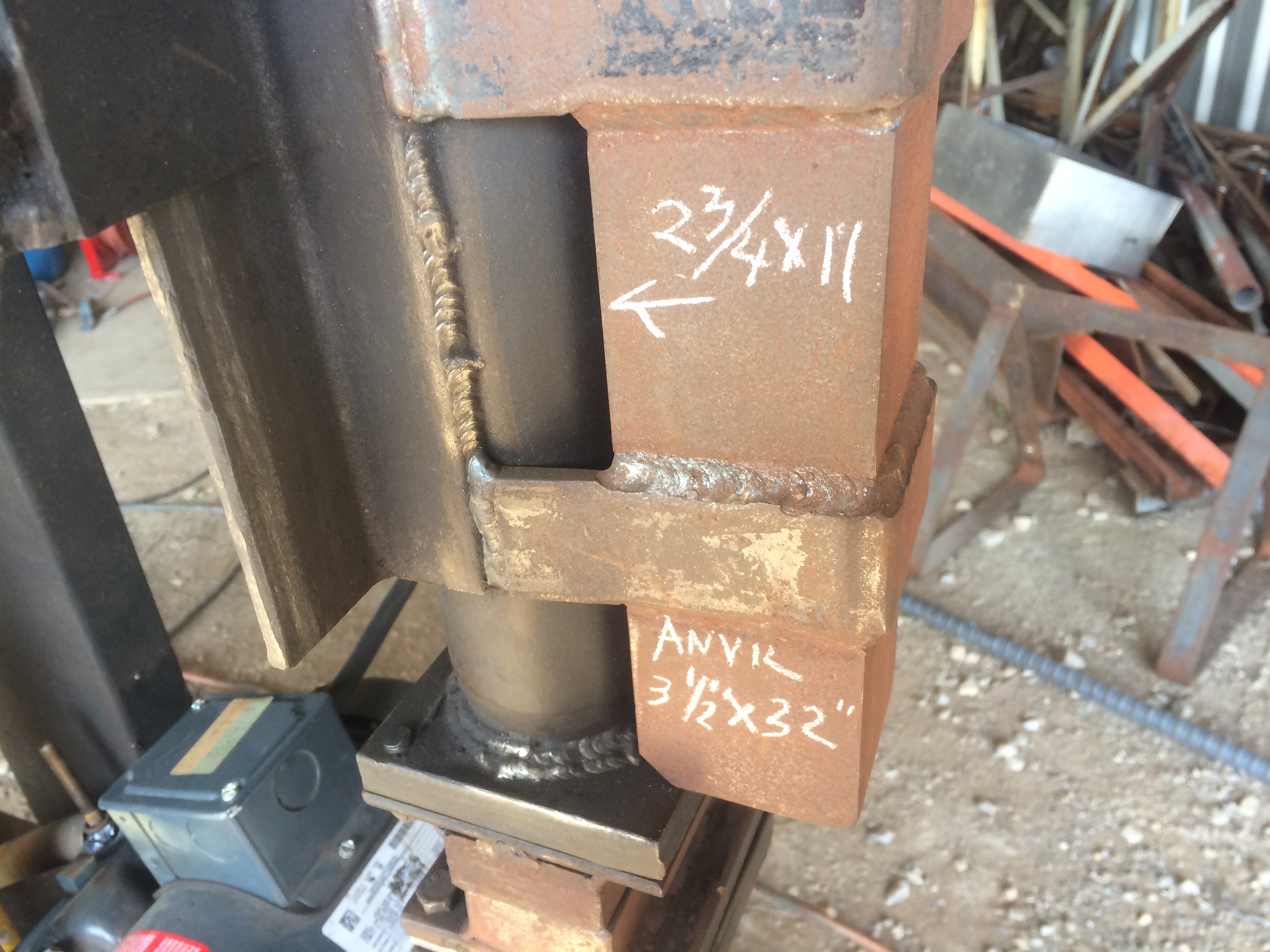

If you look at the hammer head on you will see that the anvil is welded to the channel and then another piece of the same material is welded in between the channel and the heavy angle base. There are two pieces of heavy wall tubing on each side of the anvil between the channel and the base, one on each side. The total of the anvil is 32" of 3 / 1/2" solid bar. I am going to pull the piece of round bar out between the channel and the new base plate on the frame. I will build a new section between the channel and the new base plate out of half inch plate. This will make the main beam solid from the new base plate to the hinge point at the top. I will remove the rear legs because they aren't needed with the modification. The main spring leaf is 1/4" X 2 1/2" X 38" and where the additional leaf contacts it there are Knicks in the main leaf. I see this as a problem. So Vaughn based upon your photos and what you said I understand that too much spring rate is better than not enough, right? I can order a new flat spring that is thicker and then add to the connecting rod so that the new spring will be straight when at rest, right? Thanks again for your patience. -

Thank you for your patience with me Vaughn. I'm in the autistic spectrum which means I am luckier than most people when it comes to figuring things out, I just have to convert it into my way of thinking to get it to sink in. The way I see it the anvil on this hammer weighs about 90 lb according to the calculator. The original hammer weighs about 18 1/2 lbs and the add on is about 17 3/4 lbs more total of 36 1/4 pounds, less than 1 to 2 in your formula. Using the 927 lb chunk of steel is out because it serves as down pressure on the box blade, works like a fire hose in a water fight with the kiddos for that. I have a great working relationship with two scrap yards. One of them will sell me bulk at $.10 lb so I can probably find a block or cylinder of solid that weighs about 400 lbs for the anvil, this is doable. If you can double check my math. Back in the day I was pretty good at it in my head but that was then and this is now, dyslexia is coming out of nowhere occasionally and I have to triple check the math and sometimes still come up with four different answers. -

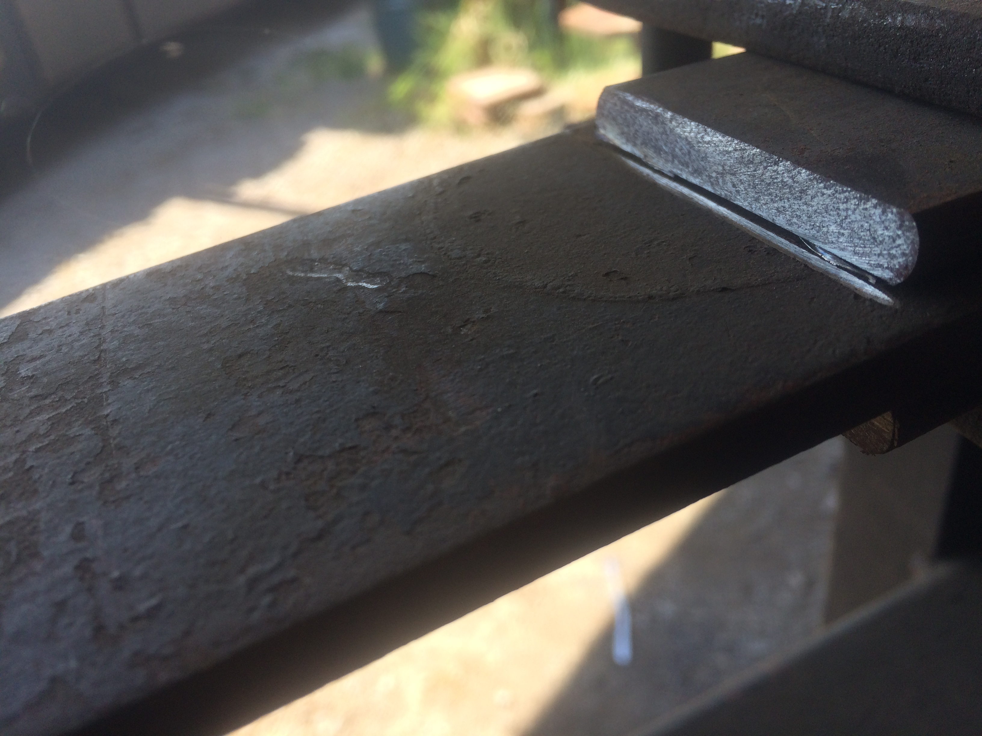

We picked up a couple of the Applachian style hammers the other day. Each one had some issues and I'm trying to work my way through one of issues on this one. It hits really hard and there is no way I can see to feather it for light hits. If you look at the head you will see they added some weight because they said it didn't hit hard enough. I'm thinking this might be the problem because it appears they almost doubled the head weight and didn't alter the spring to accommodate it. The spring has an arc when the head is resting on the anvil and the cam pin on the wheel is at TDC. The belt grabs the motor pulley when the motor is rocked forward. It's a very direct connection and I don't see where the use of an idler pulley system would change anything. This is the first experience with this kind of power hammer and any advice would be very much appreciated. I had a fifty pound Litlle Giant about twenty years ago but sold it because I didn't use it enough to justify having it. This hammer hits about the same from the get go as the LG did when asked to hit hard. I've got to finish the foot linkage assembly. I wanted to have a foot pedal that could be operated from about a range of 120 degrees. I also want the linkage to be tucked back out of the way so it won't be as easy to accidentally engage the hammer, I don't need a potato chip instead of a finger. In the next day or so I will do a video with it working on some hot bar so the learned here and have some information to work with. I appreciate the help and will have the phone with the camera and service available if someone needs photos to see details.

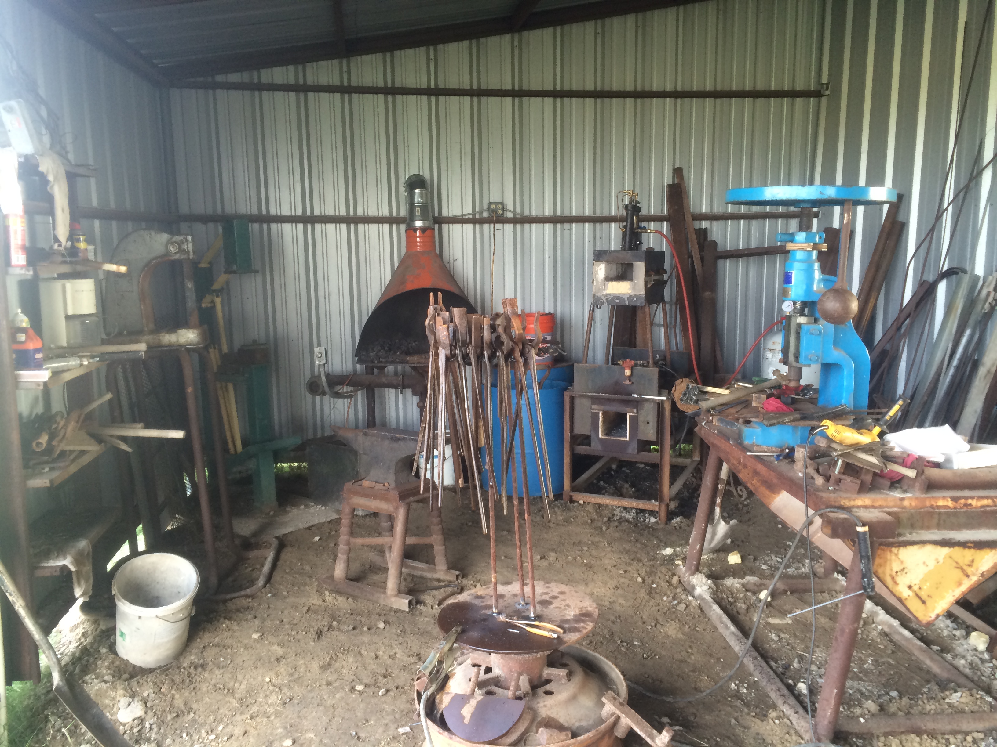

The table was picked up at an old Southwestern Bell surplus sell in Dallas for $250.00 if I remember right. It was a working pallet jack that moved up to ten thousand lb reels of telephone cable in the factory in St Louis. When I was done with making a cable reel trailer that was a self loader I had this chunk of iron left over. It became a catchall. Any flat surface 28" X 46" around me becomes a catchall. The deck was machined 1 1/2" plate with 1" X 2" bracing a hundred percent welded underneath. 800lbs of great table when things need to be shaped with hammers, leverage, and heat. It is the perfect base for the P-5 from Kane and Sons.
