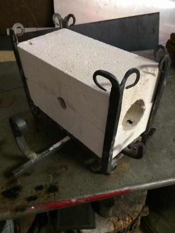

MonkeyForge Posted May 20, 2016 Share Posted May 20, 2016 This is my 1/2" T burner in Parts in the first picture, running in the third.The forge is around 90 cubic inches. @teenylittlemetalguy Do you have pictures of your T and did you use a reducing T? (I needed a reducing fitting from 3/4 to 1/.2, I flared the transition between the mixing tube and the fitting) It is not exactly a build along but more details can be found in the following thread where everybody has been a great help.Thread. Quote Link to comment Share on other sites More sharing options...

teenylittlemetalguy Posted May 20, 2016 Share Posted May 20, 2016 I did not use a reducer but people do it and it works. here is a picture of how I do it. I adapted mine to run on a flexible hose. I prefer my burners on the bottom pointing up or on the side so I don't have to worry about the supply getting hot. I am also attaching Frosty's instructions for anyone that missed it. T Burner Directions finished.pdf Quote Link to comment Share on other sites More sharing options...

Mbmul175 Posted May 24, 2016 Share Posted May 24, 2016 What are the inside dimensions of the forge ? What is your hourly gas consumption with this forge ? Quote Link to comment Share on other sites More sharing options...
teenylittlemetalguy Posted May 24, 2016 Share Posted May 24, 2016 45 minutes ago, Mbmul175 said: What are the inside dimensions of the forge ? What is your hourly gas consumption with this forge ? 2-1/8" hole saw is what I used to cut the bricks and make the interior. Hourly consumption? never bothered to calculate it. a small propane tank lasts a very long time. I have the .025" tip in there and typically run 2-5 lbs of pressure and 8 lbs for welding. Quote Link to comment Share on other sites More sharing options...
Mbmul175 Posted May 24, 2016 Share Posted May 24, 2016 Thanks, but how wide and deep is the interior ? Roughly ... Quote Link to comment Share on other sites More sharing options...
teenylittlemetalguy Posted May 24, 2016 Share Posted May 24, 2016 5 minutes ago, Mbmul175 said: Thanks, but how wide and deep is the interior ? Roughly ... It is a straight hole 2-1/8" wide and extends the entire length of the bricks (9") . With this style to run right it must be a pass through design otherwise it won't burn complete. I prop a brick near the back door but leave it slightly ajar to help keep the heat in. but it runs just as well with nothing covering the back opening. Quote Link to comment Share on other sites More sharing options...
